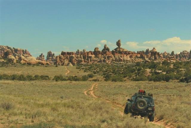

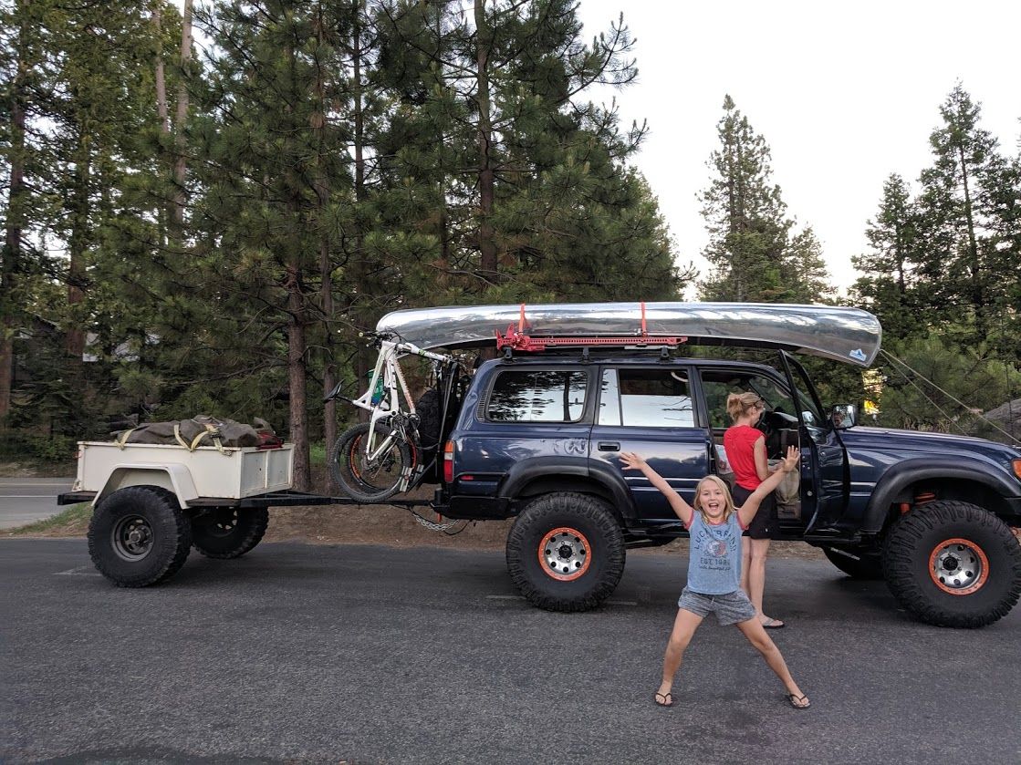

First off, I must say this thread has turned into more interesting discussion than I expected it to. I guess it's time I chimed in because a lot of the things that @Wrencher93 has listed as preferences are things that I share and have already set up in my 80.
I use my rig for wheeling on the Rubicon, camping with the family, long distance trips, hauling crap home from the hardware store, and often daily driver/commuter. Is it it ideal for each of these? No. But it works pretty well and there is not many major changes I would make.
Basic set up is:
New factory short block instead of a V8 swap.
6" Slee lift
37s with 4.88s and factory lockers
3.11 low range gears in the tcase
A small offroad trailer to haul camping and home improvement stuff.
Yes, it is sometimes slow on the long high altitude passes, but frankly I wouldn't need much more power. I set up the new block with Cometic gasket and ARP studs in case a Joey turbo is ever in my financial future. Otherwise I enjoy the scenery.
I think you can attain what you want in terms of reliability, wheeling ability, long distance travel, and family requirements by focusing on improvements that won't conflict too severely with other needs. Take your time, build it once and be happy with the outcome.

Sweet Reg, the 10% under drive gears would help a lot on those big hills. And the Trxus tires are one of the best out there!!!!!
