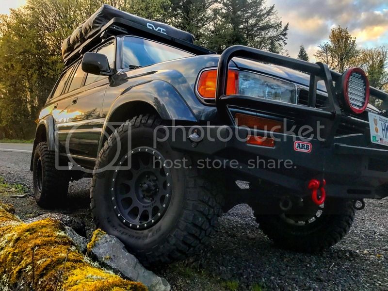

35"s!!!!!!!
It did rub slightly on the stock number, but no rubbing with the ARB. Edit: This is a really old thread. Oh well.

Very nice......which roof rack is that?
Frontrunner Slimeline 2 with expedition rails up front (so doesn't interfere with RTT) and I added a set of gutter mounts to handle more weight.
