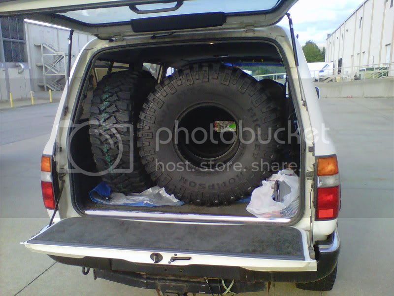

35 in MTZ's waiting to be mounted.

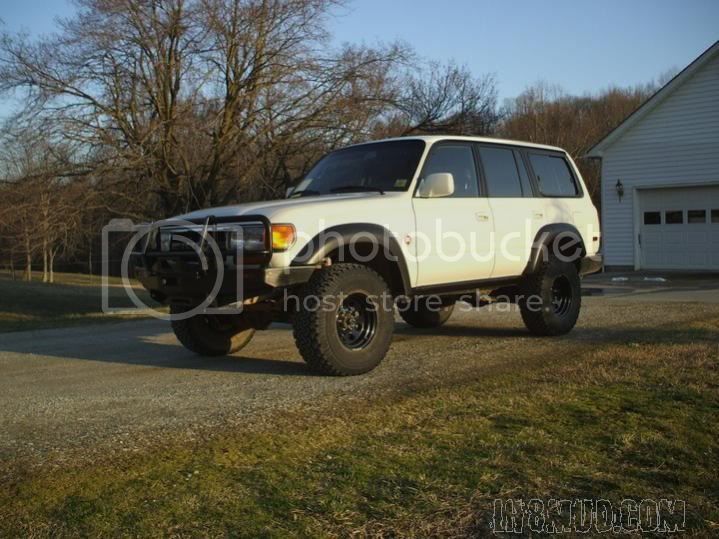

Ask and you shall receive. Finally got them mounted up last night. I will add that in the near future I am going to install a set of the 1.5 in Metal tech coil spacers up front to level her out a bit and give a little more clearance up front.
