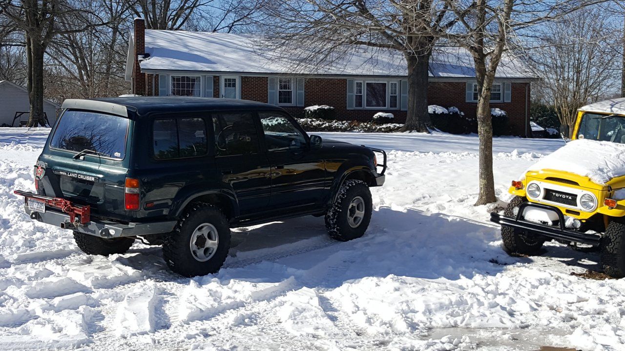

Road test .....
noise still there but (am I imagining this?) not as bad. Can't hear it in the cab. Oil pressure good, pulls well, revs well, and is suuuper balanced. Will do some daily driving this week and keep my ear focused forward. Will report back.
Thanks again to everyone!
