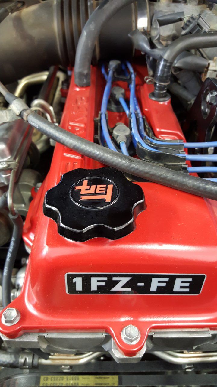

Oil change #1 today. Have not cut open the oil filter to investigate but it was a good time to put on a little flare de Beno.
Love it! Your reds appear to be a few shades off, try a different red crayon!
How about black for the "24 valve" raised letters?
