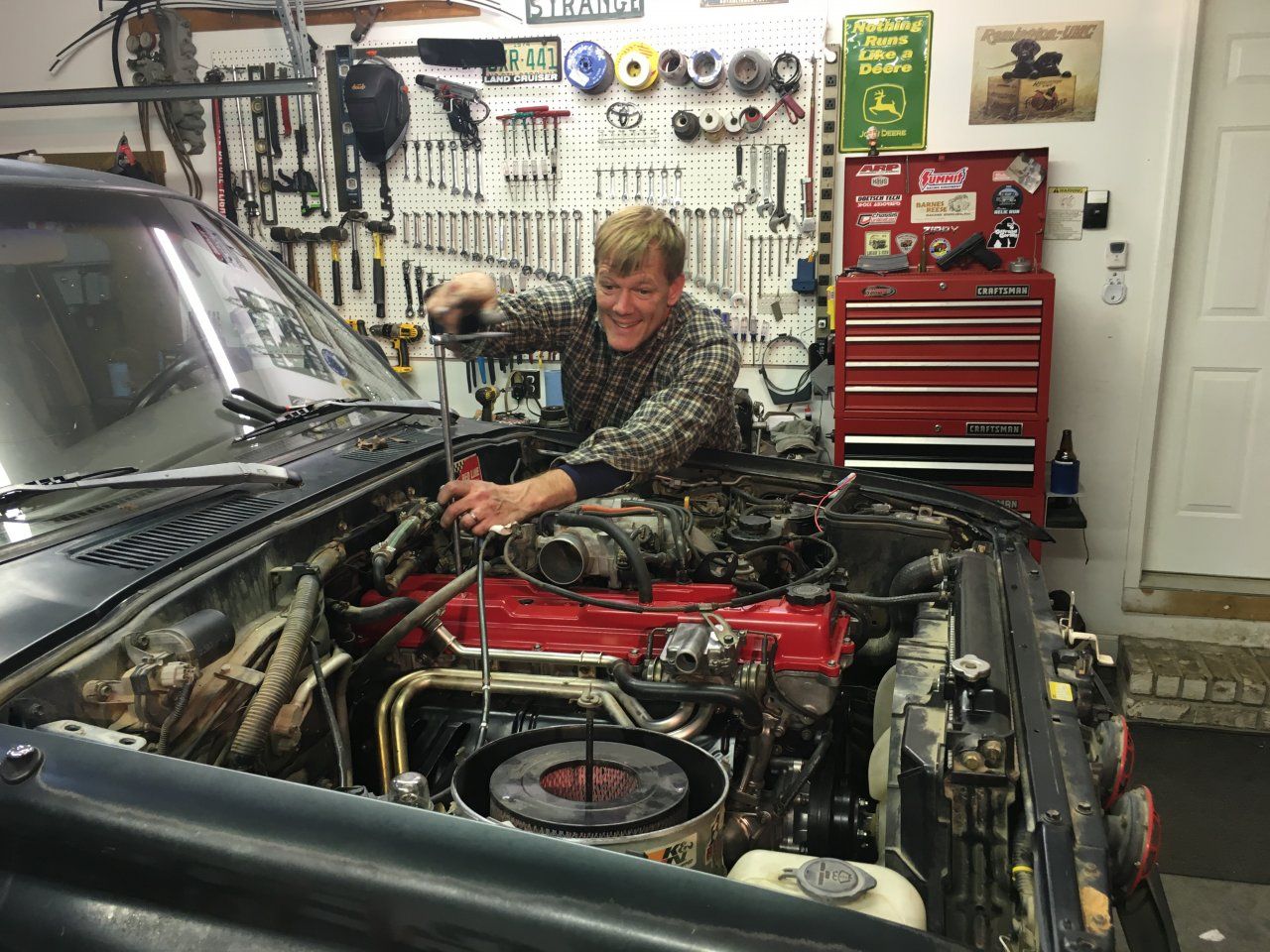

There were a surprising number of times (how many Jason?) the way to get something done was with a very long extension. In some cases over 3 feet. Put them on your wish list.
Here ... front starter bolt
Here ... hard to reach bellhousing bolt, coming at it from behind the TC.

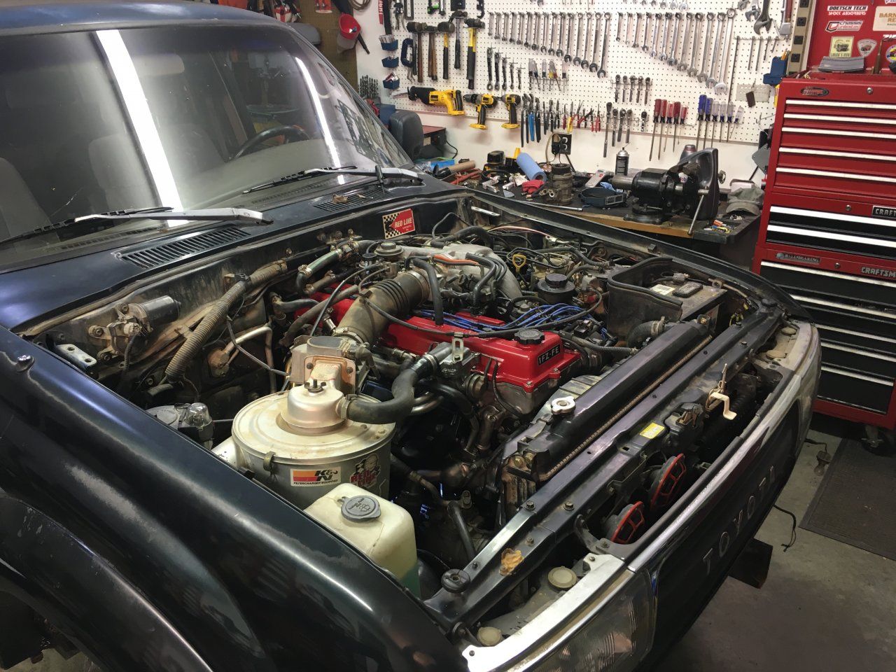

It all started with making room to work
And of course protecting the 'precious'

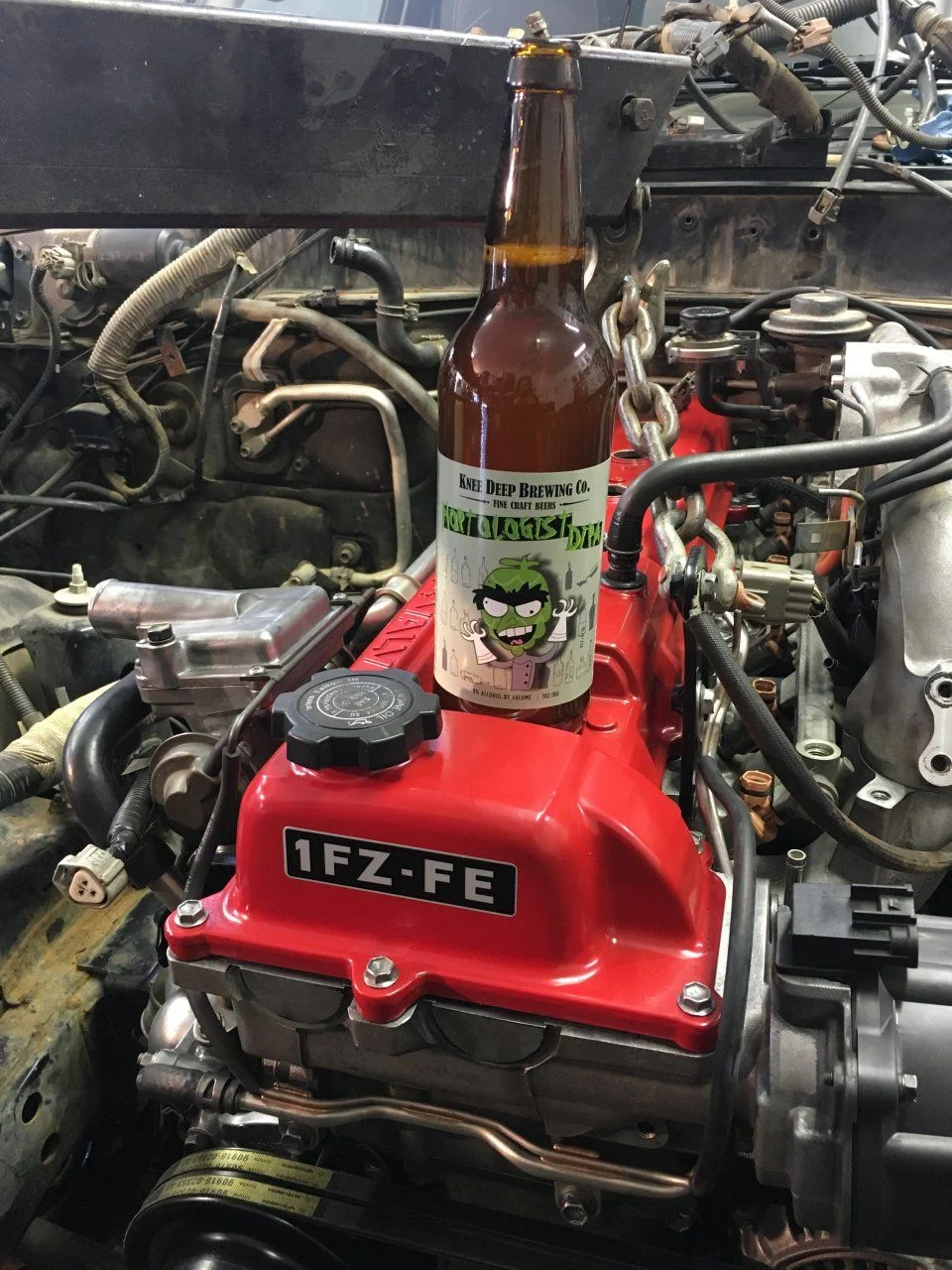

Holy poop that went fast.... its noon. Time for a beer.... and another repost
