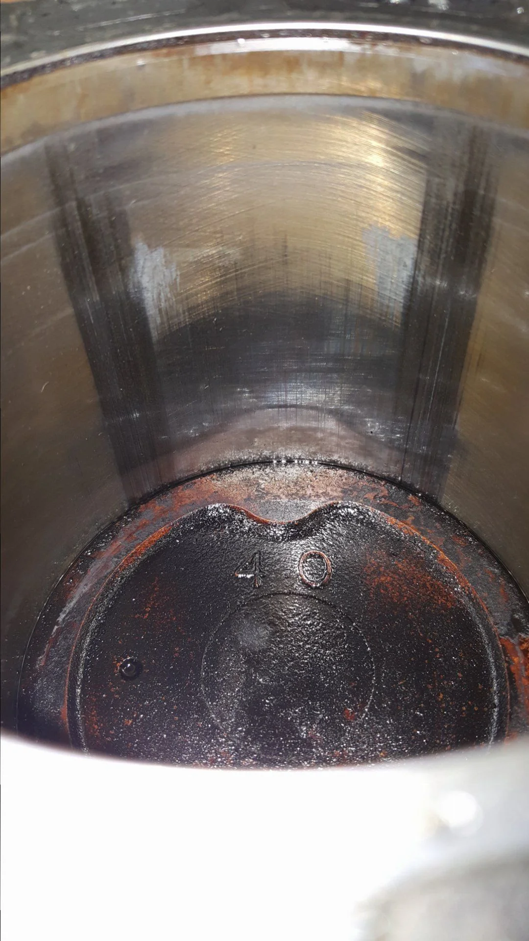

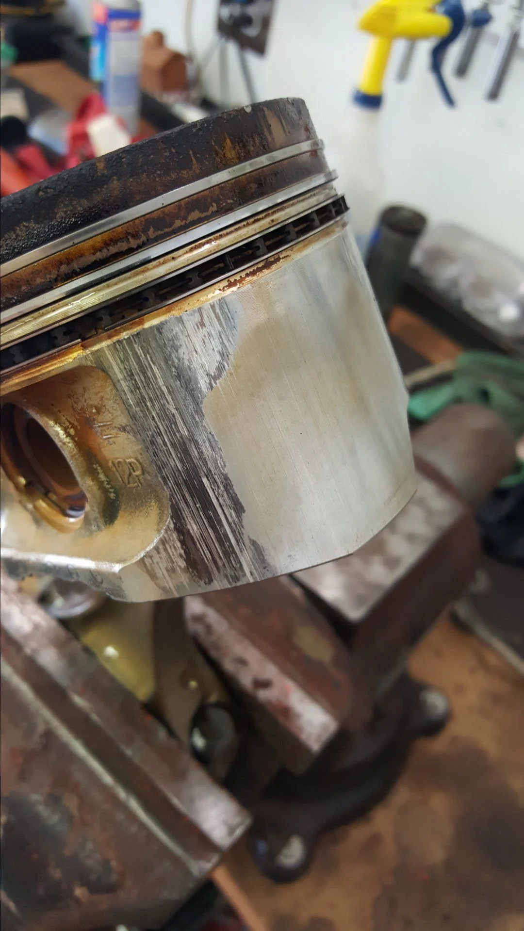

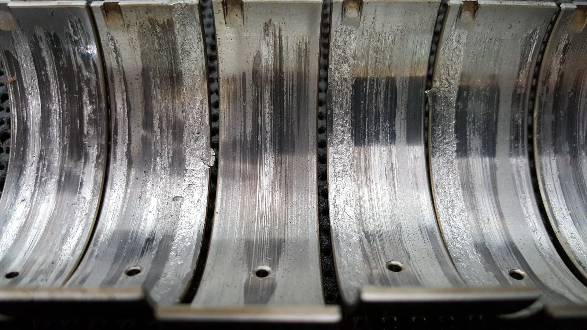

A little more on the forensics front causes me to believe that at some point this motor was starved of oil (collapsed filter?) .... the #5 piston was not the only victim .... rod and main bearings were rough.
All other pistons sit nicely in their bores with a skirt clearance of less than 0.002".
Then there was this guy ....
Bearings .... still holding very good oil pressure but were abused at some point.
It was quite an interesting teardown yesterday. cyl 5 was ugly, but even with all that damage, there was still wonderful crosshatching in thr bores.

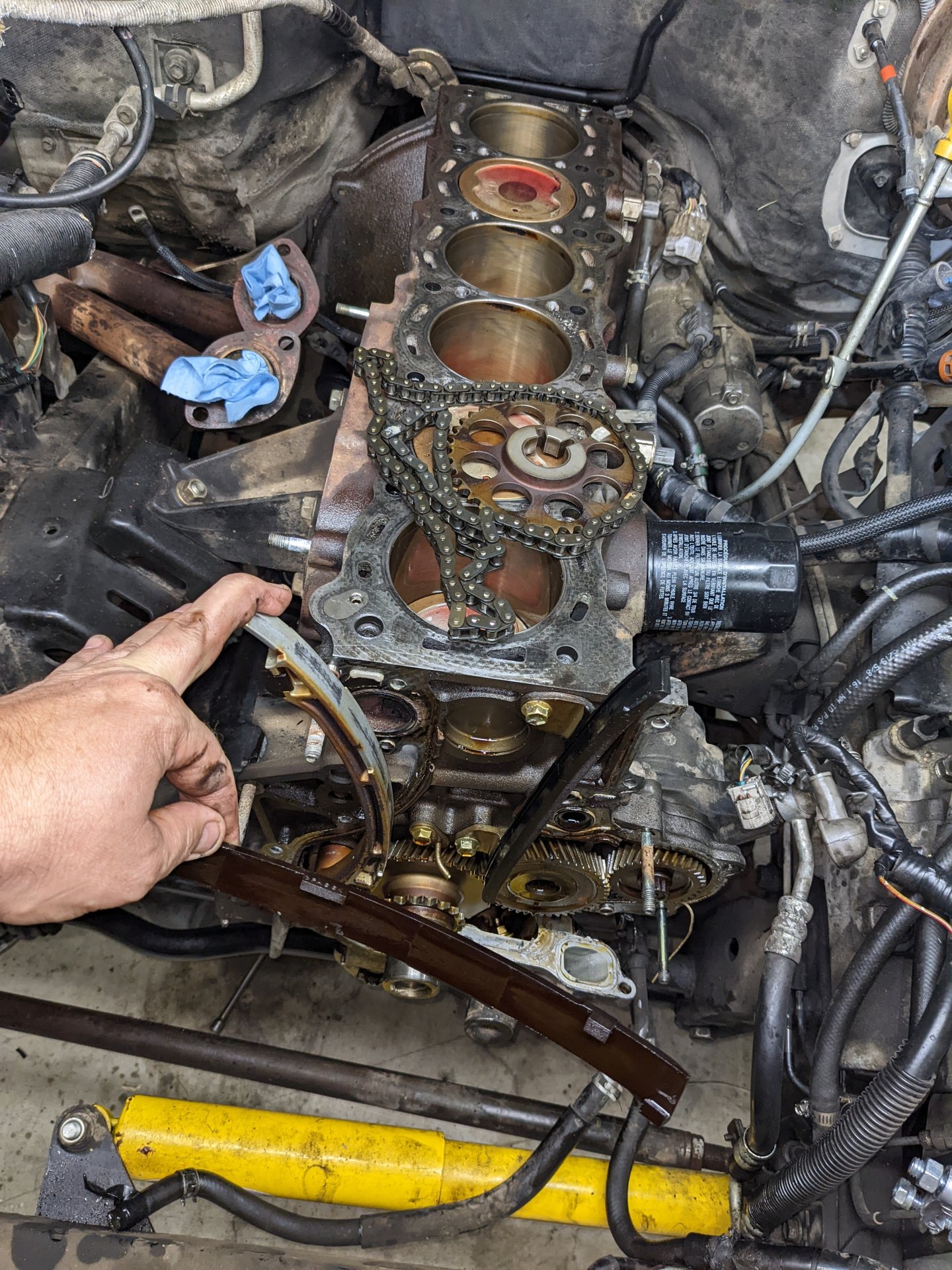

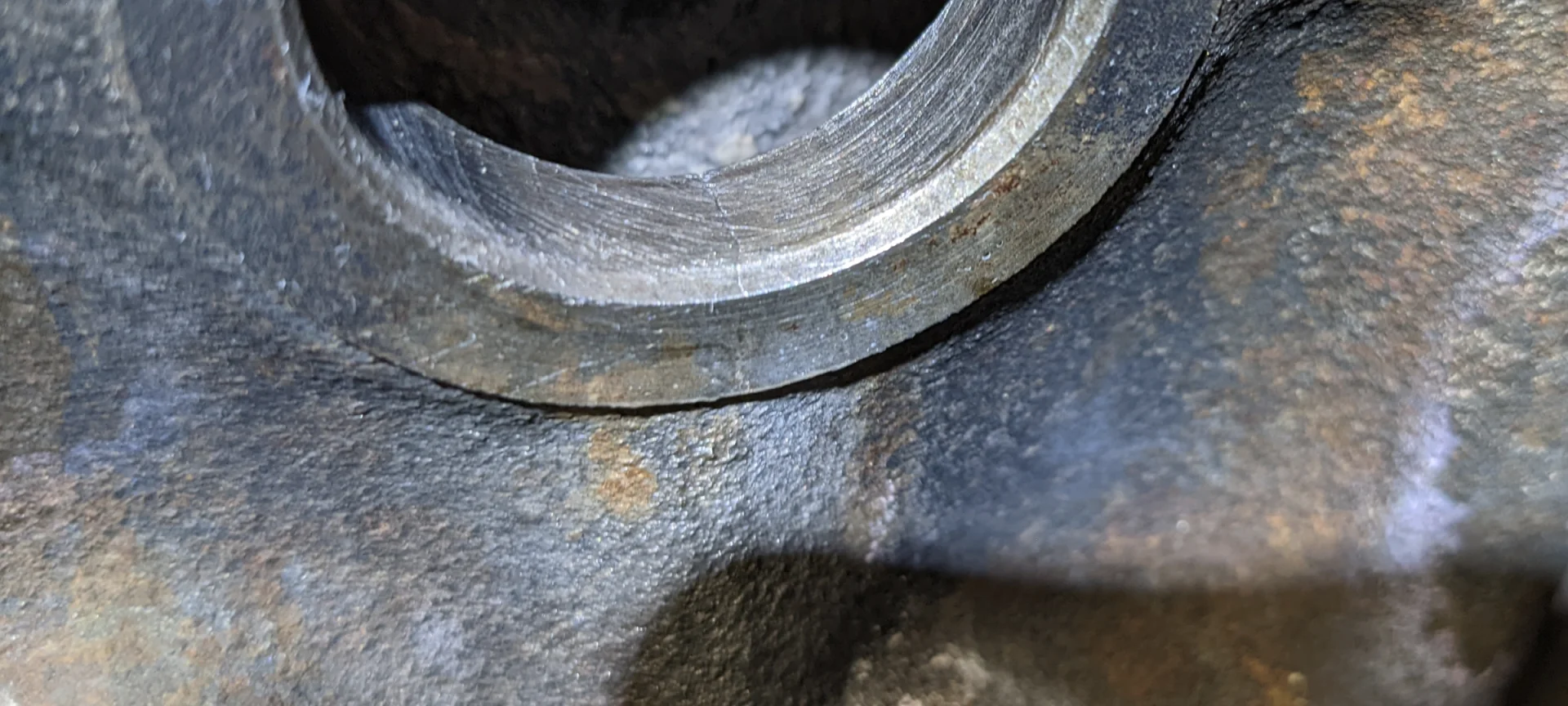

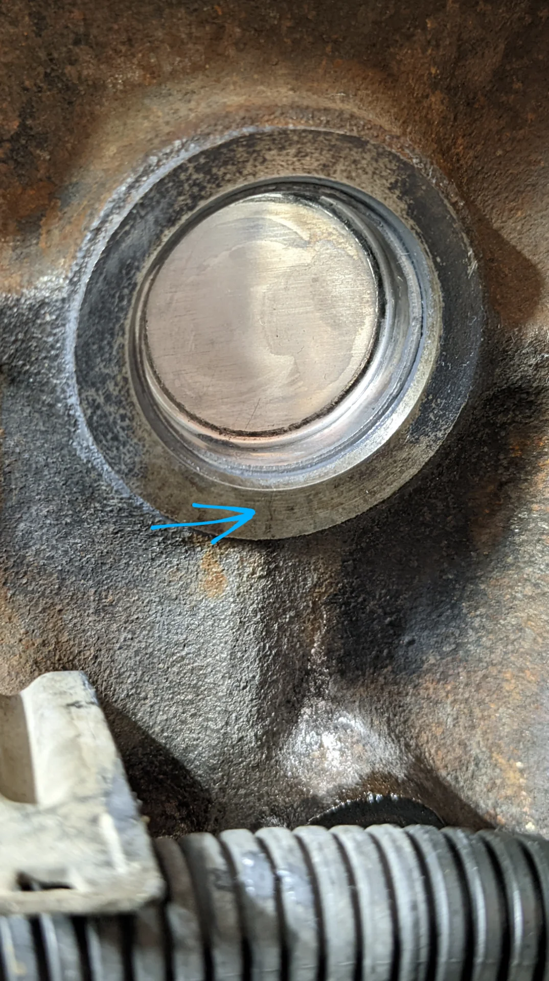

@Rice man I dig that coffee table. I'm stoked I found this thread, I also have a crack, a hairline crack below my freeze plug that's above the block drain I never noticed any coolant loss it just weeped a little I did clean everything up and JB welded for this head gasket job. Fingers crossed it holds or am I kidding myself? I was planning on getting a factory short block and starting to build a brand new engine over the course of about a year.
I have my 1fz torn down for the head gasket and had the head redone. I wasn't comfortable with the timing chain tensioner not feeling solid so I tore out the oil pans and the timing chain cover I'll be replacing everything with fresh Mr T parts.

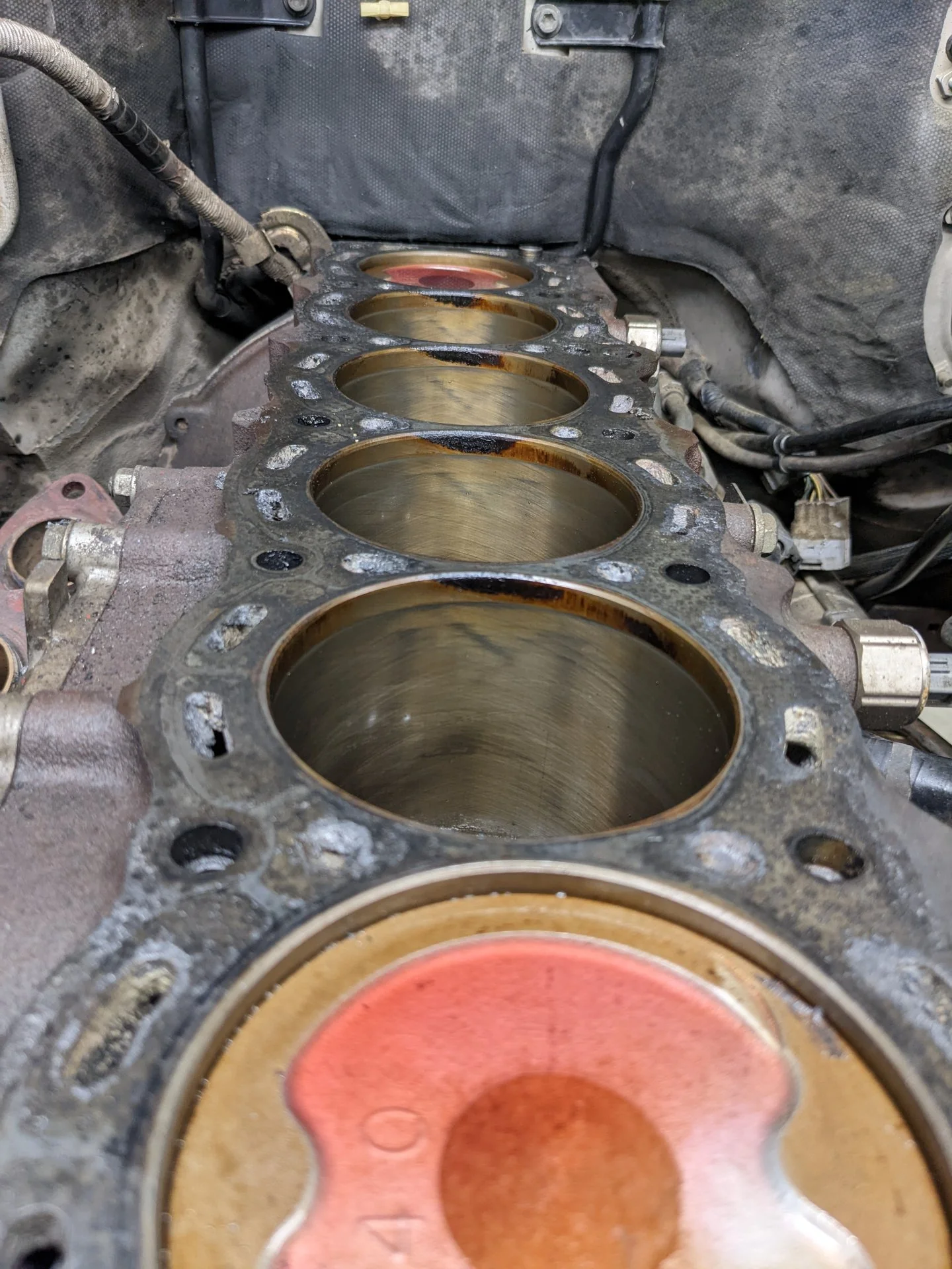

I'm asking because the block is still in the truck I'm considering pulling it for a full rebuild but before I tore it down compression was amazing and my black stone oil reports showed no bearing wear. I thought today at least pull a few rod and crank bearing caps and have a look.
To rebuild the bottom or not to be rebuild the bottom...... Where's the line for rebuilding the bottom end. Again I had fantastic compression and my Blackstone oil pork don't show any bearing wear.
Also I thought my cylinder walls looked fantastic photos attached.
I'm glad I followed my gut and pulled the timing chain cover because the fpig and o-rings were completely rotten I don't think they've ever been taken apart. At some point the upper oil pan have been off because someone used gray rtv that had basically turned to powder when I was removing the bolts.
My current plan is valve job new valve seals (complete), all Mr t all new timing components, Master head gasket kit, freshen up oil cooler, new radiator, new hoses, New belts, new factory wiring harness, ARP head studs, new plugs of course,
Injectors got redone about 5,000 miles ago so I won't send those back in for cleaning and balancing.
Every hose and clamp in the truck is new...... About a year old.
Thanks for the input
I did not have the milkshake or what I would consider classic head gasket symptoms so I made this video and I also plan on making a new mud thread once everything is solved.
