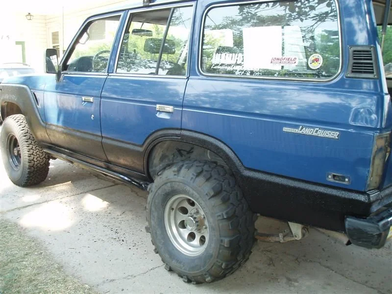

Rhino lining the body of a 60
Thanks guys. Im really happy with how the body came out.
The smooth durabak was way more of a pain than i expected though. I think you really need to spray the smooth because it hard to get a good finish with just a paintbrush and roller.
The textured durabak was really easy to apply with the foam roller and a paintbrush. I did three coats of the textured.
Before i put the grill back on i want to try to sand it and get a better finish. Still kinda undecided on how to attack this so i wont have a completely finished picture for a day or two.

and btw... im sooo stoked about how good the body looks! all day at work i kept looking out the window thinking how awesome it looks sitting across the street.

mine is the herculiner and it has been on for two years now. IF it gets a little faded I go over it with a couple of spray cans of truck bed liner from kragen or pep boys. It looks new again.

I really like that line, I think that is how I am going to finish mine after I cut the rear quarters.

Because I didn't want it to look like everyone else's. Preference too I guess. I like the way mine looks better verses going all the way up. It is a little too much.

I thought I said it in post #128. Herculiner and it has been on for two years (or longer) It holds up really well. It was really easy too. I taped everything off with the blue painters tape. Took some 80 grit sandpaper and ruffed up the work area. cleaned it with laquer thinner then started rolling it on. Then I took a few cans of the spray on bedliner, which gave it a nice even coat. hope that helps. do you need a closeup shot?
BTW thanks to those who said they liked it. It is always nerve racking trying something a little different. You are never sure how it is going to look or work it is all done.

A close up would be great. I to like they lines on your rig. The chips on mine go higher than that so I'll have to go a little higher.
