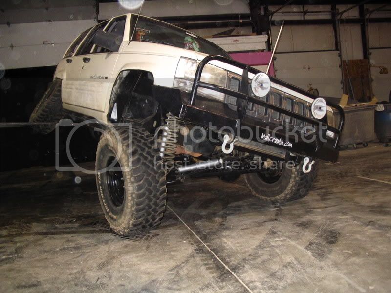

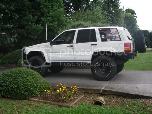

I don't know if its been mentioned but you can get Durabak bedliner in a variety of different colors. It pains me to put a picture of my Jeep on a Yota board, but heres an example.
It matched the paint almost perfectly.
Its kind of hard to see the texture but it is pretty consistent. I should have mixed it more as I was applying it though.
