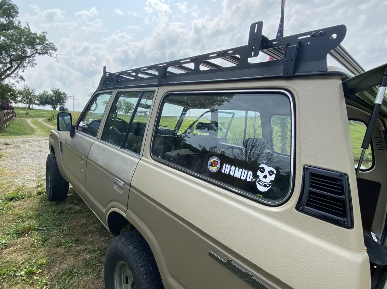

SUP MN DUDE! Can't believe this thread is still alive, I wen't ahead and painted the inside of the doors right up to the outside line. Here's another cruiser I've done with bedliner, enjoy :popcorn:
One issue I have run into is taping - masking off - the bed liner in order to add details, striping, etc. The textured stuff is very difficult to mask over. Tape doesn't adhere to it well at all and in the case of the textured finish, getting clean lines is ridiculous. Haven't figured out an idea yet that is optimal except maybe using a brush and proceeding very slowly. NOTE: I am not interested in drastically aesthetic results, just basic two tone.
