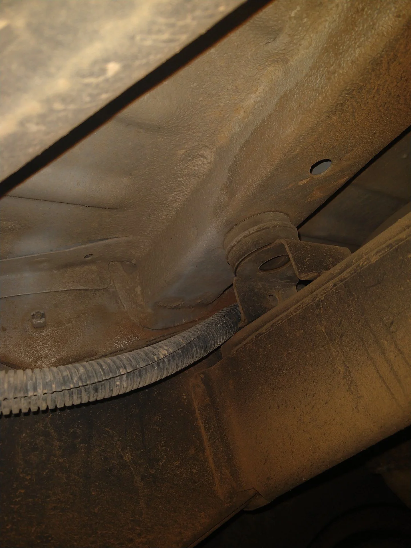

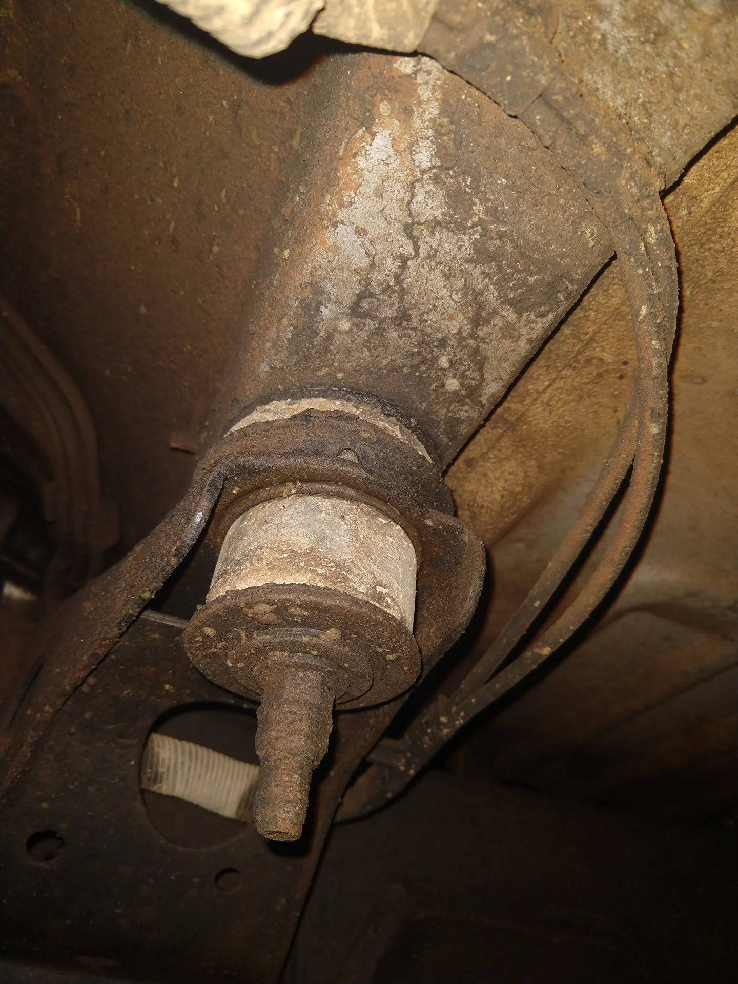

What makes you think there's a body lift? How about a pic of one of the body mounts?
Hahah, oh boy.... It's getting dark here but I snapped a couple.
What made me think there was a body lift? When I bought it the PO told me there was one. He wasn't much of a wheeler and had also bought the truck built mostly the way it is. I never checked (stupid, I know, but I fell in love with it). What makes me think there is one now? Um...nothing. I personally built my last rig (4th gen 4runner) but have never owned a Cruiser before this. Since I've owned it I mostly take it to a trusted mechanic due mostly to lack of a good work space. So I honestly haven't poked around too much underneath.
Here's a couple pics of the mounts. Doesn't look like a lift to me unless that rear bracket isn't factory.
After googling a bit it looks like the front is stock but the back bracket may be aftermarket? Presumably to level it out, perhaps? It sits almost perfectly on it's stance. Damn similar measurements for both the front and back hub-wheel.
Me either. By the current MUD wisdom you'd probably benefit from the lifted panhard bracket. If, of course, you think there's improvement to be had. Me, I've yet to be convinced, but the science is against me.
