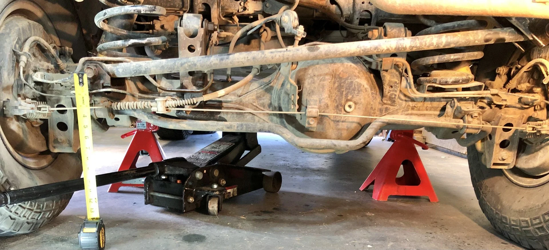

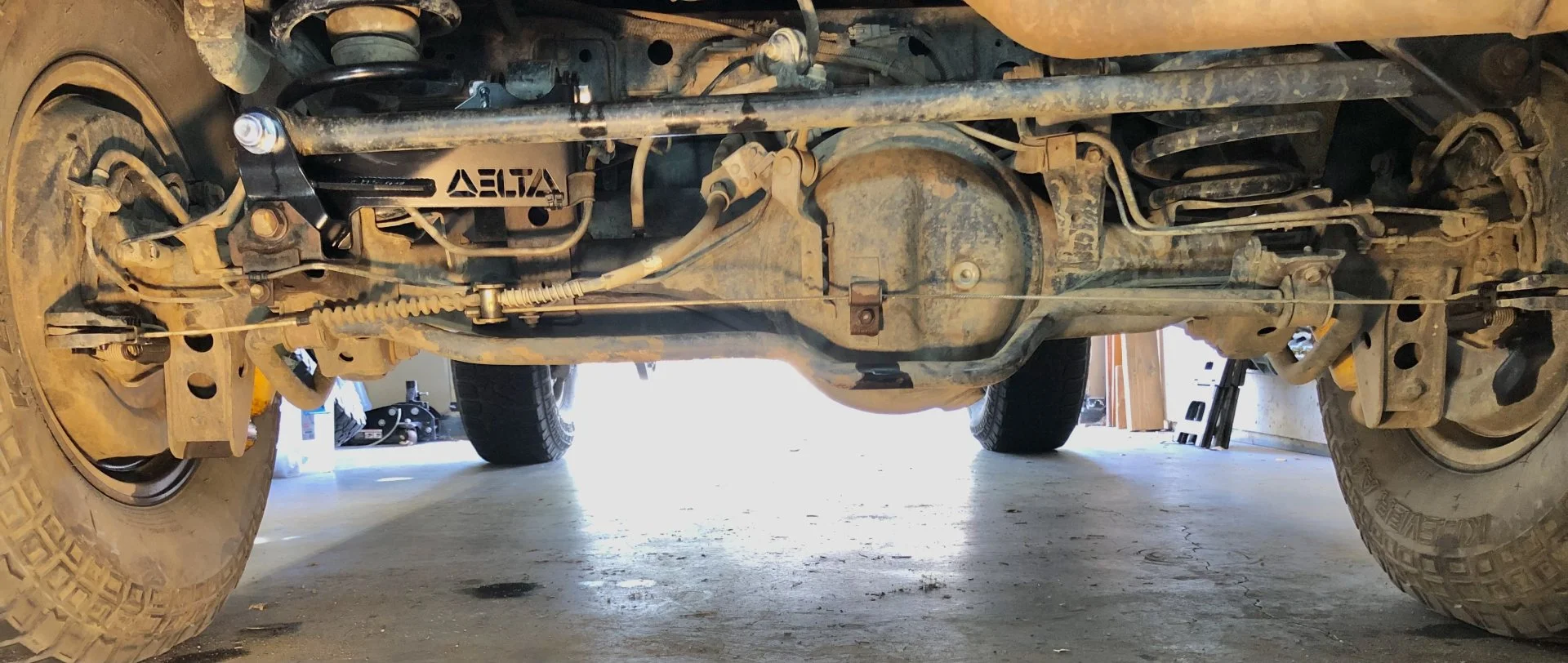

Since I already had the adjustable Panhard rear, I left it installed and adjusted to Center the rear after the panhard bracket installation, which I confirmed with a reputable alignment shop.

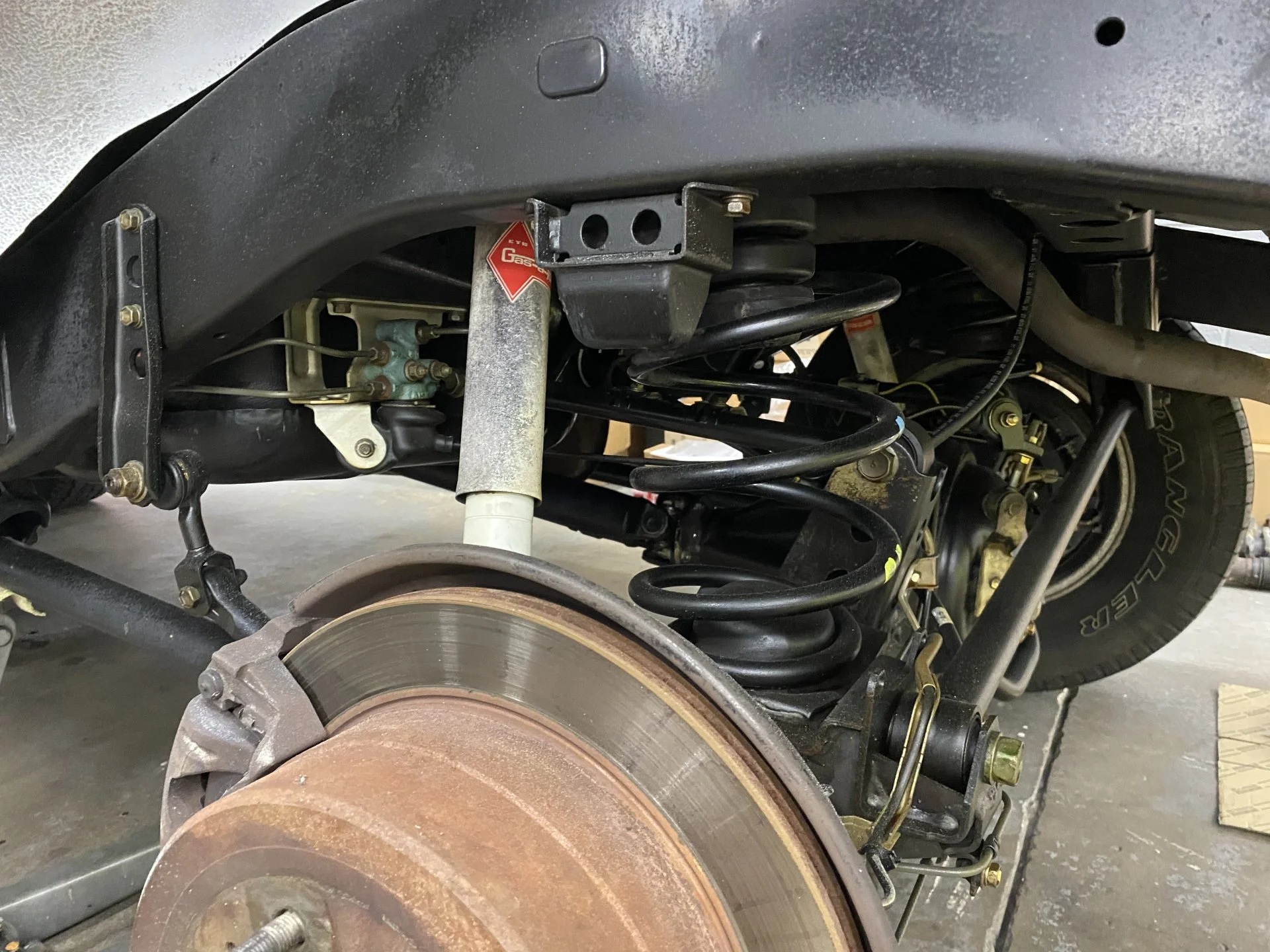

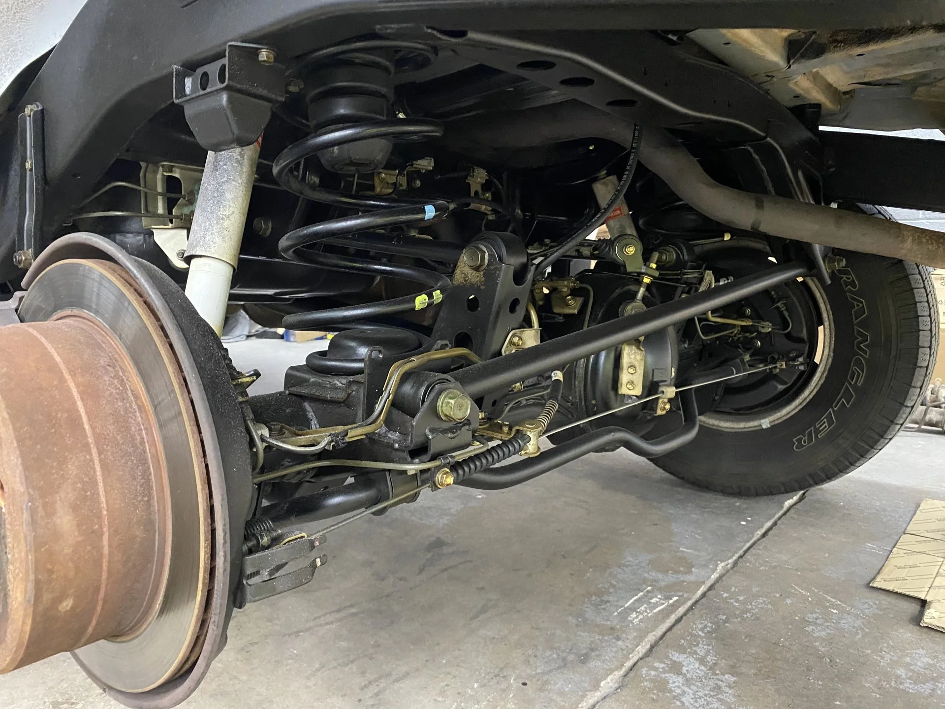

Like most, I ran into rear spring interference with the upper bolt. Would including an 80 MM bolt in the kit would remedy this? I am currently trying to source a slightly shorter 80mm bolt to find out if there is enough thread to properly lock or will go to the trouble of loosening the spring to turn it around like DVS suggests and has been done by others. My hesitation with switching bolt orientation was due to having the adj rear bar and first confirm rear end orientation/alignment and there was no bracket interference on the trail as 1 or 2 have experienced with the fatter springs, due to removal/adjustment creating an extra step to remove the spring again.

Just to be clear, there should be no need to go to the length of removing the spring to flip the bolt. If you pull the wheel, you can easily move the spring out of the way with a large enough lever. 80mm bolt is not long enough to get proper engagement in the nyloc.

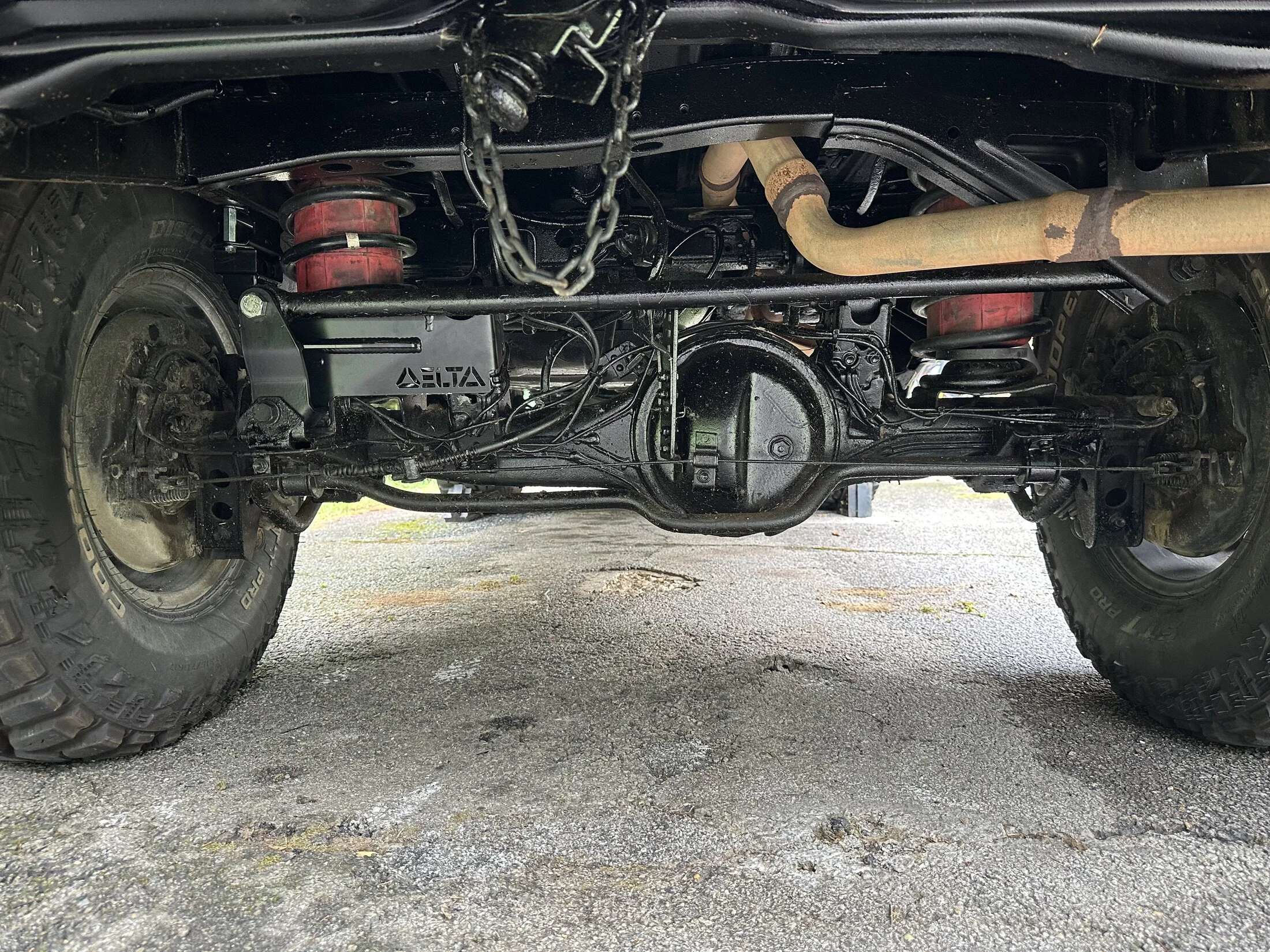

Next I need to see how LongCruiser is set up. Based on LongCruiser's wheelbase Dave said I would not feel the effect as much but I think there will be benefit from less induced side to side action, and it has a 6" lift.
Another happy customer here. Just installed the 5” bracket today for a 5” rear lift, initial impressions are great. Drives much more stable. Need to adjust my exhaust routing now though, contacts the panhard bar at rest.
