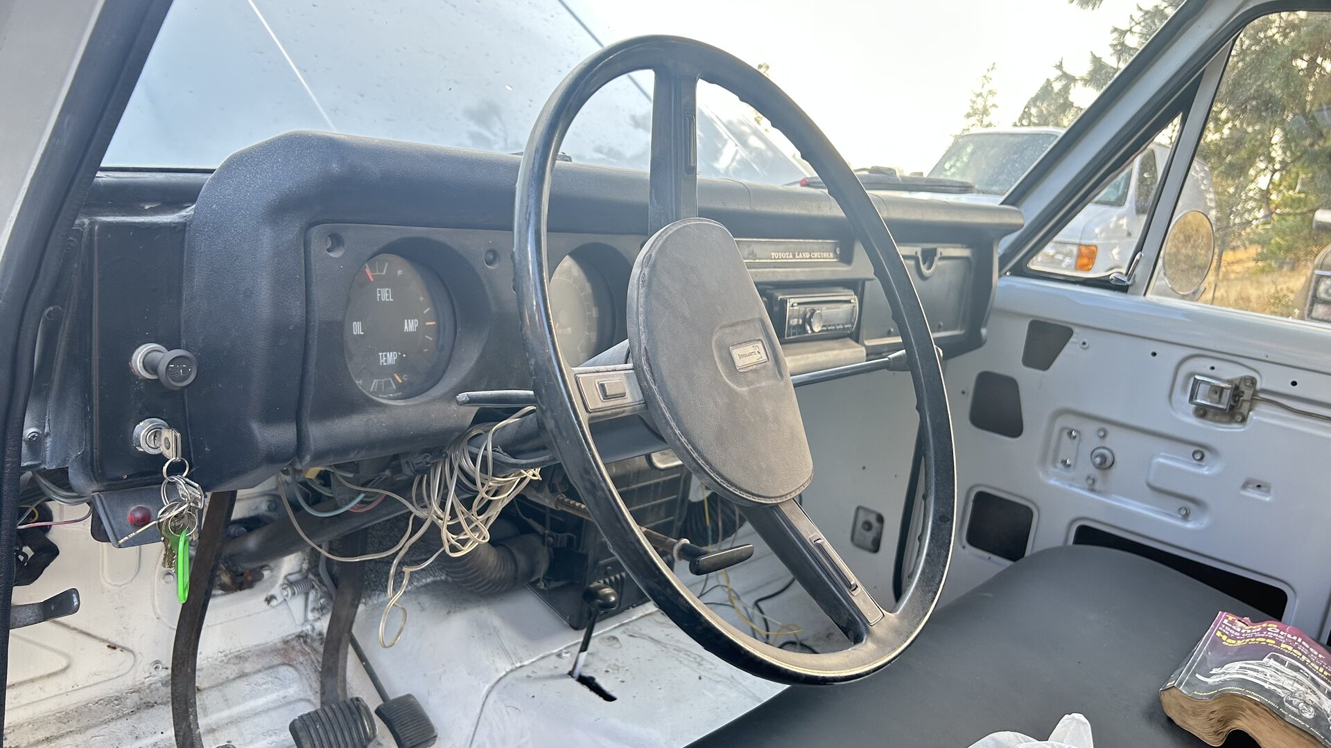

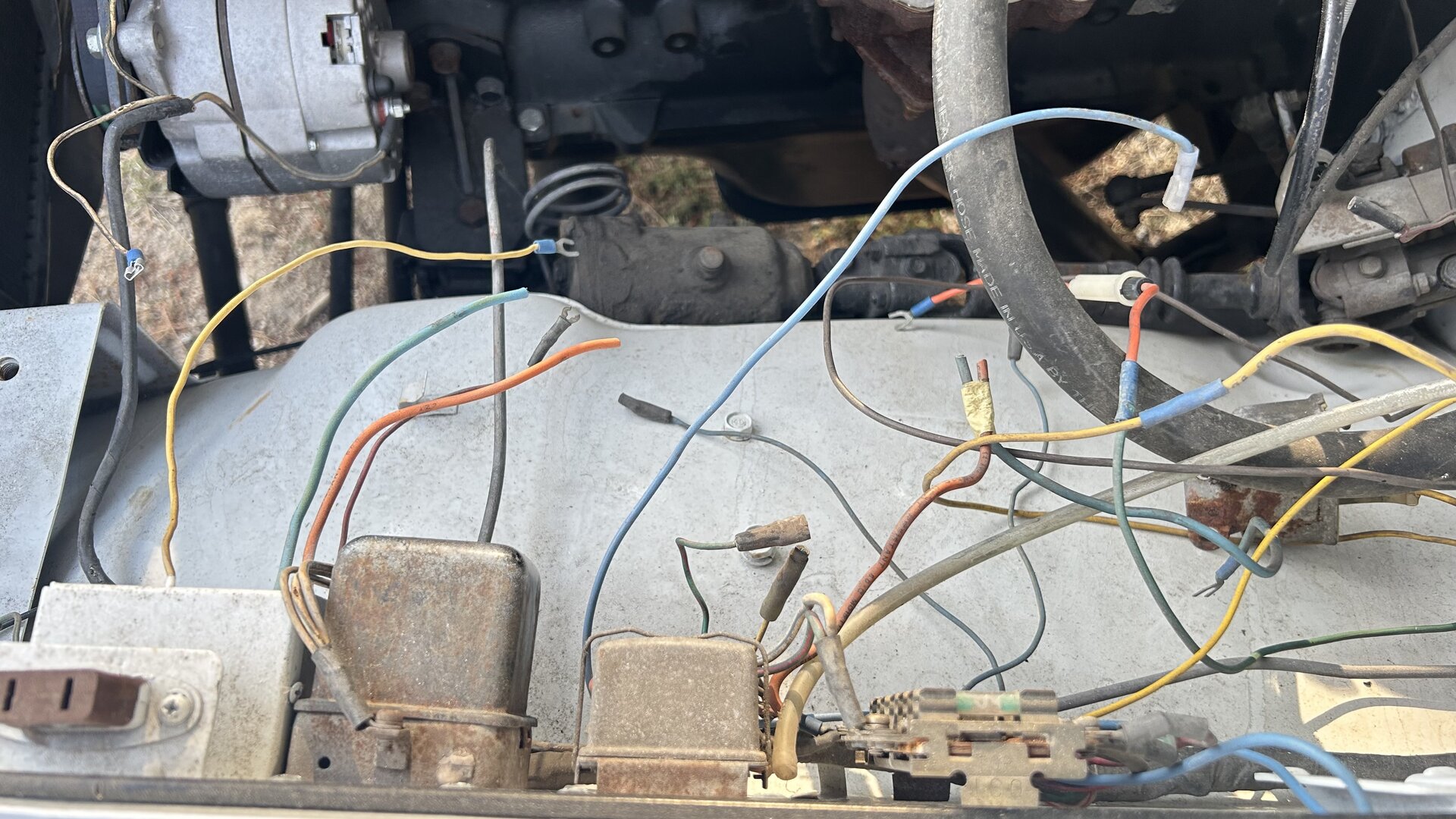

For the most part, wiring on an FJ55 is pretty simple. When the PO (previous owner/s) did the paint job and engine build, they probably got rid of a few things or changed things and didn’t take the time to tidy up. The wire wrapped around the steering column is a speaker wire and can be removed or rerouted to the speakers for that stereo someone installed.
My suggestion would be to get a manual, either factory service manual (FSM) that all the Toyota nerds are so in love with, or a Haynes manual (which I’ve used for 20 years) to help guide you through most maintenance you’ll encounter. If you’re not really setup to do your own work, then I’d suggest finding a local mechanic (preferably a Landcruiser enthusiast).

If you like reading wiring diagrams, you can figure out a lot of things yourself.
If not, find a good automotive electrical shop.

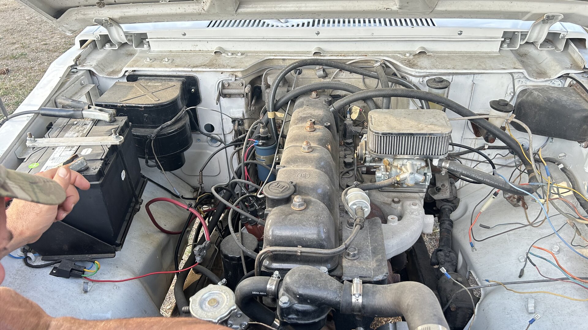

Test battery and alternator before ya do anything. Voltage regulators are'nt that expensive either. 🤔🙂pics,pics,pics 😉.
Word.
A battery that has been abused may not be capable of holding a charge any longer.
An alternator w/ a bad diode array can discharge a battery.
The fact that some of those wires are disconnected does not inspire confidence that things are connected correctly.

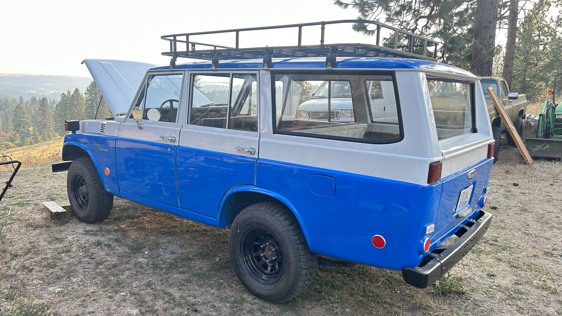

Do you know what front end you have? If the engine has been swapped, there is a chance you may not have the original front end any longer.
Question - what about the grille? Do you have the marker lights built into the front grille? That was only found on '68 and '69 Pigs only.
