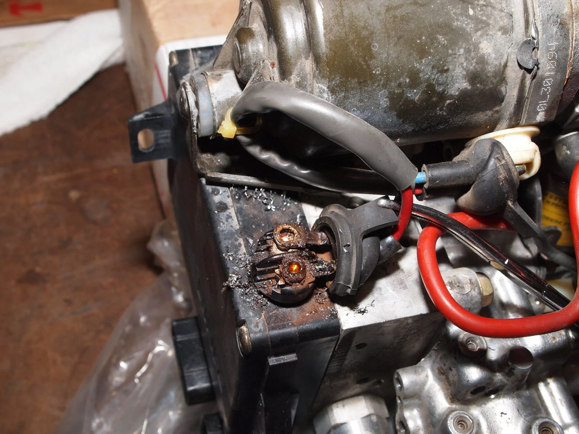

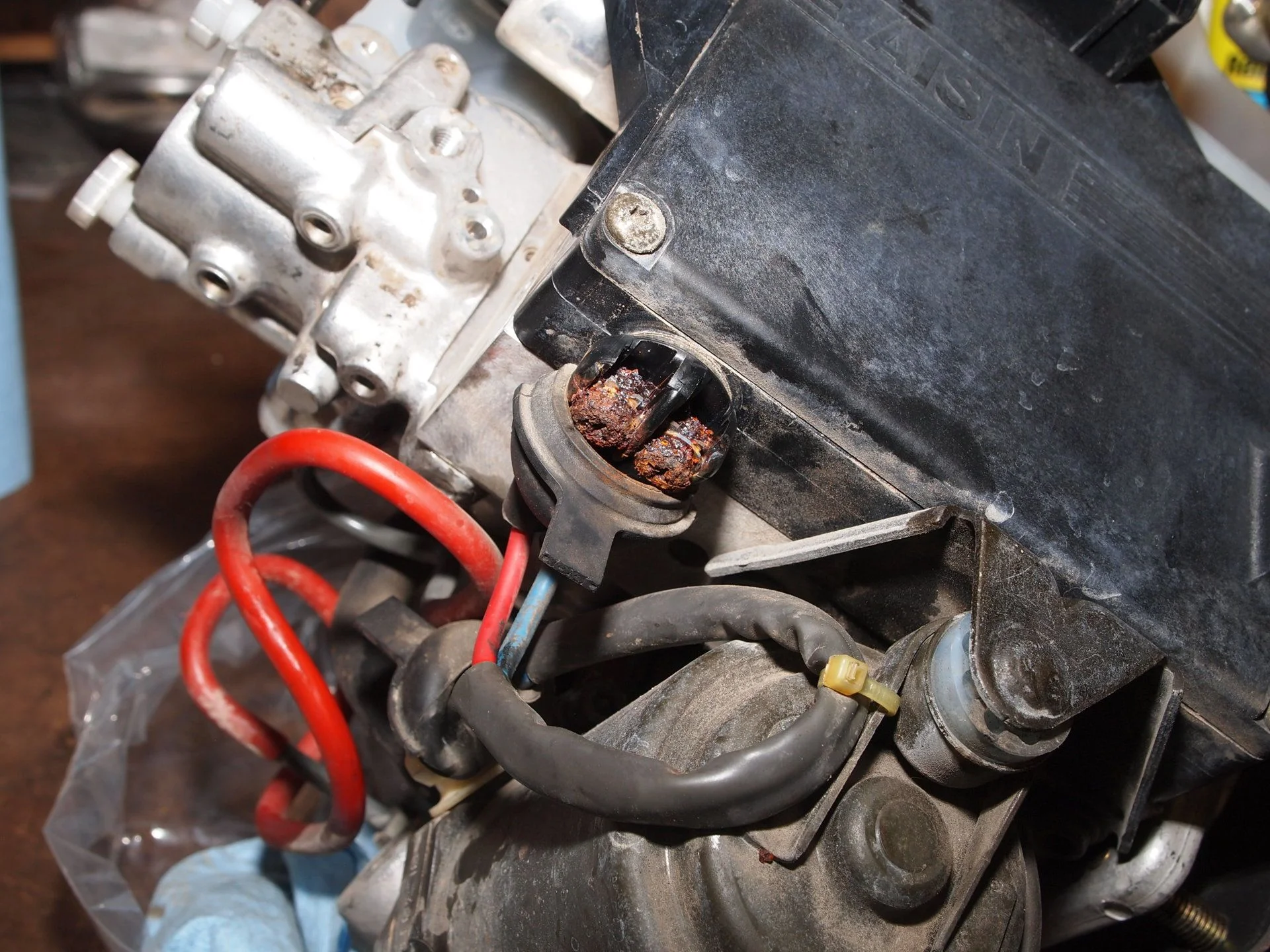

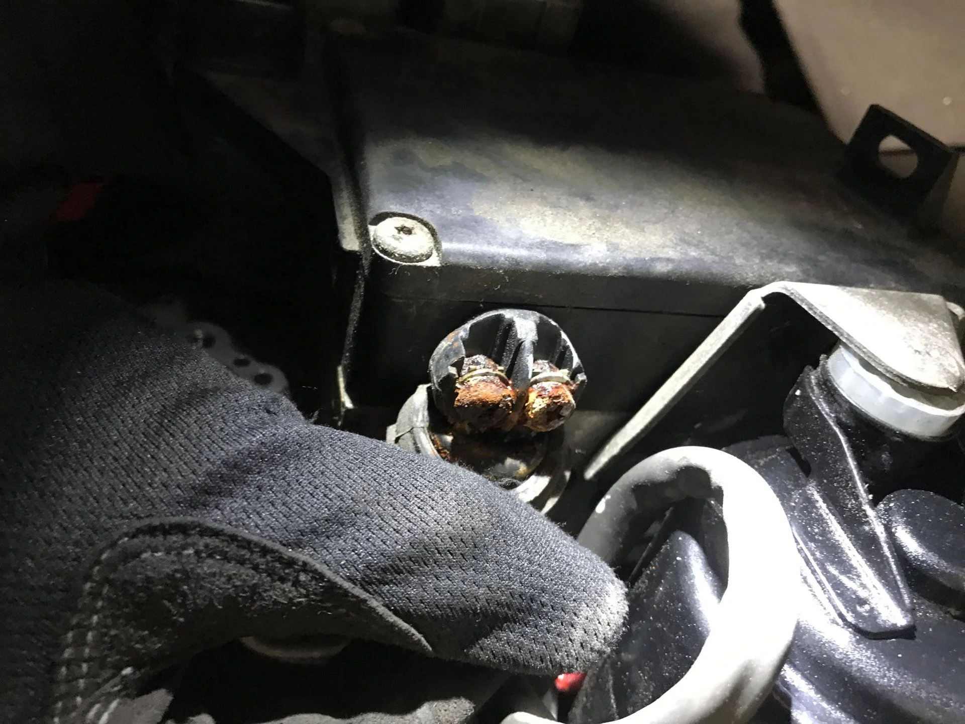

I do one inspection that is different and new. At your miles very important.
I look at wire from bottom of ABS unit on side of brake master (black plastic box). Wires run to brake booster motor. Both ends have a boot. Peel back boot and inspect for corrosion on nut's, screws and wires. If found, I now suggest wire be replaced with new OEM from Toyota. If this found corroded, booster motor should also be pulled apart and brushes and commutator then inspected or just replaced.
