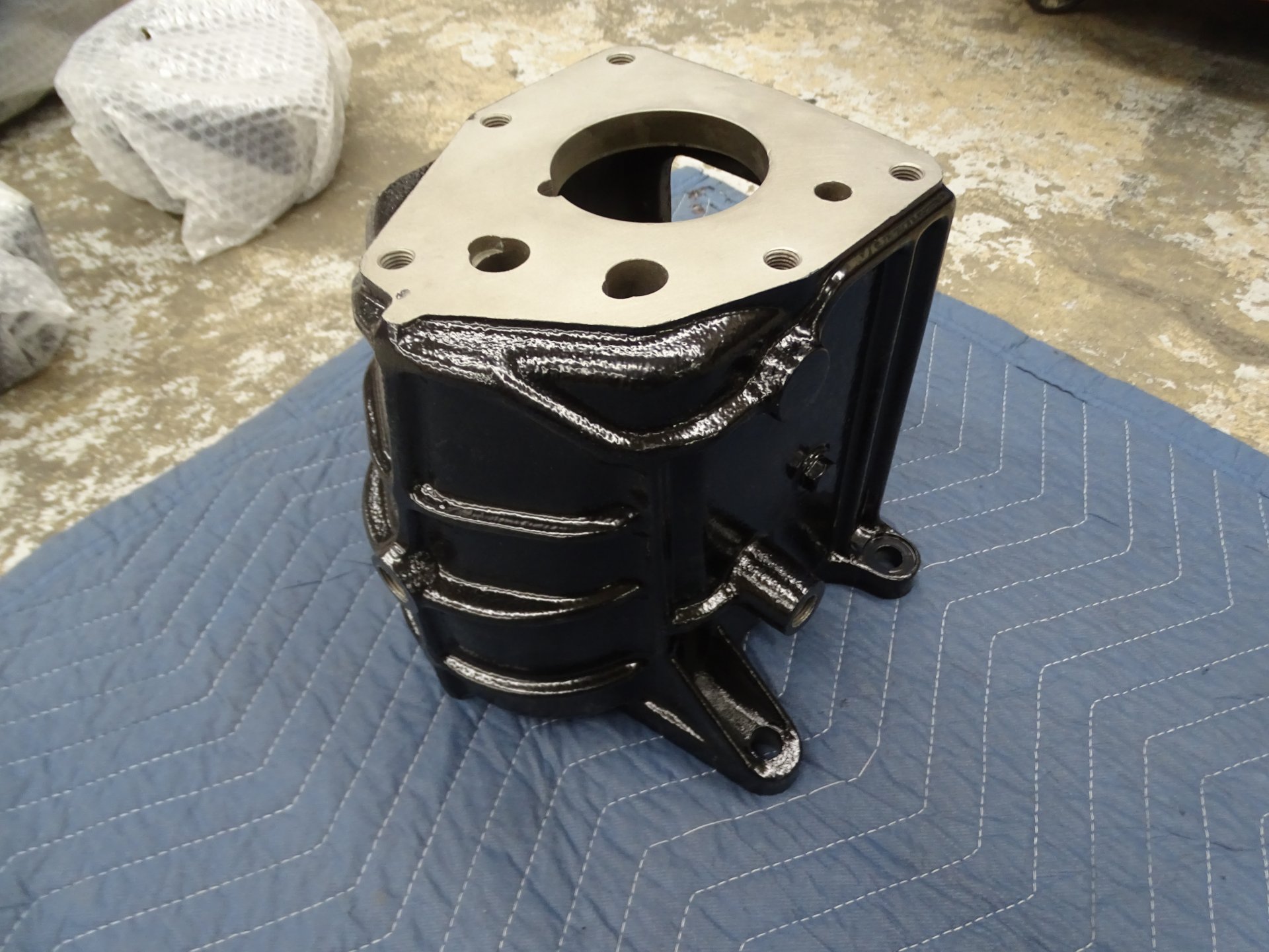

Random drivetrain parts coming back from Lee over at pristine Powder coating in denver! He does a great job, and he is a cruiser owner! So if anyone is in need of PC in Denver....
We semi flat cleared PC'd the t-case parts, and the black is a 50% Gloss "Chassis black"
Can anyone guess what's wrong with 2 items in this batch? I shook my head when I noticed... Being a professional and making mistakes is apart of the deal sometimes!
Going to go with shifter top plate is aluminum , and knuckle ball ends look like they got blasted?
Correct on the trans top plate, Its supposed to be clear PC, Not black.
The second would be...we somehow sent 2 Right side steering knuckles...:deadhorse:

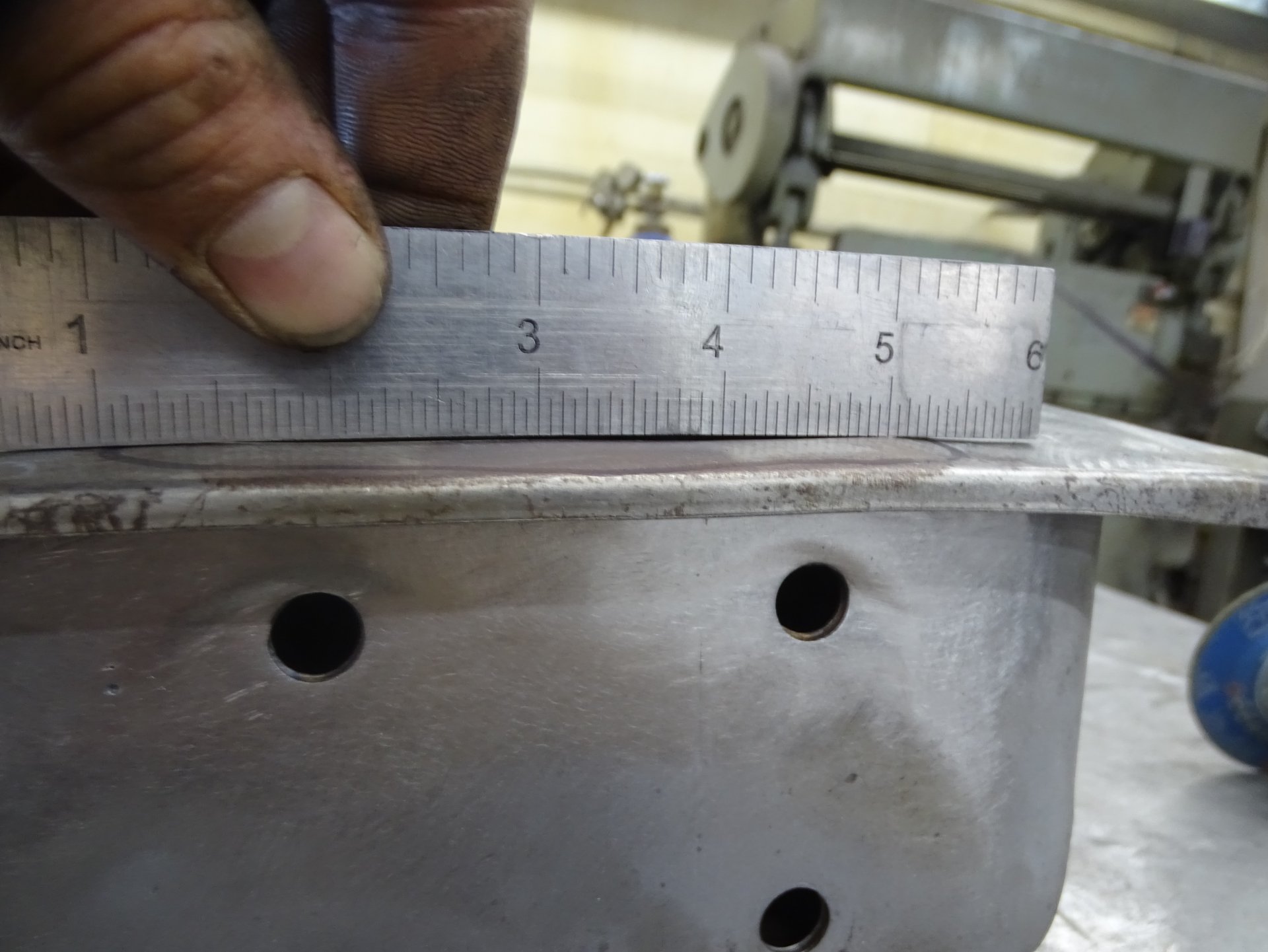

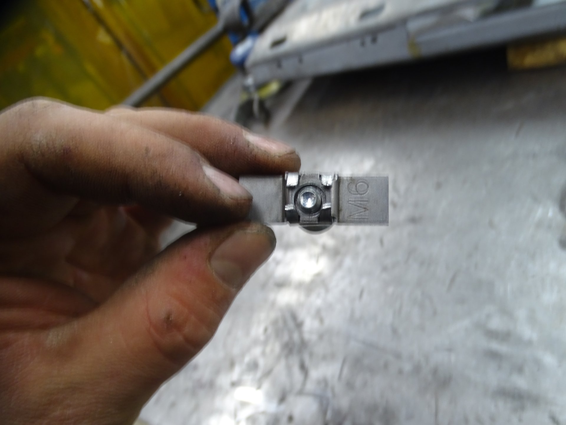

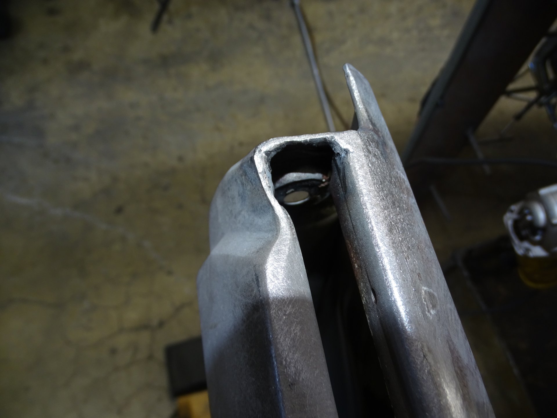

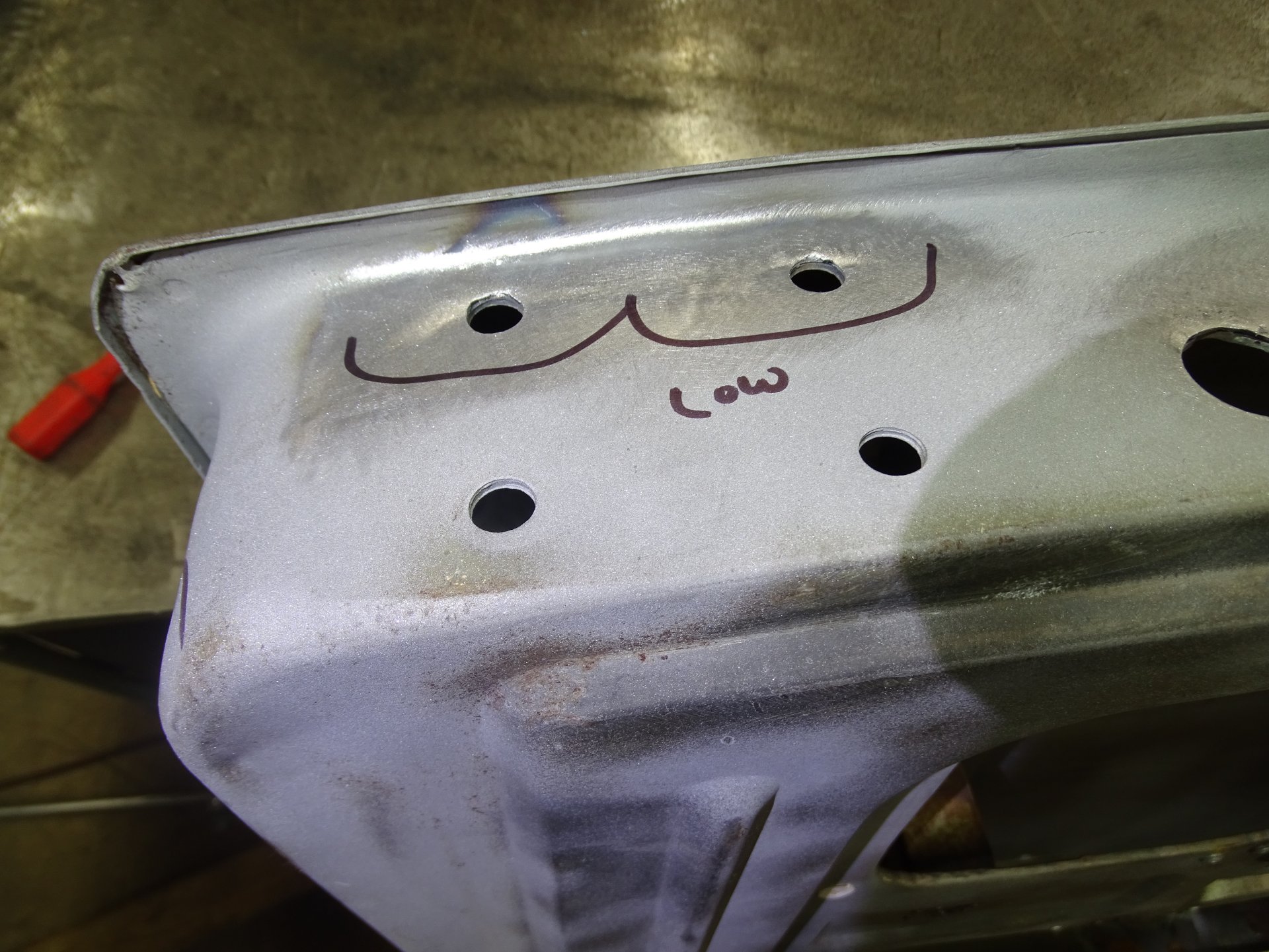

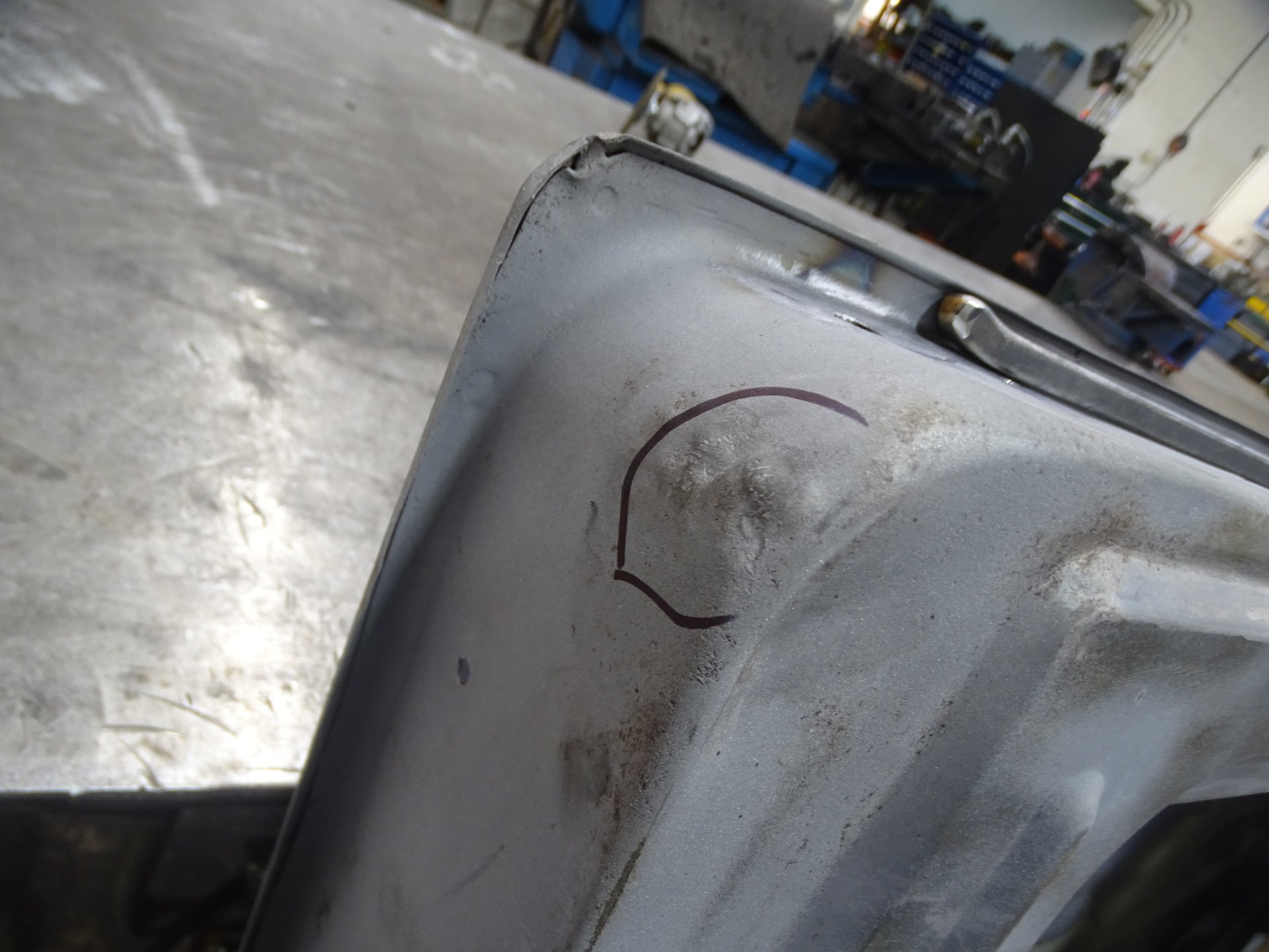

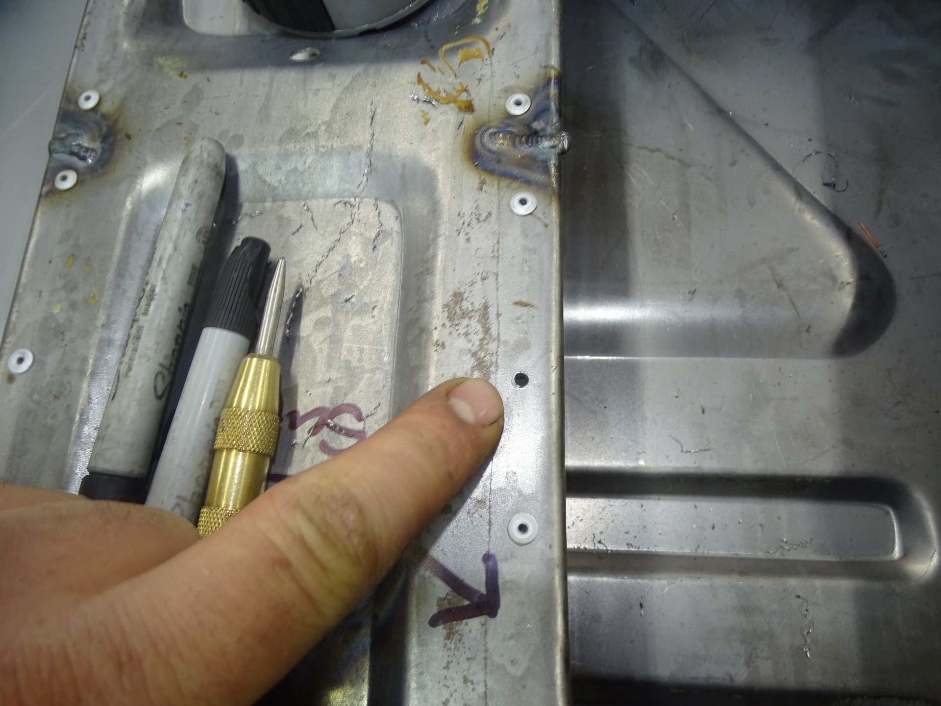

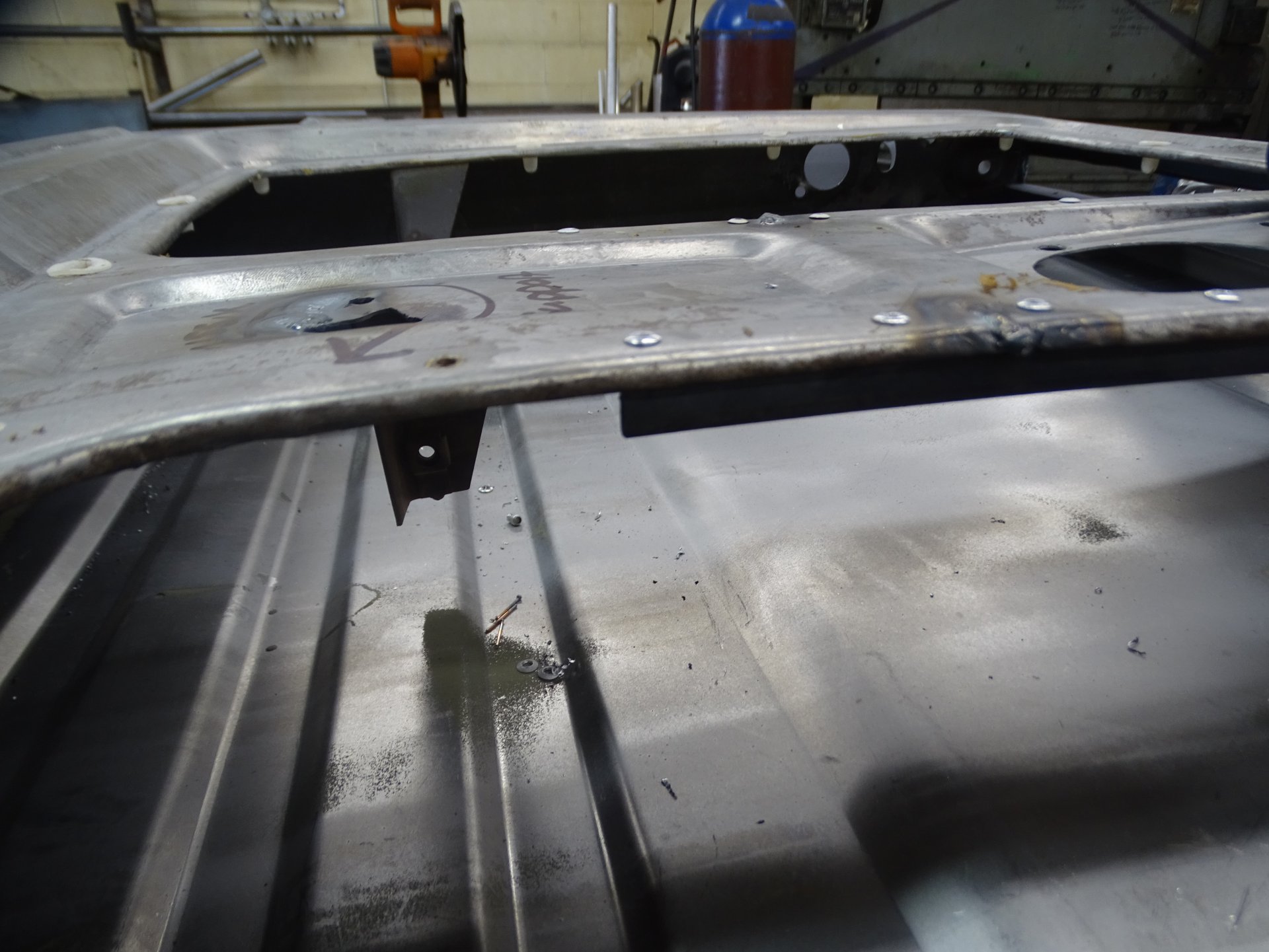

Off to more small rust repair from the doors. We are in process now of doing random small services before we actually start the tear down process
More door repairs, seems like a never ending situation

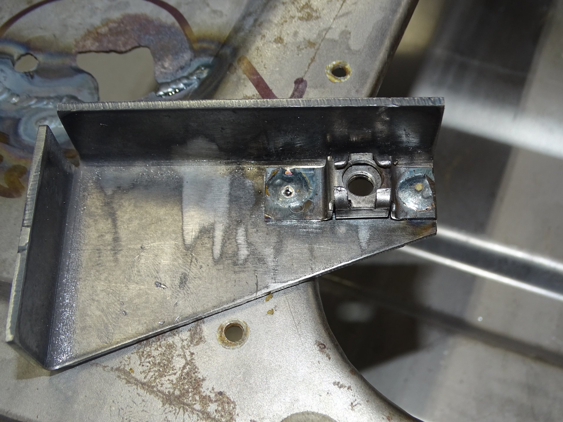

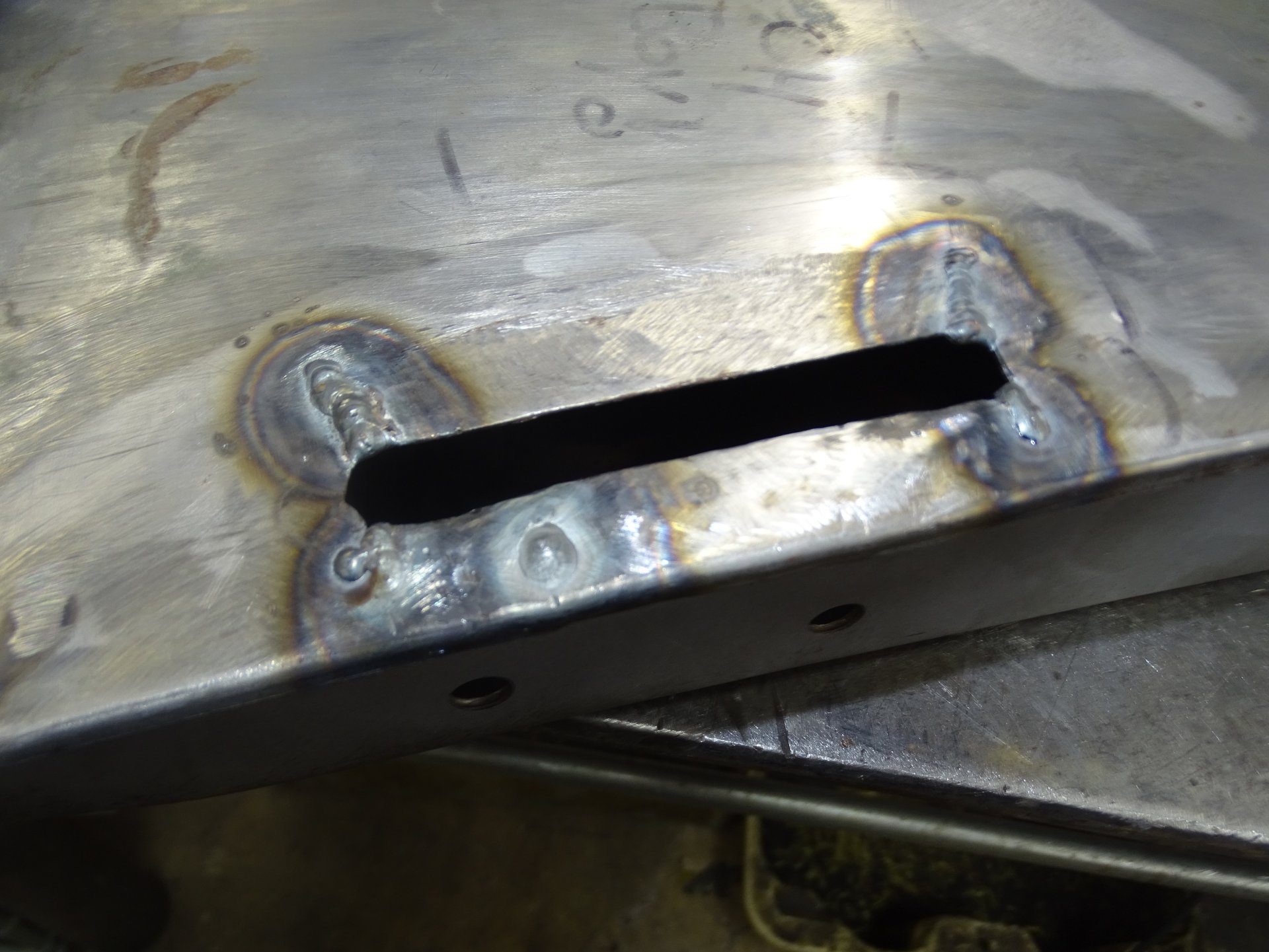

We found rivets holding some door structure together, so our miller tig and mig got to work

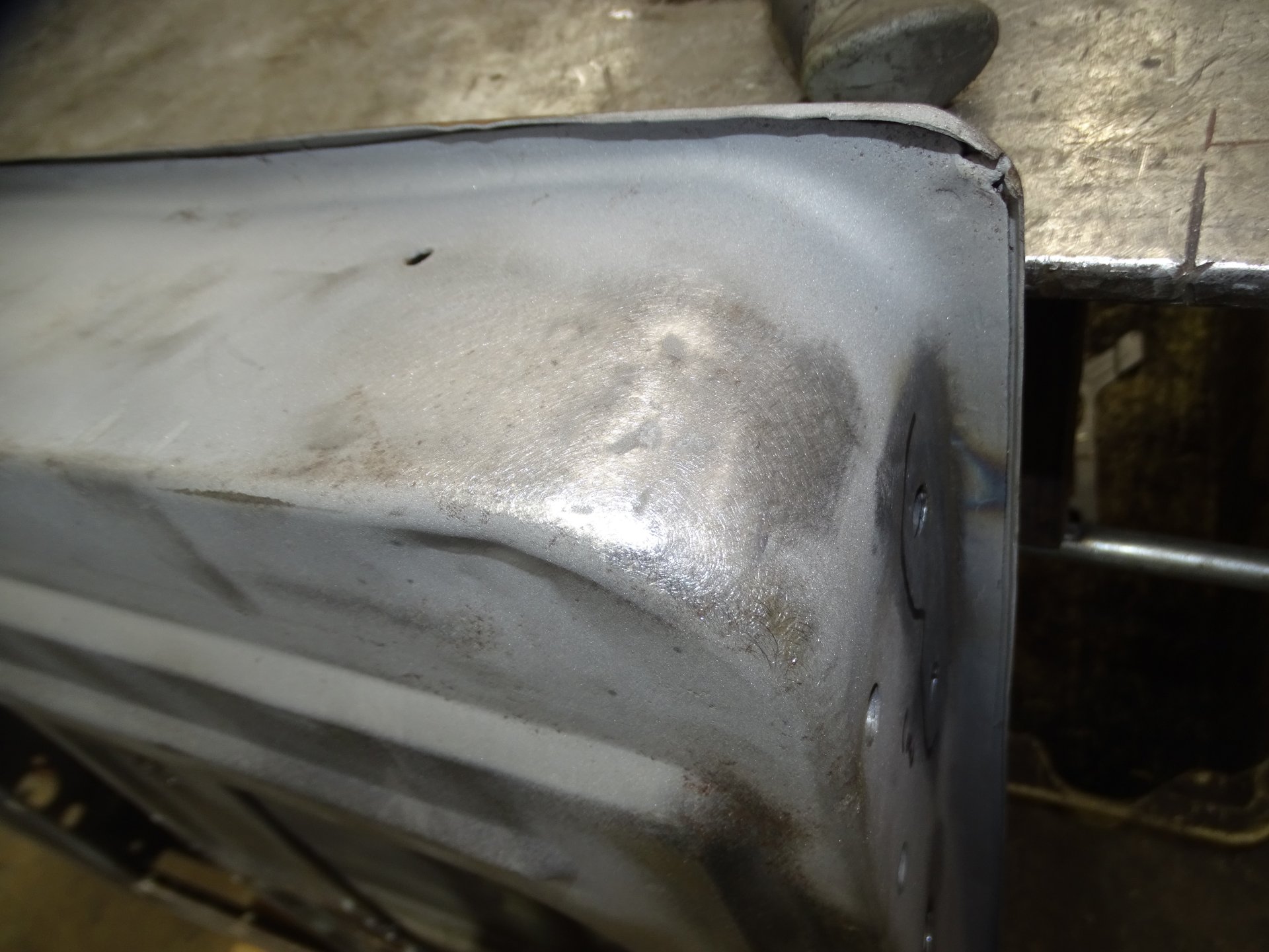

Slow and steady wins the race of sheet metal repair
All those areas are very weak and were cracked on my doors as well. I used spot welded backing plates to add support/rigidity to several areas similar to what a car manufacture would do. Just fixing the cracks will not stop the flexing and eventual cracking again. Nice work, thanks for sharing.

Door repairs are so time consuming. Dents and dings are non stop on this LV
