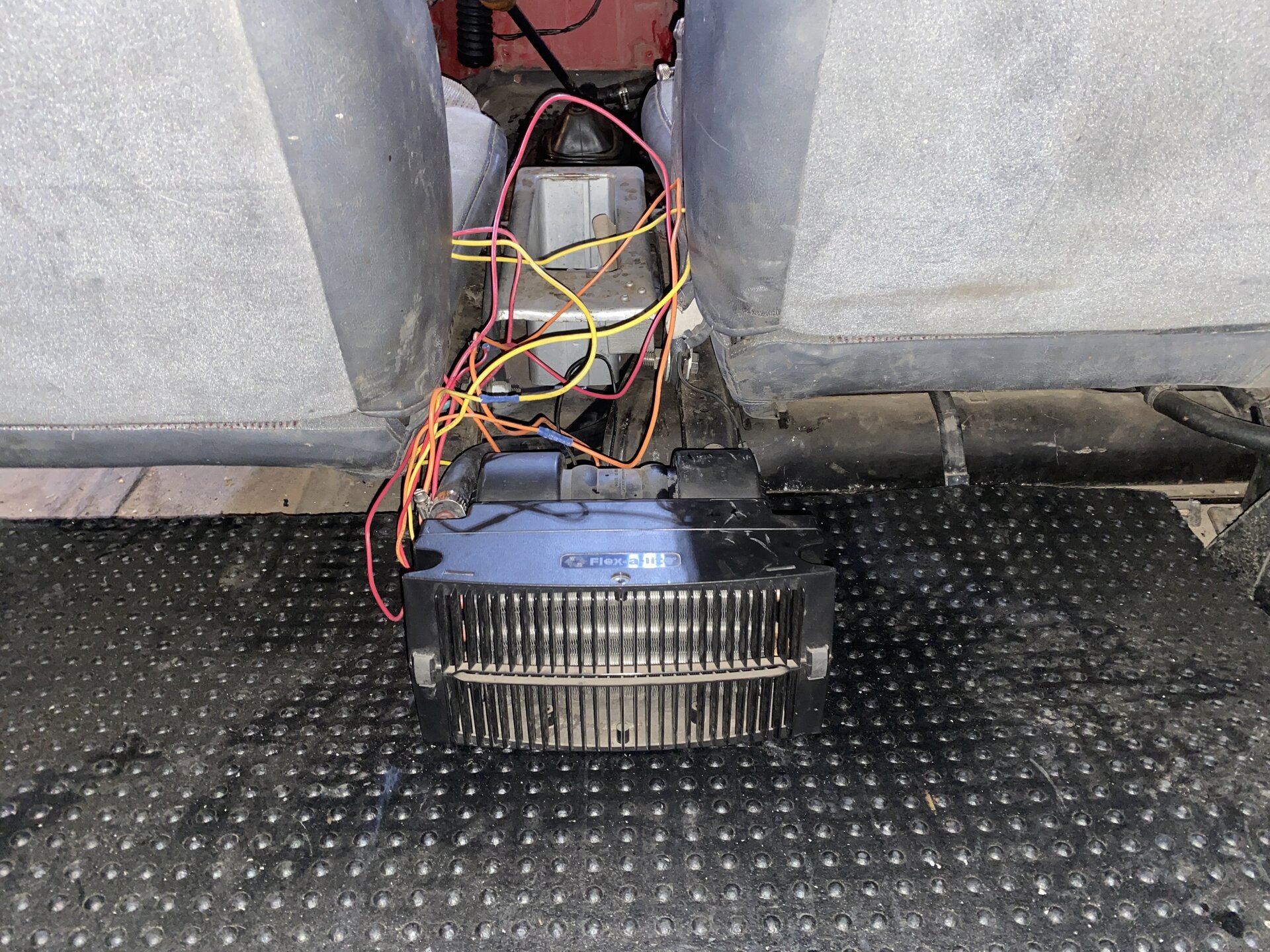

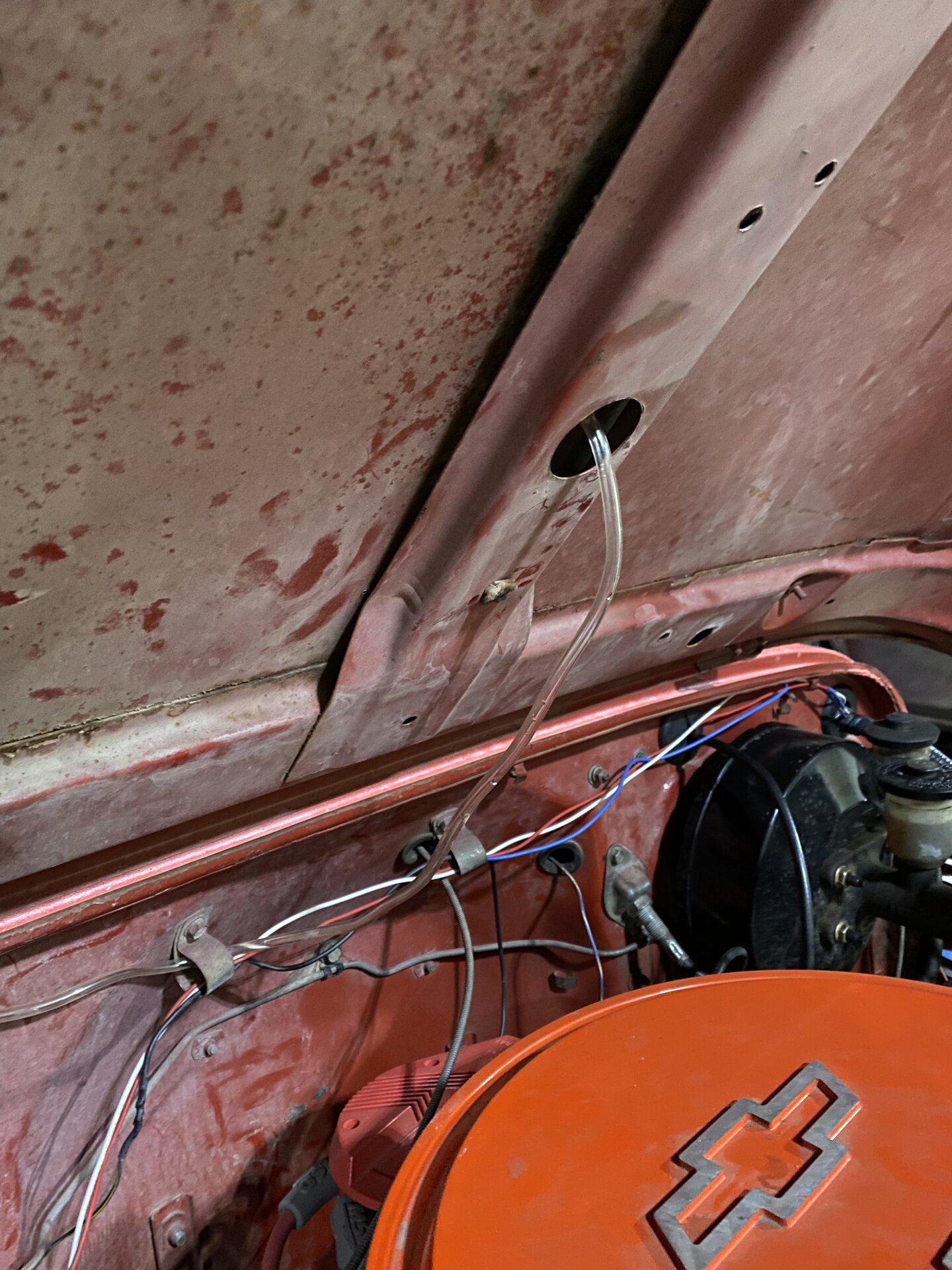

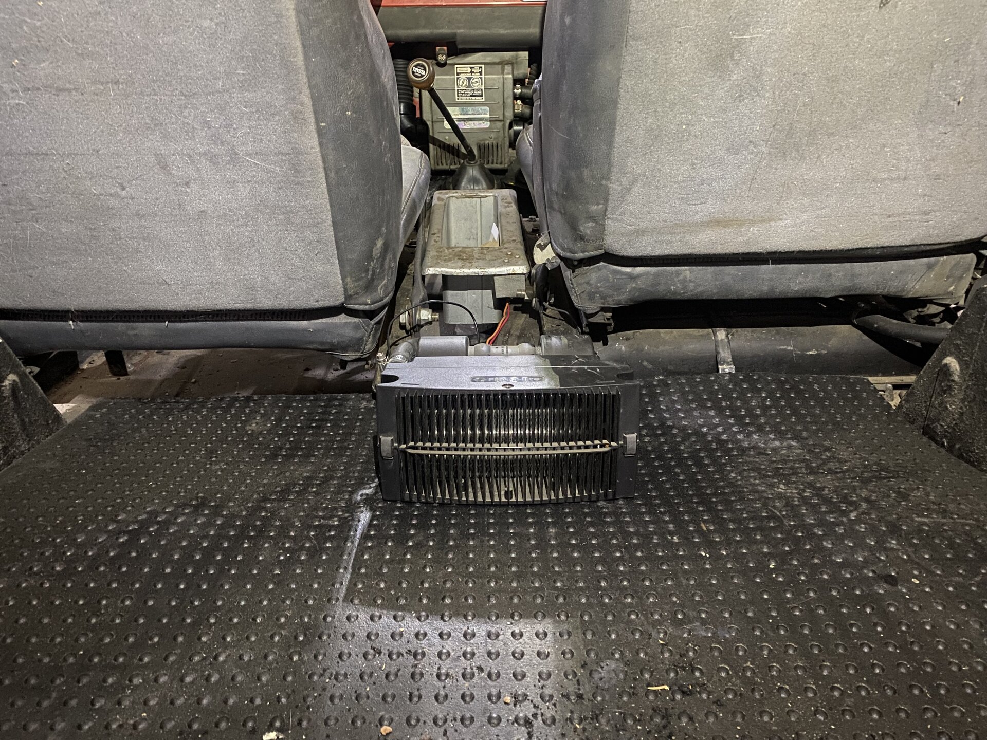

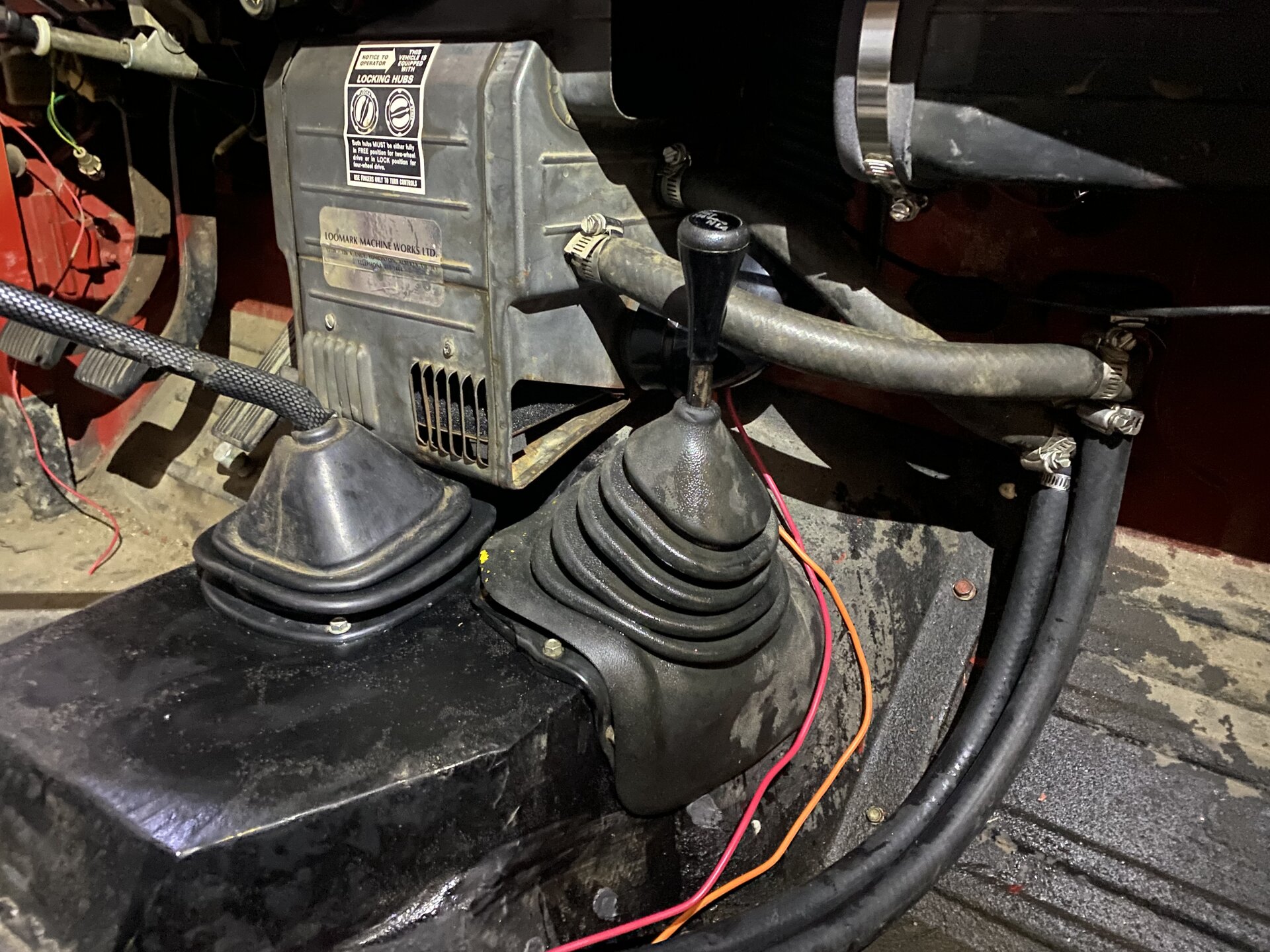

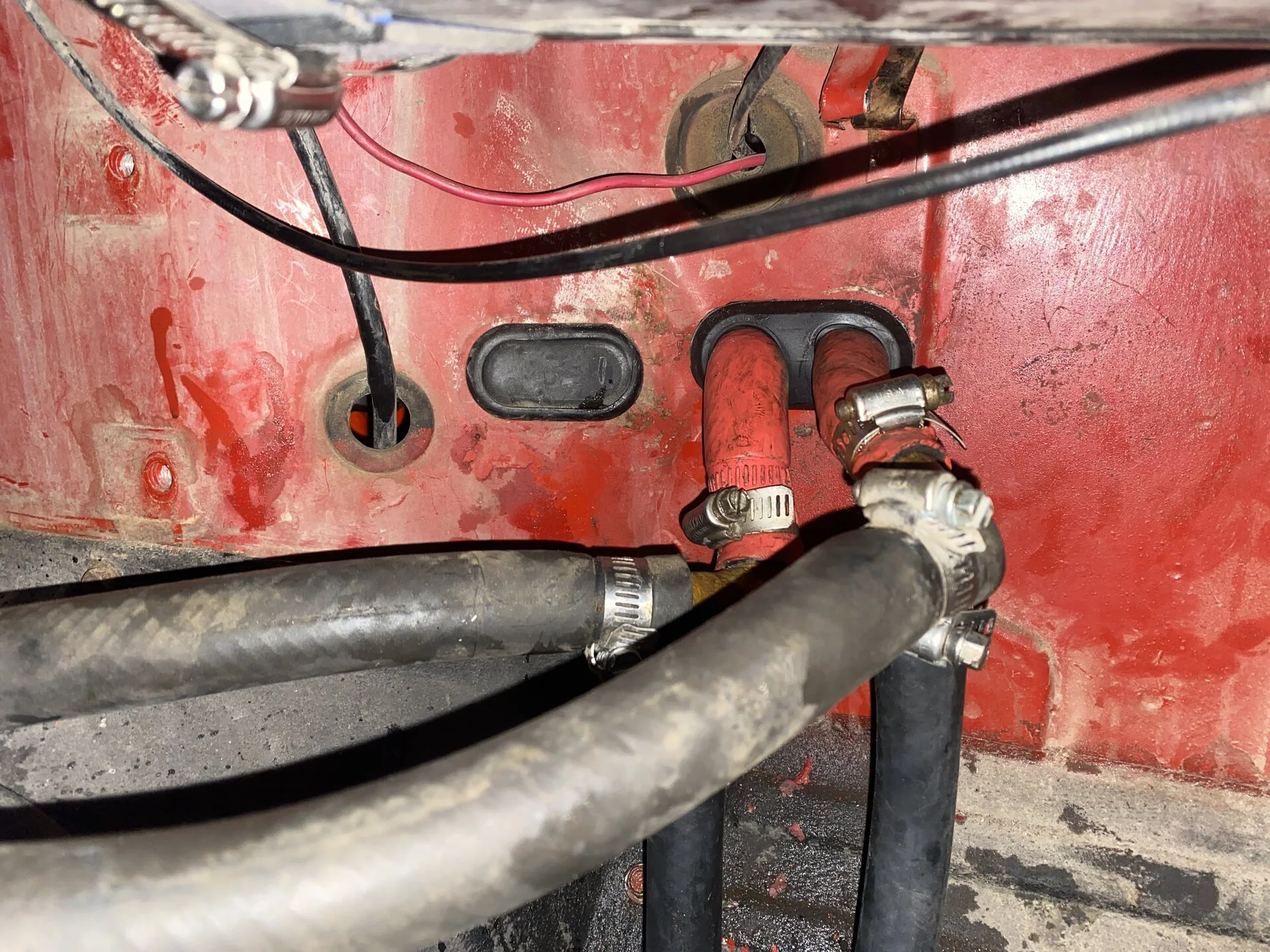

View attachment 3520374View attachment 3520375View attachment 3520376View attachment 3520377i was able to get my rear heater in. it’s a bit of a messy job. it’s a flexalite mojave i’ve had sitting around for a bit. after cleaning up the OEM rear heater switch i wired it up with the red black connected to the original ignition power harness with a small jumper to the OEM rear fan wiring.
i then hooked my orange (high) to the blue/white on the switch harness and the red (medium ) to the blue/black on the switch. the yellow (low) i left disconnected as it really just makes noise whiteout really moving any air. this way i can use my OEM switch. i’ll need to wash the cab out now before i finish plugging the holes in the floor! oh yeah and a new fire wall heater hose grommet from @Racer65 thats been sitting in my box of gaskets/weather stripping! i think i’ll get some heater hose wrap and burry the wires in it too just to clean things up
i also disconnected the momentary button that for some reason activated the starter even though the key works fine 🤷‍♂️. i’ll use this switched power for a couple charging accessories. the hole in. the dash is plugged for now but i may put a switch in there for some accessory dash lights. not tonight though.
I'm glad to hear your going to do something with those heater hoses to protect the passenger. Years ago I ran rubber hoses similar to yours to my frt heater. I had a friend hop into the passenger seat, he looked at the hoses then looked at me and asked, what would happen to him if one of those hoses were to burst? Needless to say, I spent the next couple of dayd making metal lines and used the stk covers at the hose connections.

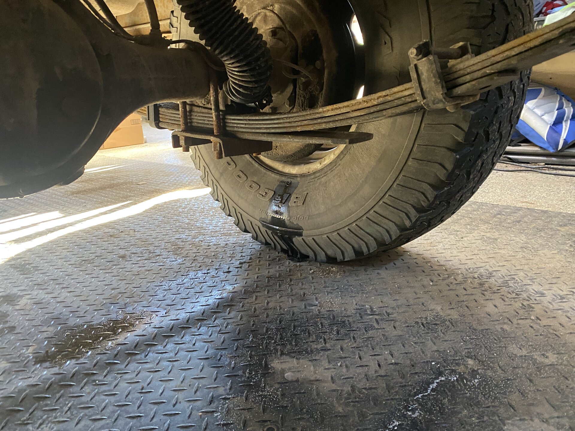

ok so snow is coming (later than most years thankfully) and i’ve got pretty much everything important done. now i need tires. i am currently driving on a set of bf goodrich kos that i’ve personally had for 12 years and they were used when i bought them. needless to say they are worn out and suck

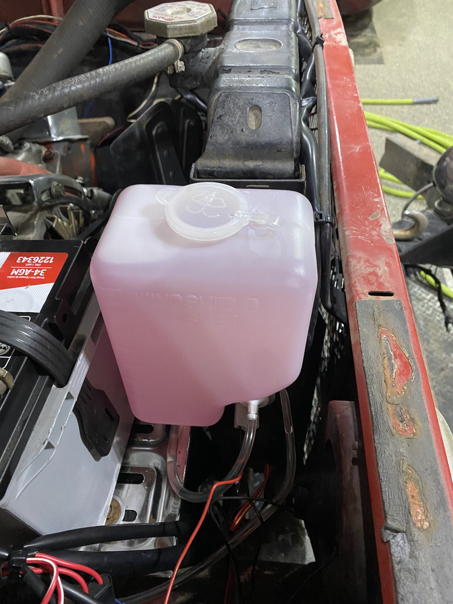

it got really melty here which is uncommon for january. i needed to install a washer and pump so i got one from ccot. cheap kit but works well pain in the butt to install the button where i wanted it (red button in a random hole made by a PO) but otherwise simple install. i already had an adjustable squirter in the hood so i just hooked it up to that. now i can clean my windows.
