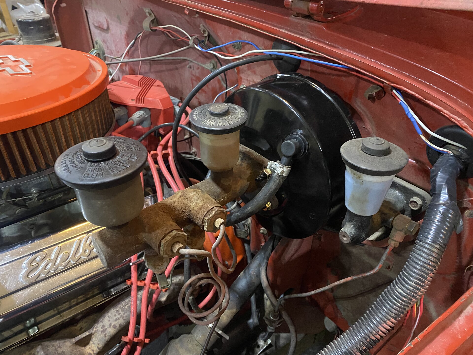

out with the old in with the new. thanks yet again @Racer65
this was a scratch and dent one too!! looks pretty dang good to me!! and as his site says literally a 1/2 hour job. fits perfectly. the only tech is that the fork that attaches to the brake pedal needs to be swapped over. i just counted the number of threads under my jam nut and replicated that with the new one. fit perfectly with no further adjustments.

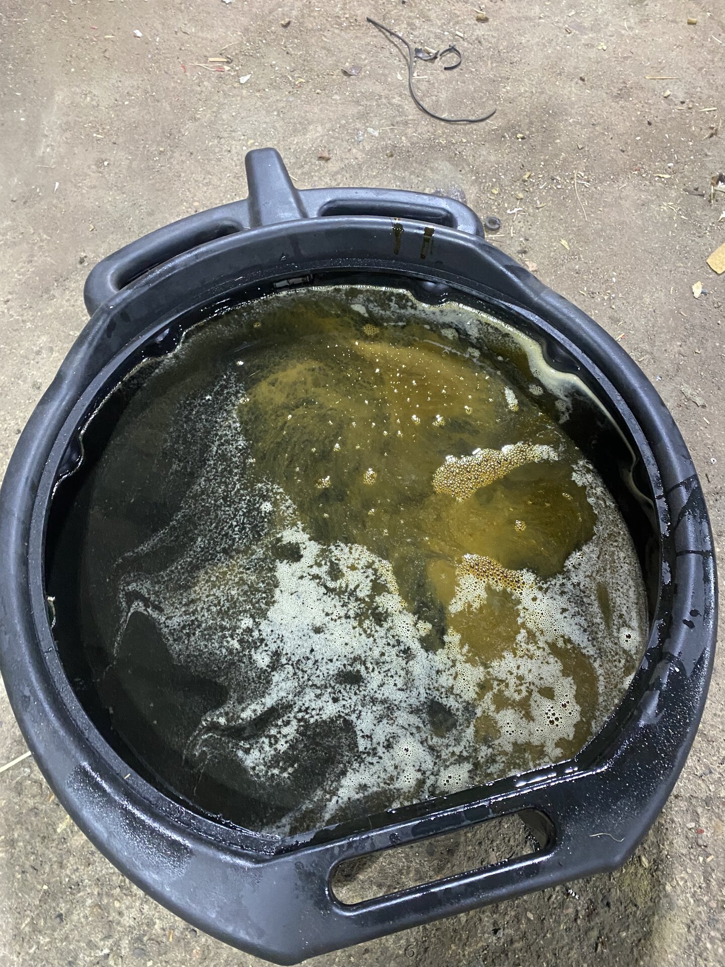

more maintenance stuff tonight. i did differential, tranny and transfer case oil changes. glad i did.
i had done a tranny oil change earlier but with the wrong oil so i used it as a flush and got some proper gl-4.
not sure what was used in the diffs. one looked yellowish like water had gotten in there. i saw some metal shavings on the plug too so that worries me a bit. thankfully i have a few good diffs floating around here if i need one. the front oil looked like dark brown molasses not gear oil. so that’s done. i also adjusted the brake booster a bit so i don’t have a much pedal travel before engaging the brakes. i think i may still have a bit more to adjust. but little by little. lastly i fixed my choke (i hope). seems as though the spring on my edelbrock electric choke wasn’t engaging the choke mechanism. now it is and i found that when i rebuilt it i didn’t put the little gasket in so there was no way to tighten it up. now with the gasket in place i can get the housing to pre load a little to keep the choke on a little

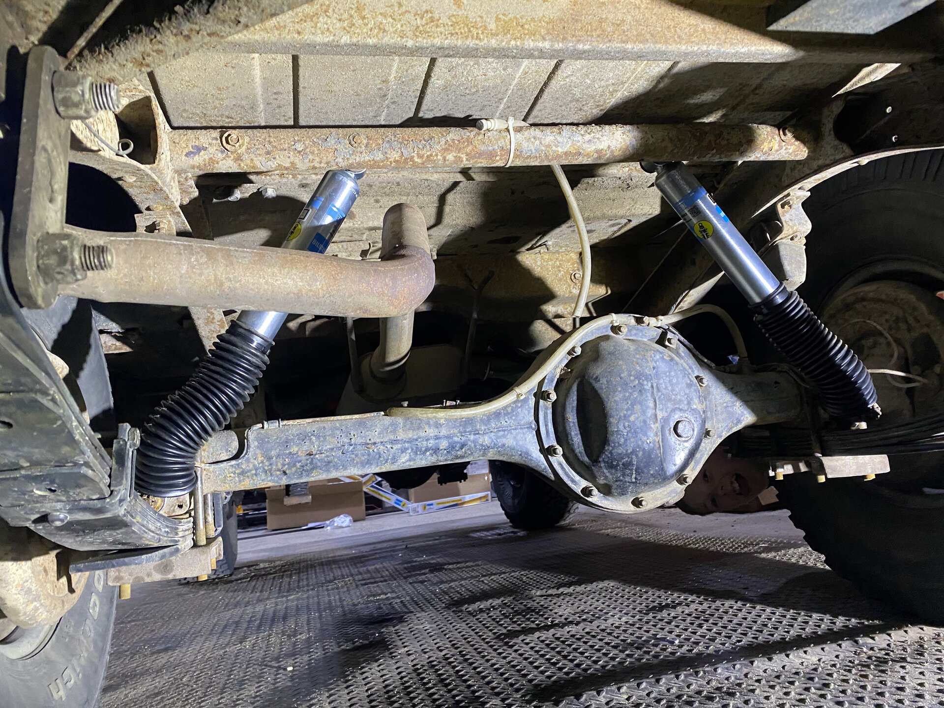

rear shocks on tonight. fronts another night soon!
i also got a new bulb in the high beam indicator so that works. i put some red LEDs in the instrument cluster. i’ll see how i like them on my drive in to work tomorrow. out of curiosity is there a dash dimmer on the 1972?
i’ll either adjust where the boots sit or just get rid of them all together. they look funky where they are
i also got a new bulb in the high beam indicator so that works. i put some red LEDs in the instrument cluster. i’ll see how i like them on my drive in to work tomorrow. out of curiosity is there a dash dimmer on the 1972? View attachment 3506466
I think you are going to like the new shocks…I just adjusted the boots.
so amazingly i can actually tell the difference with these new shocks. they’ve made a significant difference from what was in there. this is what was in there.
these gas shocks have no self rebound and are pretty soft compared to the bilsteins.
now the springs don’t compress as much so there’s not so much rebound making it smoother but not harsh. i can feel the front bounce once or twice more than the rear making the driving characteristics a bit funny. i’ll get the fronts on tonight.

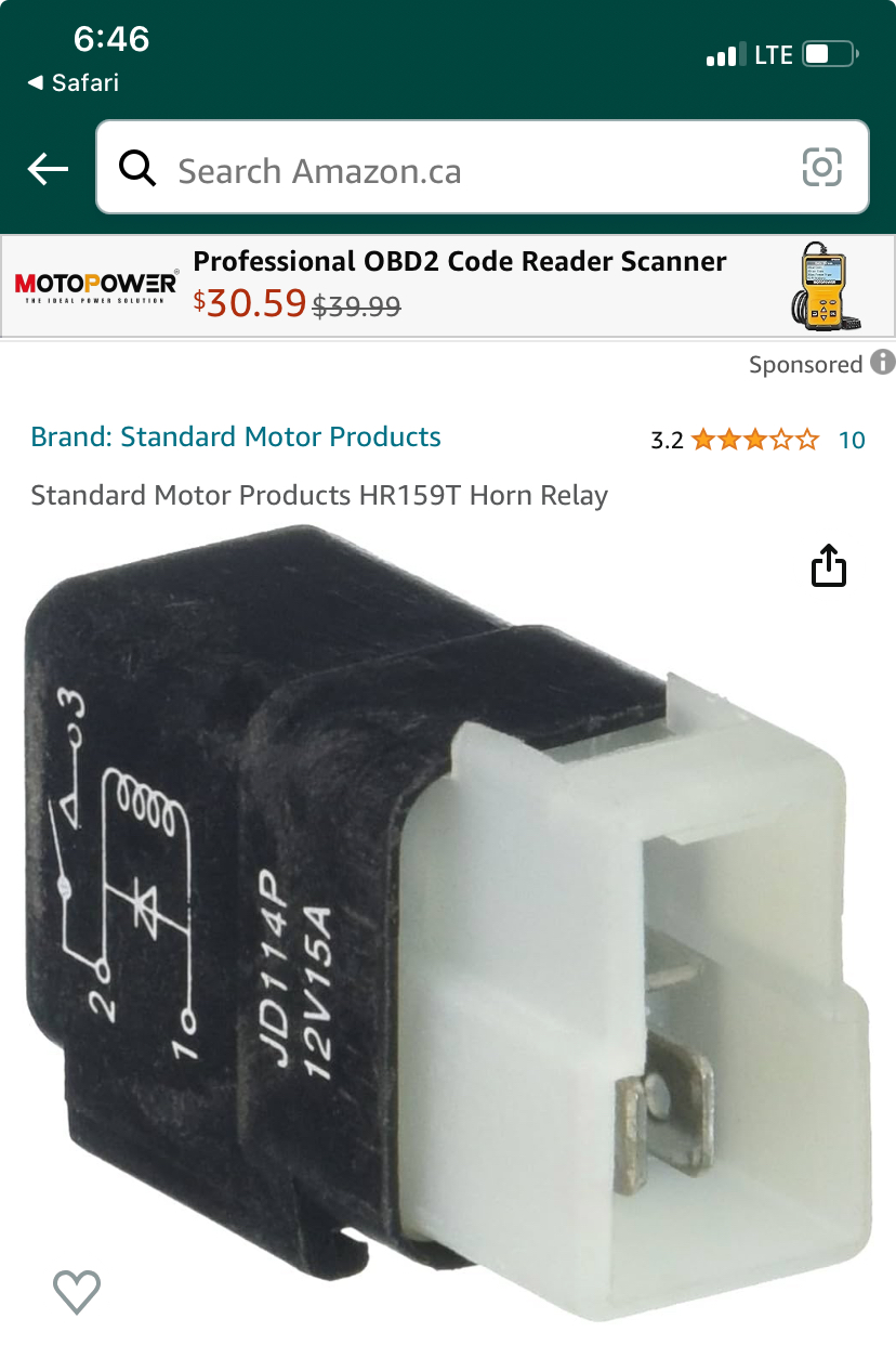

anyway after all that still no joy. i found the horn relay and took it off to clean it up but found it has a rattle to it. i assume something is broken inside. so now i have to figure out if something else will work or do i need to buy a $60 relay.
Are there three wires at the relay, a GR, GY and GW? If so, a Wells HR610 horn relay will work.
i looked up the relay you mentioned. i do have the three wires you mentioned but a connector like this.
i could get this one or i could just cut the wires and use the wells. i’m tempted to try to standard motor products one before cutting my wires
IIRC, the GR wire goes to the switch terminal (#2?), GY wire to battery terminal (#1?), 2x GW to horn terminal (#3? - are there actually two GW wires in your harness?). I’m not a circuit wonk, but I do see a resistor symbol, a diode symbol, and a switch symbol 😂.

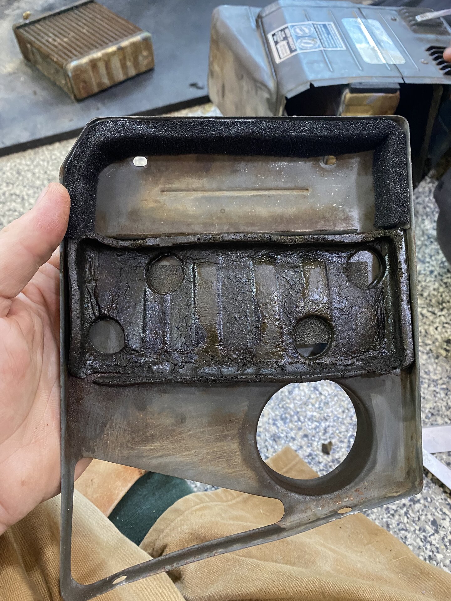

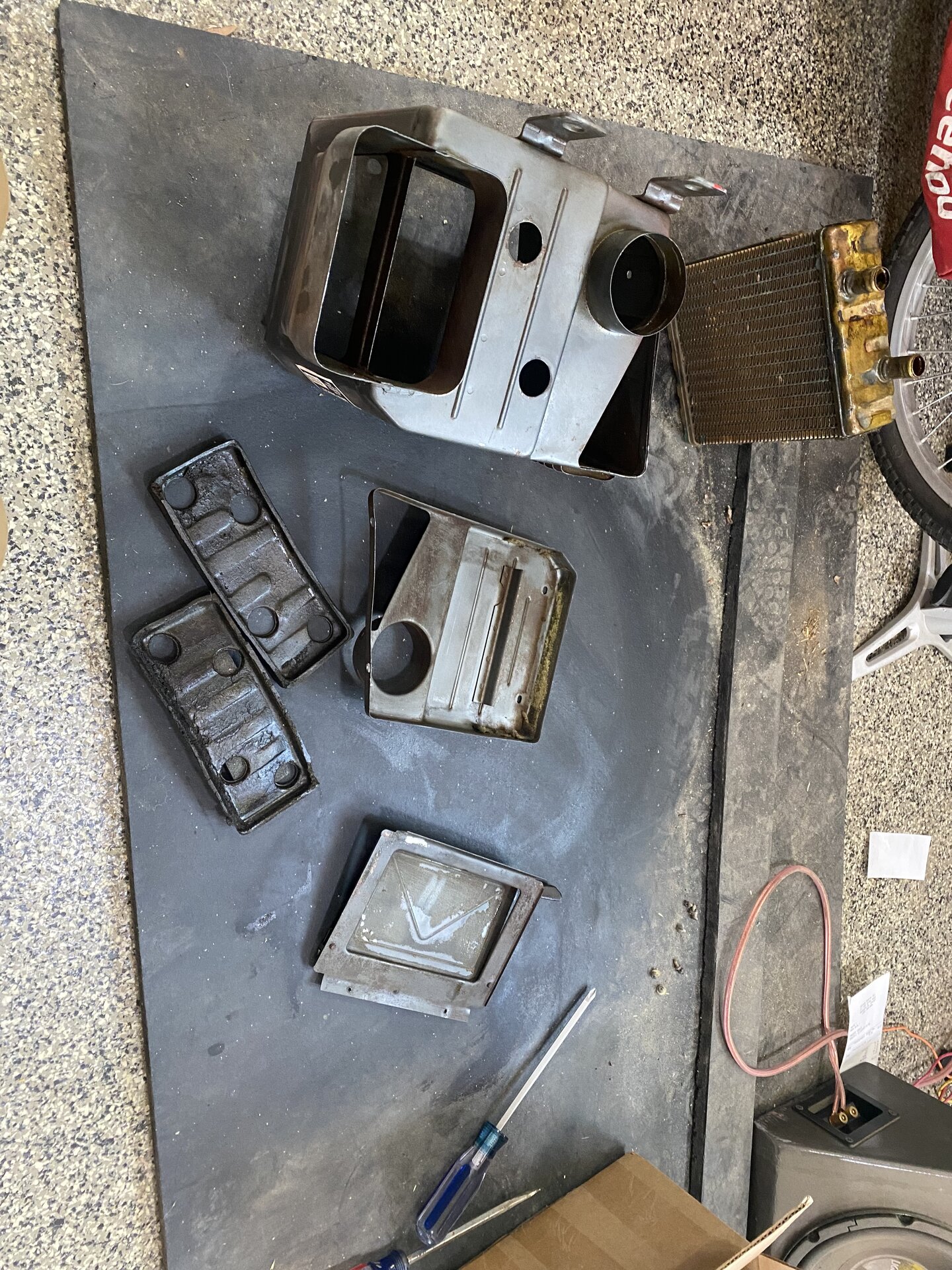

part 1. heater rehab. as i’m leaving everything patina…ish i’ve chosen to leave the heater looking good. as i’ve said before full blown heater restorations tend to lead to frame off truck restorations. i don’t want to go there.
so heater out
pulled apart. only about 8 screws and it’s apart
parts through the parts washer and cleaned up

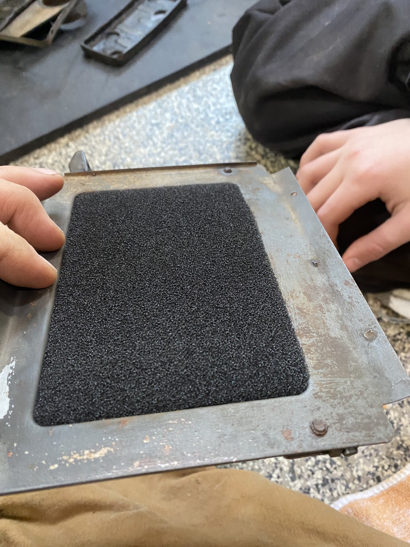

i just cut my own foam pieces with some closed cell foam for the borders of the heater core and open cell for the heater flap.
i was able to reuse the core end cap foams as they were still in decent shape
