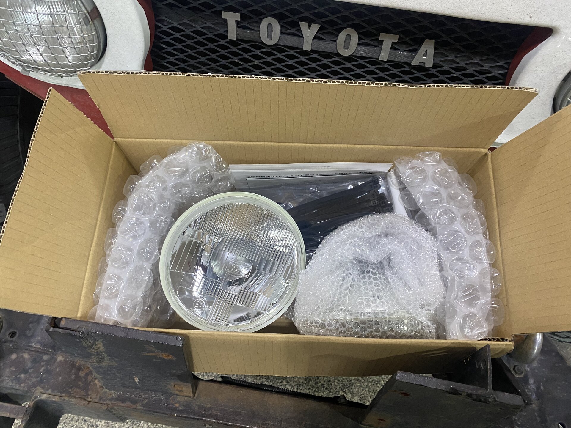

back ordered lights only took two weeks to come in. koito kit for $35 CAD!! even the guy at the desk had to double check to make sure the price was right! such a good value
Just think how much cheaper the kit would be if they didn’t include 4 feet of extra wire loom! :)
