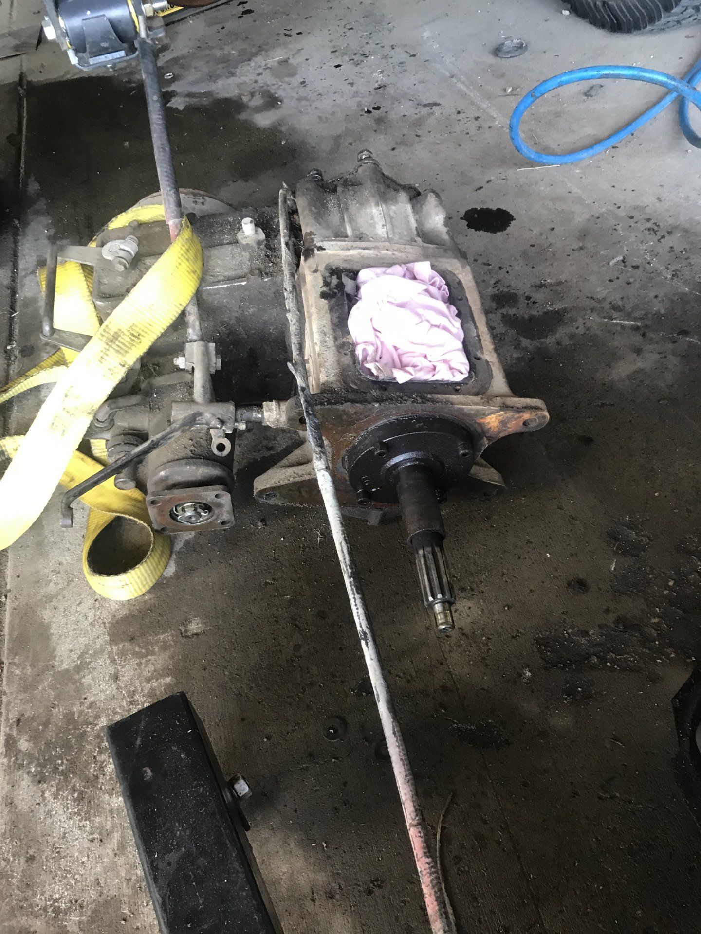

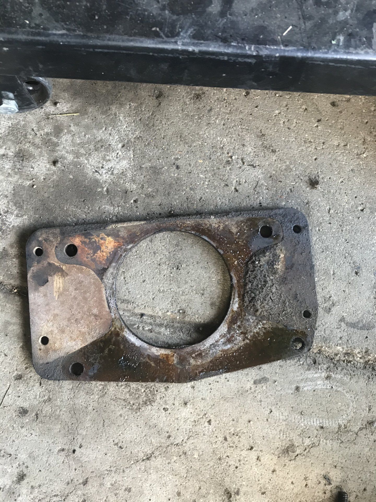

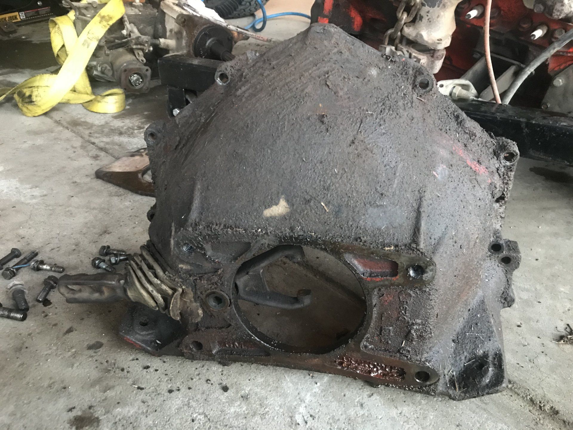

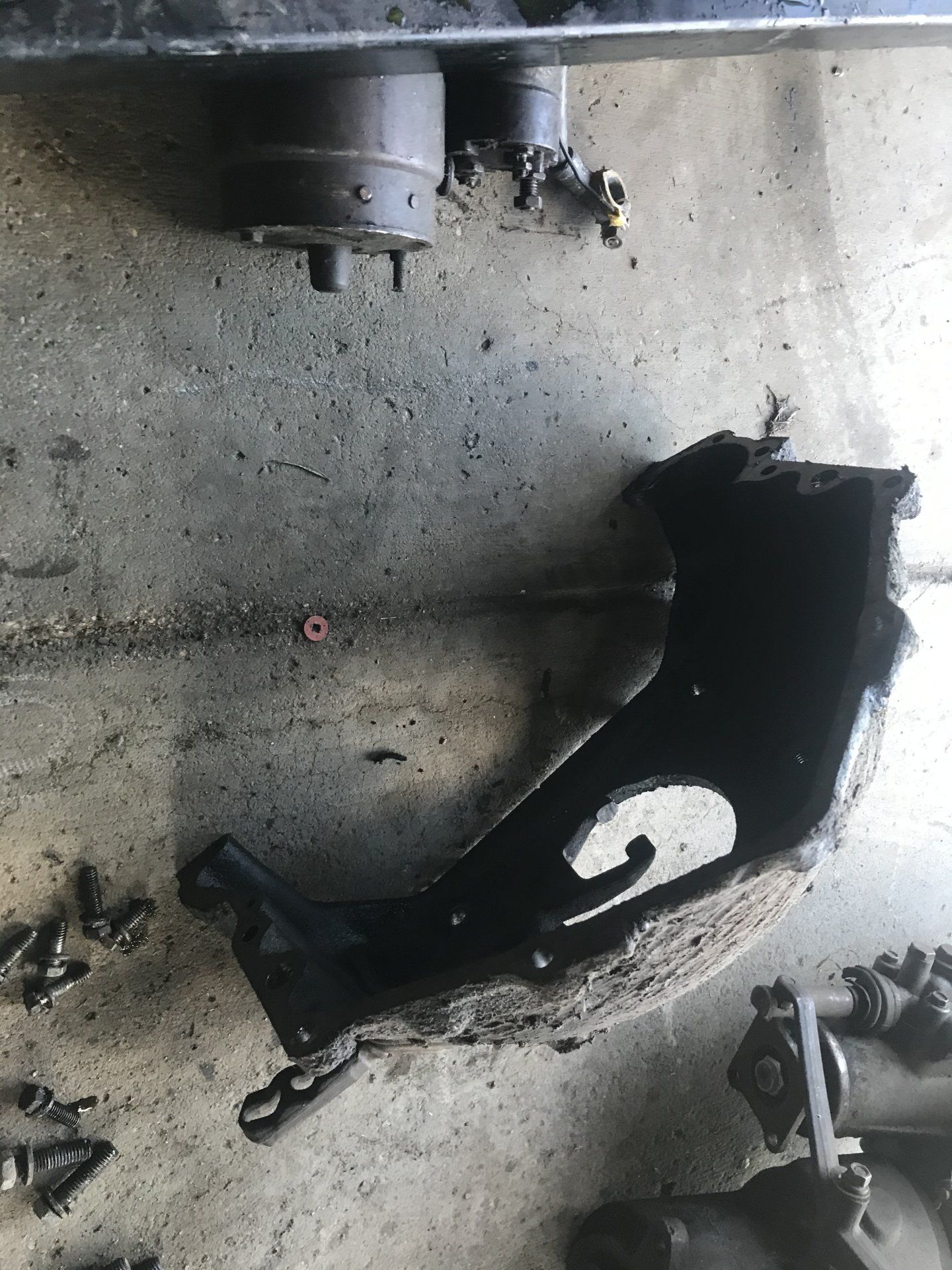

hit a roadblock. i made the assumption based on my reading that the 3 speed bell housing would have the same pattern as the 4 speed at the engine block but if need to use the 4 speed bell housing to mate the 4 speed transmission to it. well when i got the engine out it looks as though an adapter was used for a chevy bellhousing to the 3 speed and it won’t mate to my 4 speed but there’s also no block side adapter in my stuff to allow my 4 speed to mate either. now i have a bunch of parts that won’t mate!! it looks like i may have to buy a belhousing from advance adapters unless someone can make heads or tails of this for me!!
here’s the 3 speed
here’s the adapter plate to the bell housing
here’s my 4 speed View attachment 2347555
and here’s the bell housing that came out of red beard
was this maybe an early downey adapter before the fancy custom bell housings were made?
here’s the 3 speed
I used this FJ40 4 speed to Chevy small block conversion from Advanced adapters. I did move the motor mounts 3 times to get the shifter placement right. I also had to heat and bend the shifter to clear the dash.

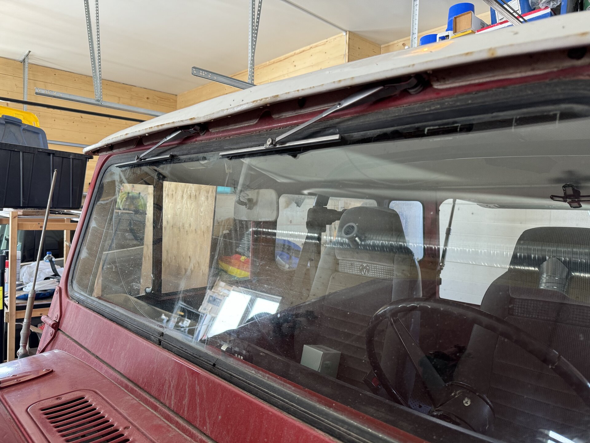

but while i was tinkering and cleaning stuff i also decided to put my new wipers on. the old ones were missing the pieces that adjust the tilt of the blades which are also specific to blade attachments. i got a new set from cruiser outfitters also with some new brake cylinders and a knuckle rebuild kit. that’ll happen this summer when i can get my chevelle out. i’ll dig into red and do my power steering conversion i hope. for now ill be able to see during the melty season!! you can see my droopy wipers in post #177 if you look close. they didn’t work well

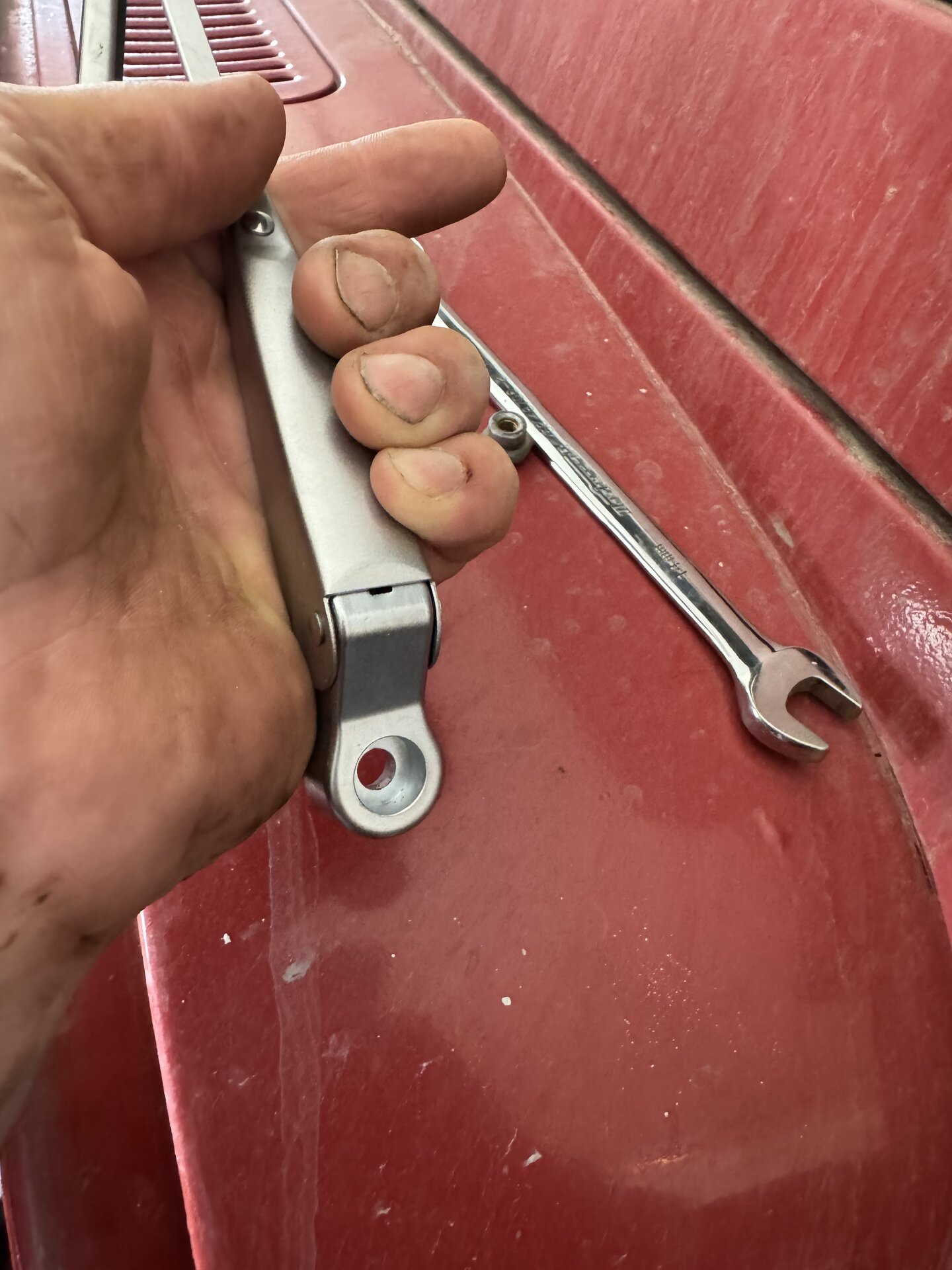

i added a couple pictures of the capture nut for these specific wiper arms. there was another thread recently that had questioned it.
