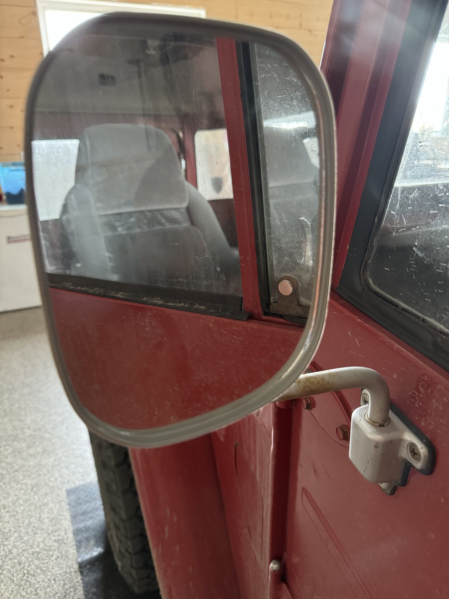

so to celebrate i did an easy upgrade that give me some satisfaction. drivers mirror is cracked and won’t stay put in a wind and the glass was getting worn too.
so new mirror

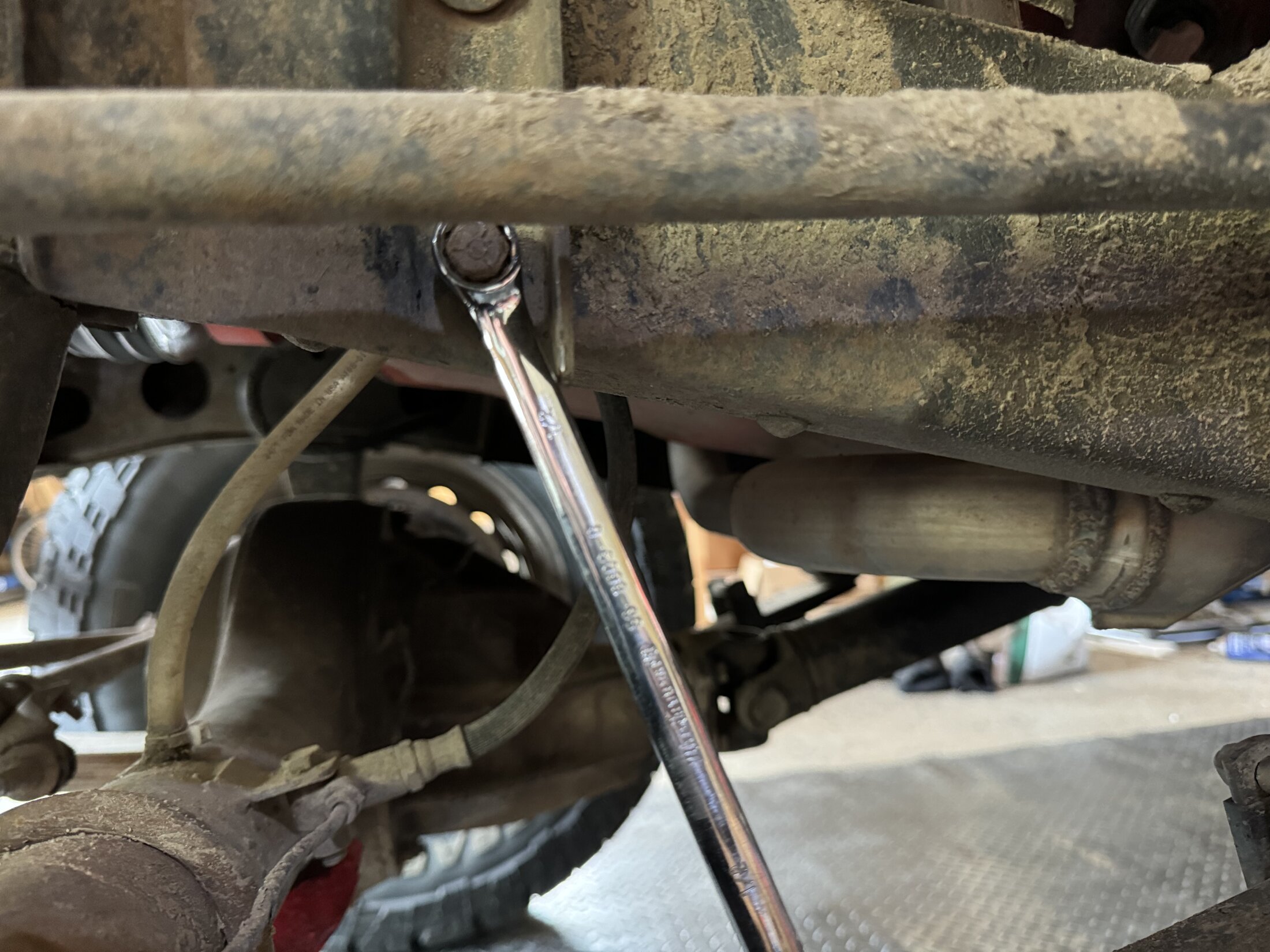

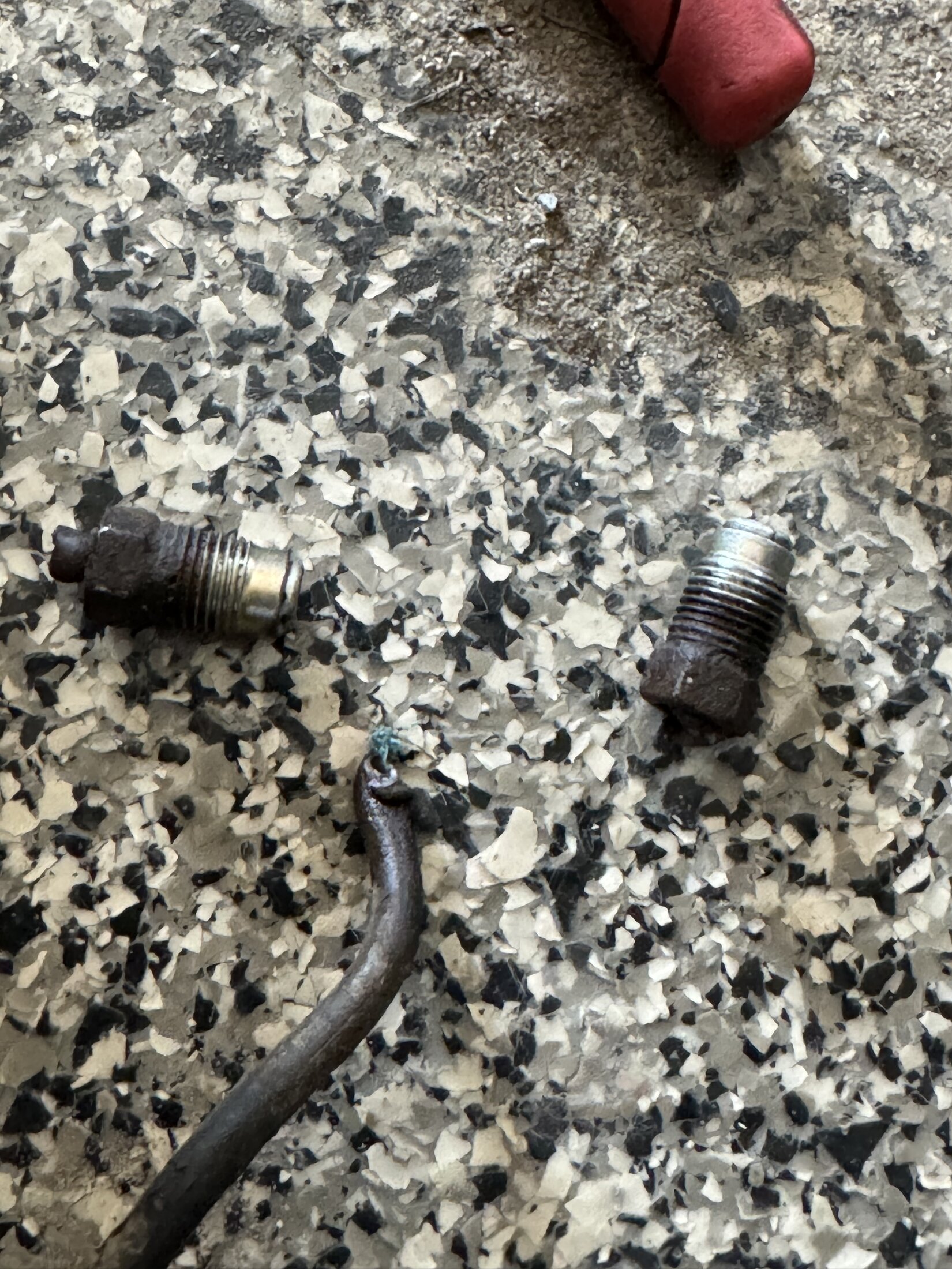

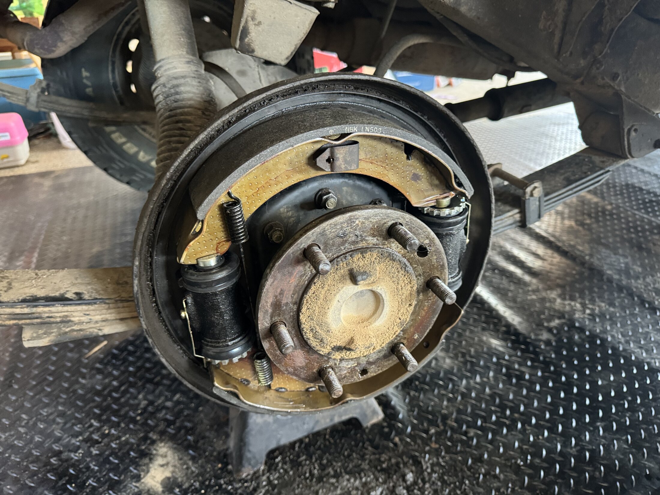

l finally had some time to to work on red. the rear brake cylinders are leaking like crazy so time to fix that. they fell apart as i took the shoes off!! pretty simple fix but the hard line to the axle was seized and of course broke taking the nut out of the old cylinder. thankfully i have stuff to fix it! or so i thought. i cant find my brake fittings. so i’ll have to go get a few more to restock. i started flaring but can’t finish yet
i fear i smell some gear oil too. so i wonder if my axle seals need to be done. not today but i’ll keep an eye for more wet spots now that the brake aren’t leaking.

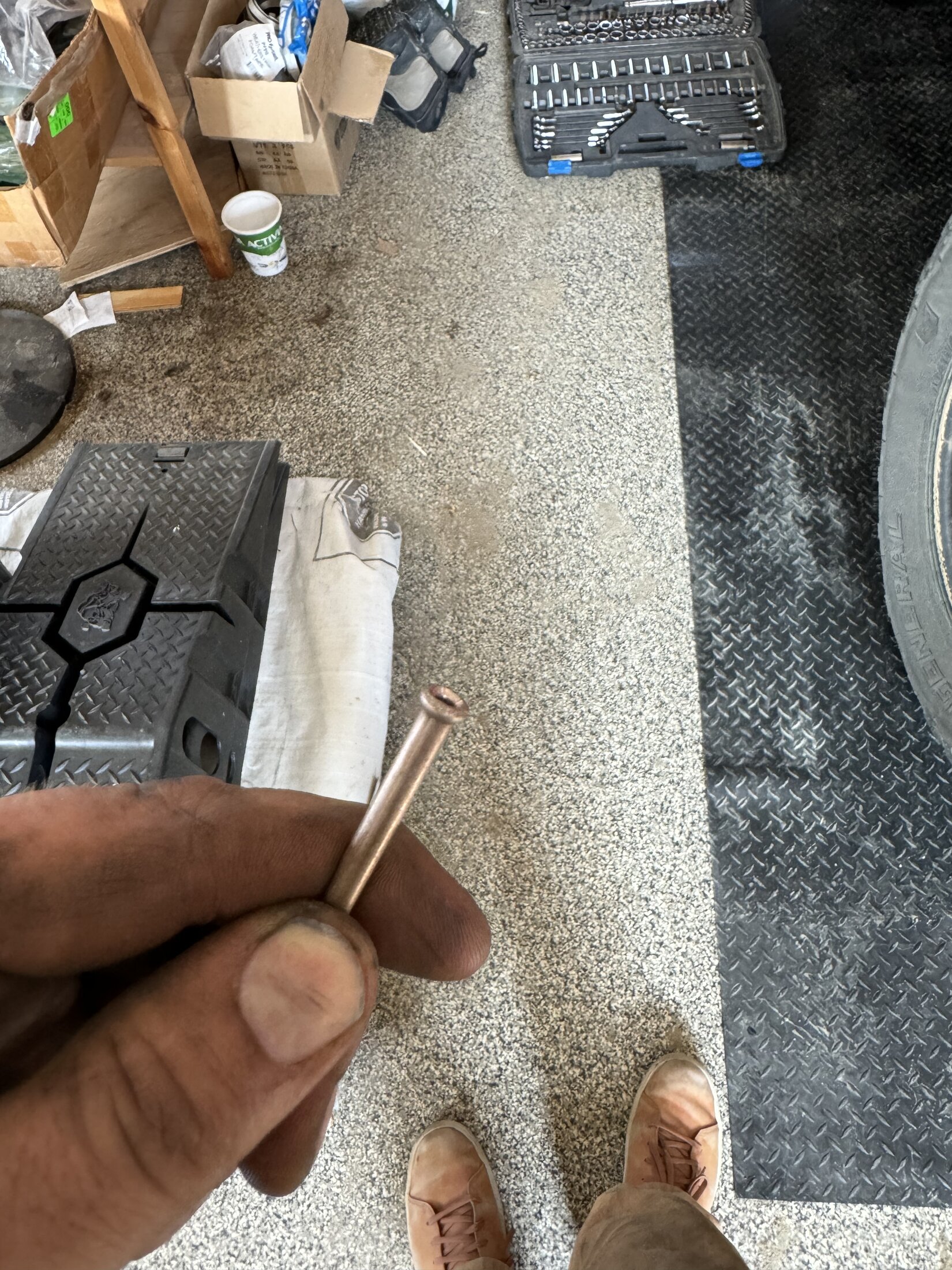

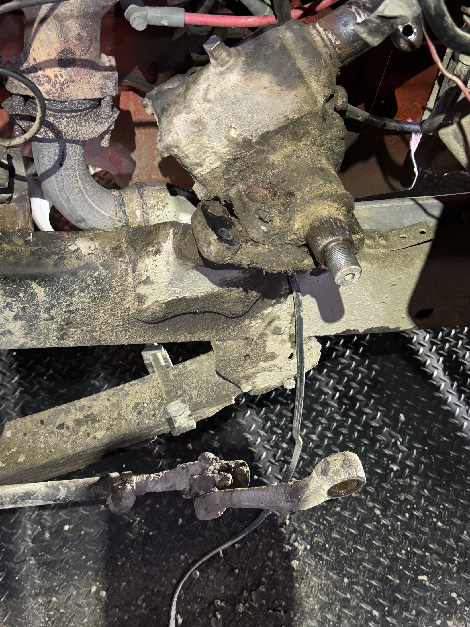

little more work done tonight. got the pitman arms off both the mini truck box and the fj40 box. my son helped again tonight so he hooked up the new rear brake line. i taught him how to make it so he built the line. i did the second one when the other main line broke taking it off to do the brake cylinders on the other side.

rear brakes are done, bled and adjusted. i hade to make two new hard lines but that’s all done. i have to out it together enough to drive it outside we have a family reunion next weekend that my family wants to use the garage for serving food. so i’m not allowed to have my unfinished project sitting there. i thought it’d be a great conversation piece but i guess the smell of brake clean and whatever oil leak leaves a puddle that day don’t mix with breakfast food! i’m still waiting on some of the brackets i need for the steering modification so ill move it out for now and get back to in after my family is all gone

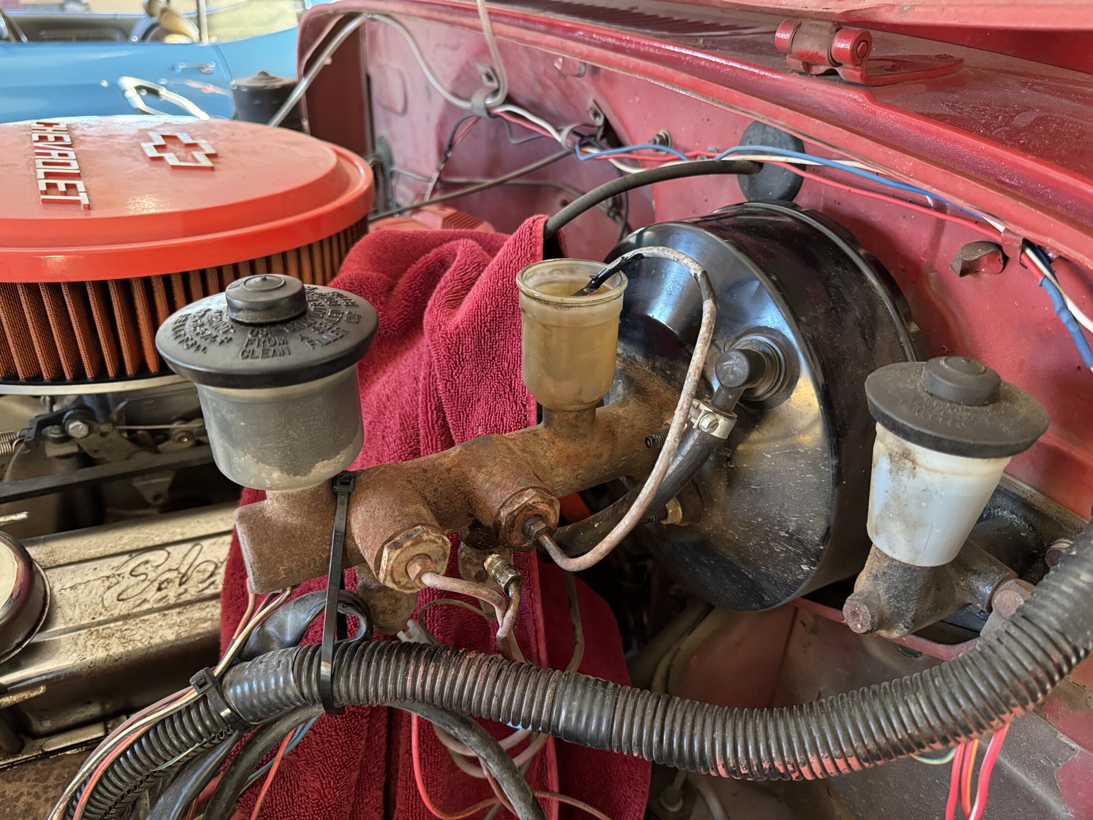

dang it i think i got air in my MC. it worked fine before this episode and now my pedal goes to the floor. i can pump it up and it’ll hold but i had a bad feeling i let the MC get too low on fluid. hoped i might have caught it in time but now i think it’ll need to be bled. oh well. these things happen!
mc bled, new fitting on a leaky rear line and rebleed. i’ve got brakes again.
this is what i found for bleeding the MC while it’s still in the vehicle. i only did the rear circuit as its the only one that accidentally got emptied. fronts work fine.

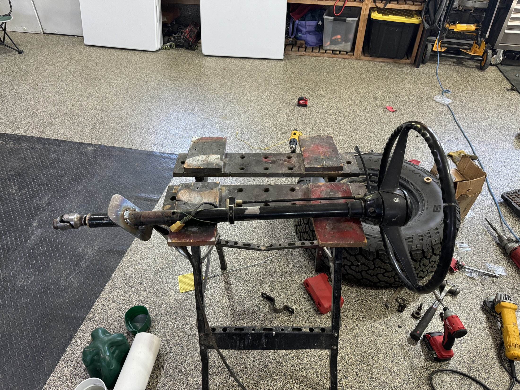

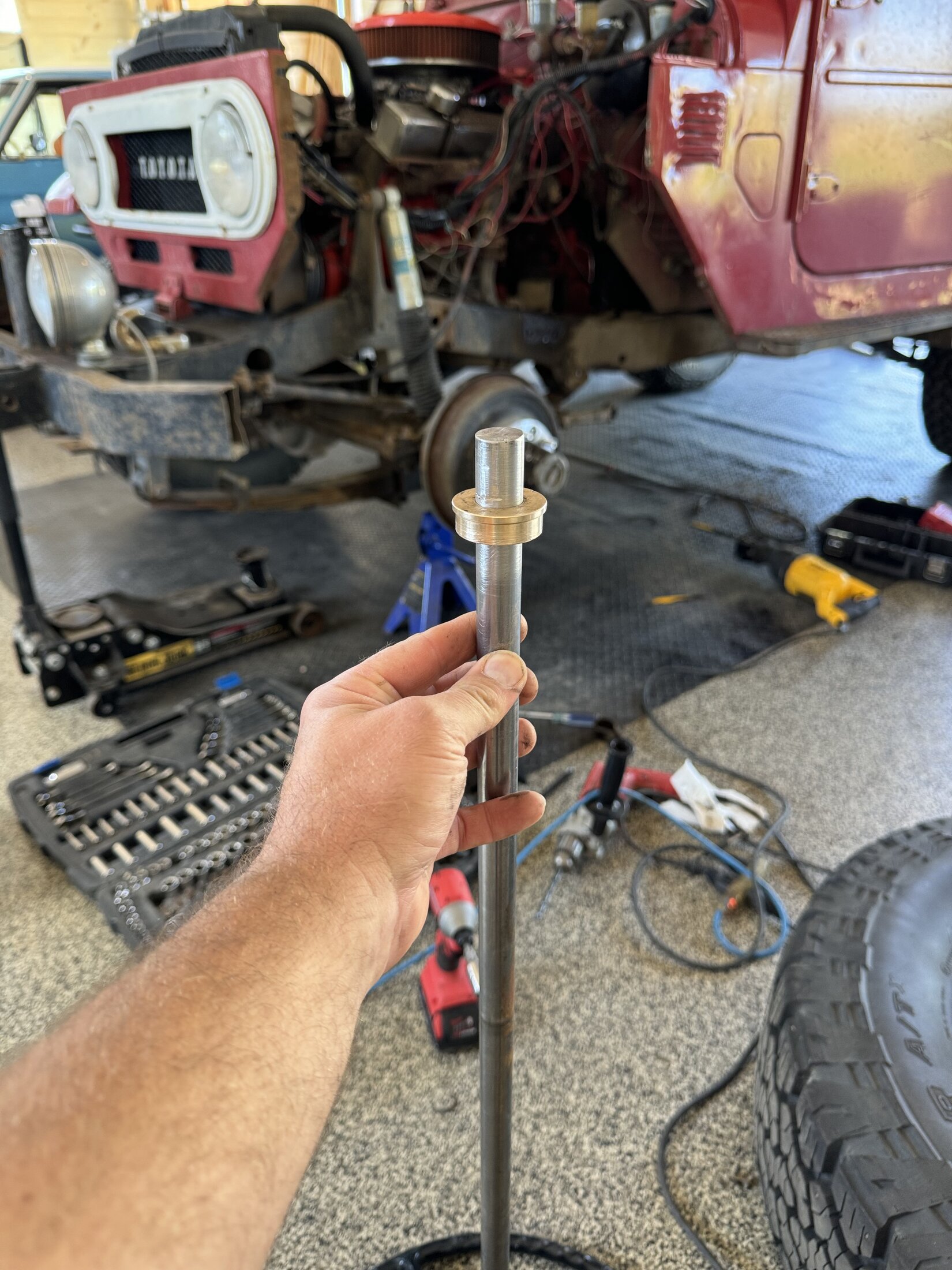

anyway i got the power steering conversion going again. i’ve pulled the column out and have cut it down and pressed in a bushing from advance adapters. it needed a little sanding on the inside to fit over the steering shaft.
we got the old box out and the bracket off. now i need bolts for my new bracket. that’s what’s holding me up today. i would have hoped that they would have been included with the bracket but alas they are not!! oh well
i’m going to use one of these weldon u-joints to connect it to the new box.

with my boys help we got the bracket bolted up, got the box on, adjust and adjust, recut the column to fit, adjust adjust adjust. then once i was happy i tacked the mounting bracket to the tube and tacked the ujoint on to the steering column. had to enlarge the tube hole on the firewall bracket to get it to sit flush and cover the bolt holes. welded it all in place. now waiting for it to cool. then i just have to drill holes and seal up the firewall bracket and mount the pump. i’ll have to get hoses made this week and we’ll be up and running.
