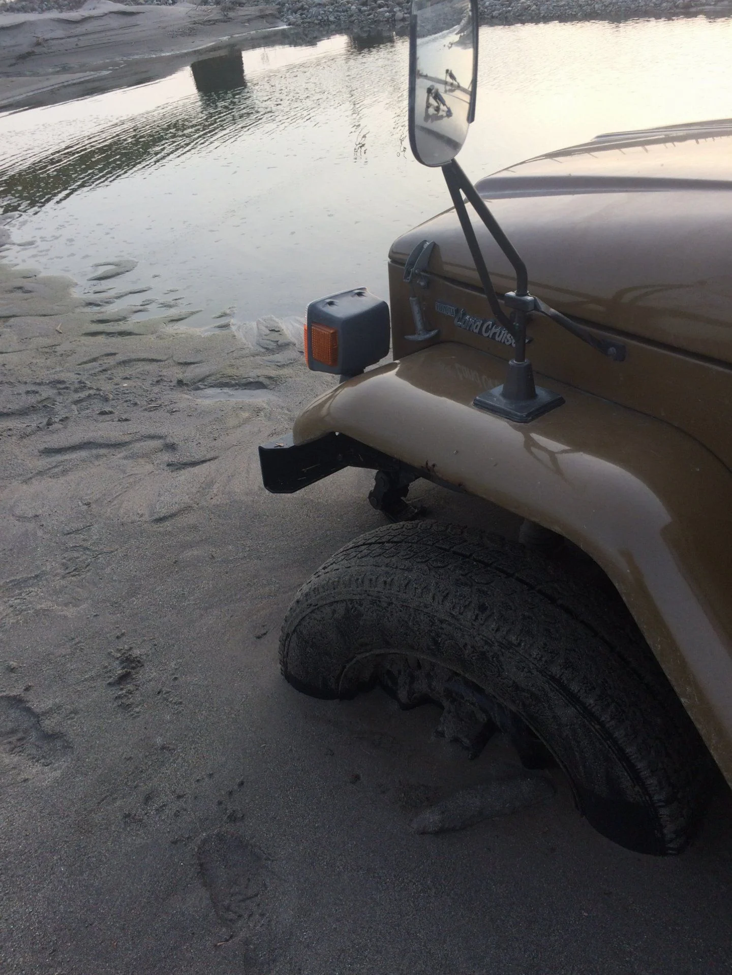

I decided to take a quick trip down to the river on the way home. Well it turned out not to be so quick as is often the case I suppose. After finding a way around obstacles that were supposed to keep me from getting down to the river and doing a good run around on all the river rocks I decided to cross over this innocuous pile of sand.
Well I crossed over on the sand and started to sink in immediately stopped. Just the vibration from my little mighty 3b liquefied the sand underneath the truck just like when you vibrate concrete. The truck just sank down so I immediately killed the engine but I was already down below the axles. The right side was down even further to the rocker. I stepped out of the truck and my boot just sank. But after a minute the sand re-solidified and you could easily walk on it. Just look at the the front shackles and you can tell what I'm involved in.
I've been stuck down to the floor in mud. But I don't think I've ever been quite this stuck. It doesn't look so bad but that quicksand is heavy stuff.

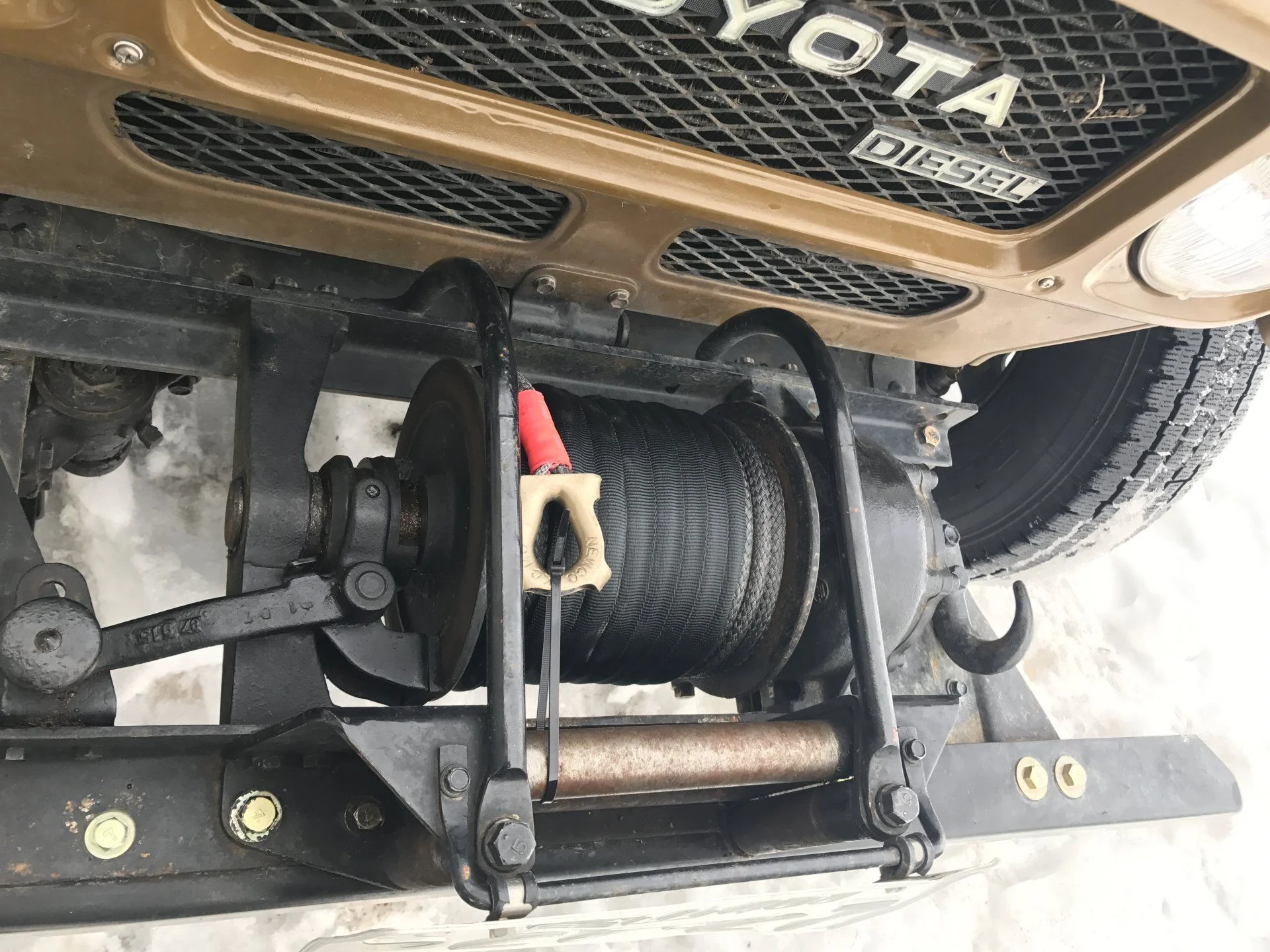

Oem Pto winch with 70 series winch 5mm shear pin.

I was also concerned that even with the double line the shear pin would go- but that was not the case.

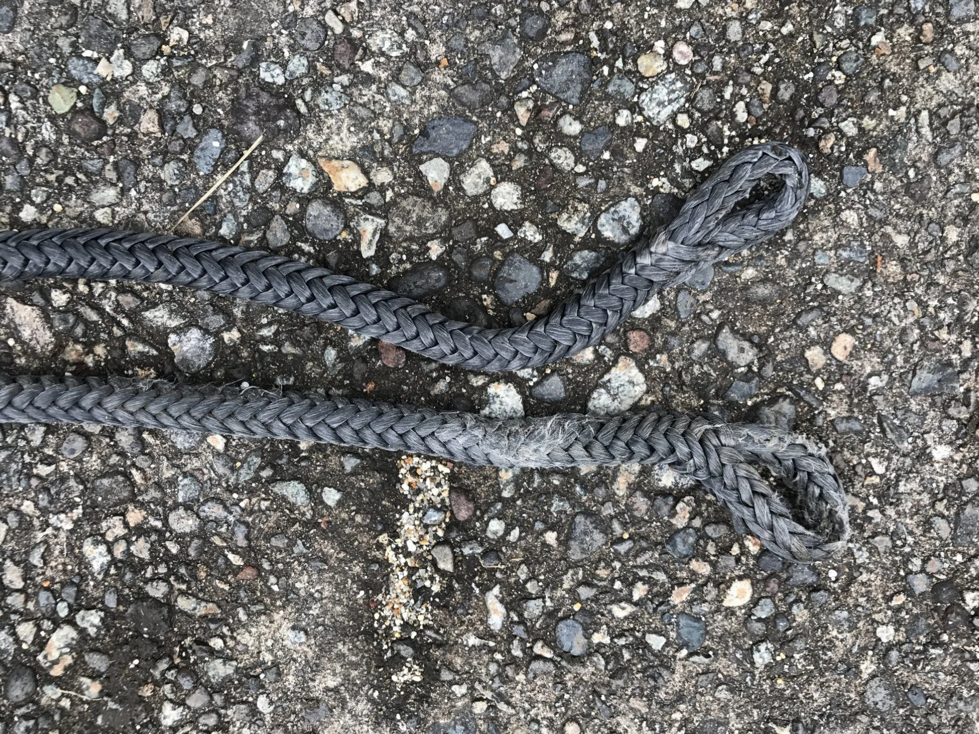

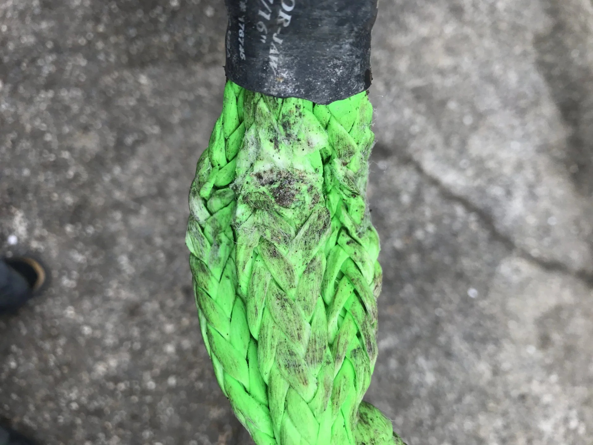

Another concern was that I had forgotten to put my three-quarter inch shackle in my bag. The pulley has sharp edges and I was concerned that it might cut the soft shackle.
I put the thickest part of the shackle against the sharp edges of the pulley. This saw the full weight I'd the pull and actually faired well
The lower shackle aldo saw the full load while the upper saw half as it was on one end of the double line. I'm not sure how much the strength has been affected but you can see that it has frayed visibly from the stress and it's stiffer than the other shackle as well. Both the green and the second gray saw the same load and the construction of the green shackle is easier to lock than the grey one after stress. The green shackle also has less fraying however it shows color loss in some of the stressed areas.
One thing that worked well was having no thimbles on one of the ropes. The second pillar was in the river- and its damn cold. I was able to toss out one end of the 100' extension then throw another rope over it as it floated by and pull it in to shore.
The line on the winch is sheathed or overbraided to help prevent abrasion and wear. I think this is a good investment after pulling it through a load of sand and the pulley.

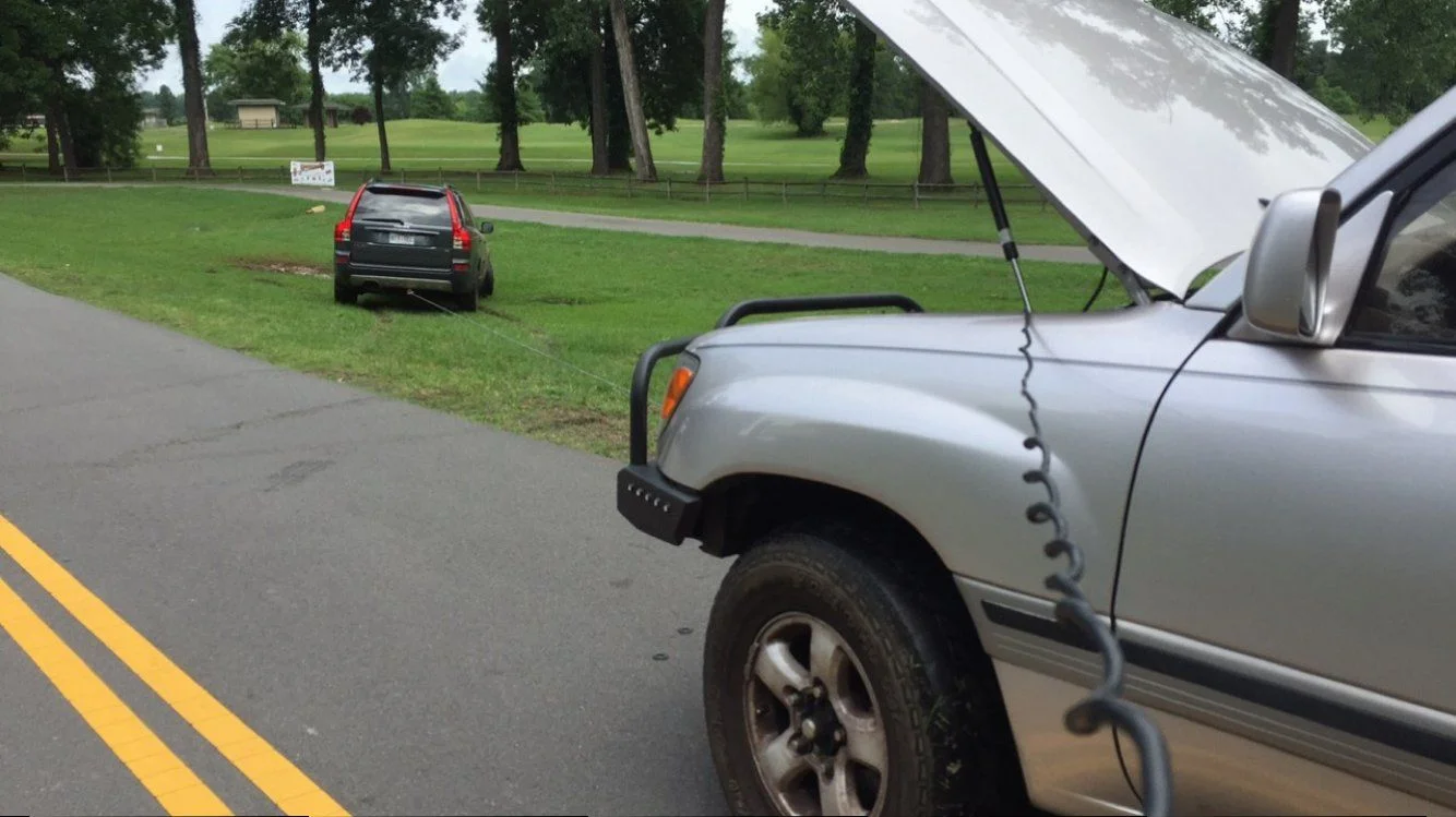

I guess this is a success not a fail.Well i should say the recovery was a success. Me getting stuck right on the side of the road was a FAIL!!!Nothing at all special, just a straight pull. Only trick parts was almost running out of line. First anchor was close but too much of an angle, up a hill and hard tot he right. i think it would have tipped the truck. The final anchor point needed tree saver and snatch straps used as extension and was down to the last wrap on the drum. I will be investing in some type of extension in the near future.
That's weird, it looks like there is a perfectly good road behind you ! Were you avoiding something ?
