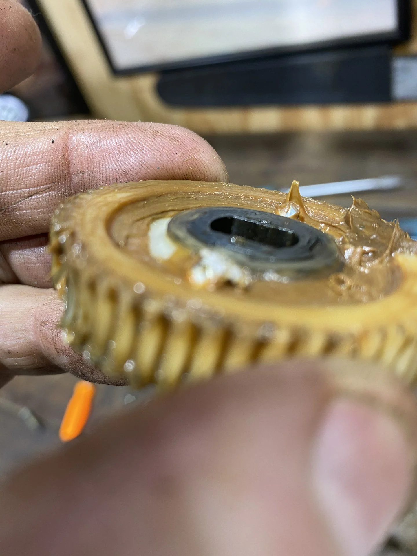

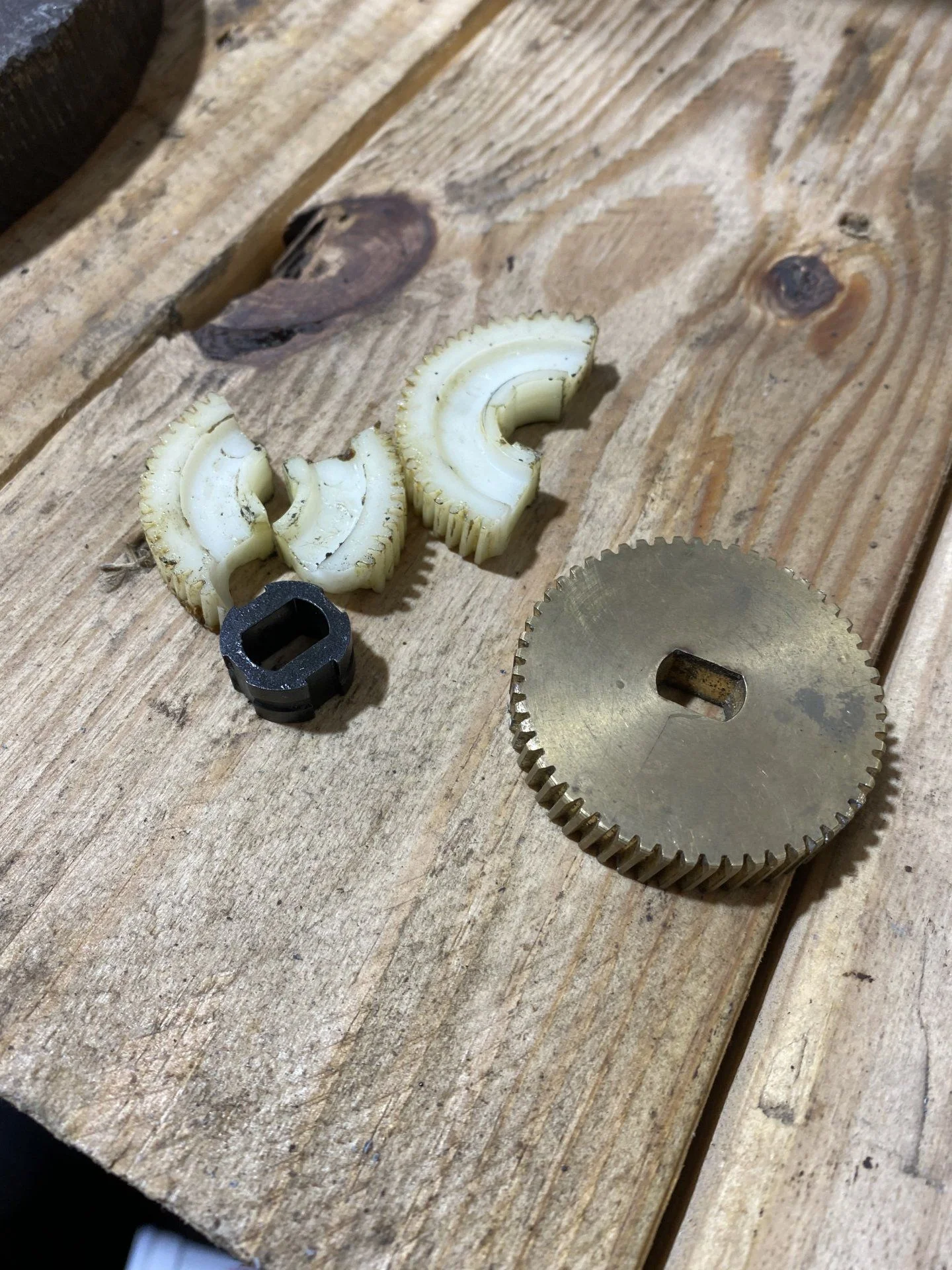

if you have a brass gear cut.
See the valley in the plastic gear?
The SOR gear does not have it and when you tighten up the cover the ridge goes into the gear to bind it up.
I’m going to flap disc the ridge off the cover but new gears need the valley

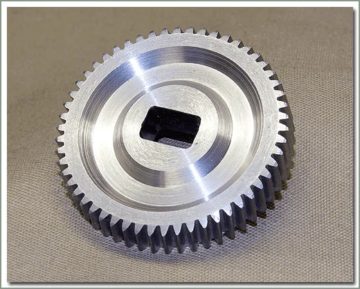

Au contraire. The SOR gears do have the groove: Land Cruiser Rear Tail Gate Door 55 Series - https://www.sor.com/cat138.sor#138-18
Pretty sure the gear you posted is a batch that someone else ran before I bought my pig. IIRC @J Mack machined some of them down for himself and others. But for sure you are correct; you need the groove to clear the cover.
