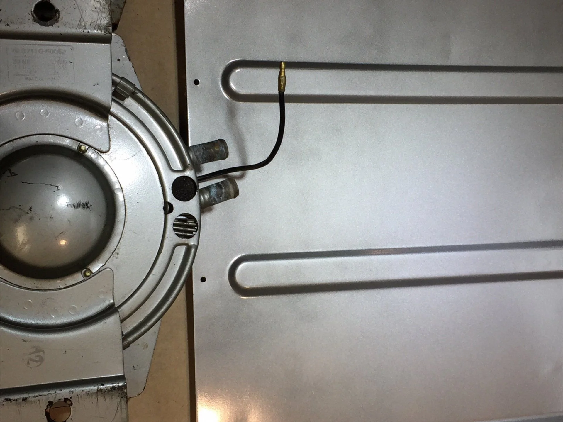

Well, it just so happens I have a 76 rear heater that is in decent condition. I also have freshly painted seat parts using T145. My eyeballs do see a more greenish/yellowish tint to the heater color. I also included my rusty 71 heater. And I imagine fresh cans of T145 could come out different depending who mixes it, yada, yada.

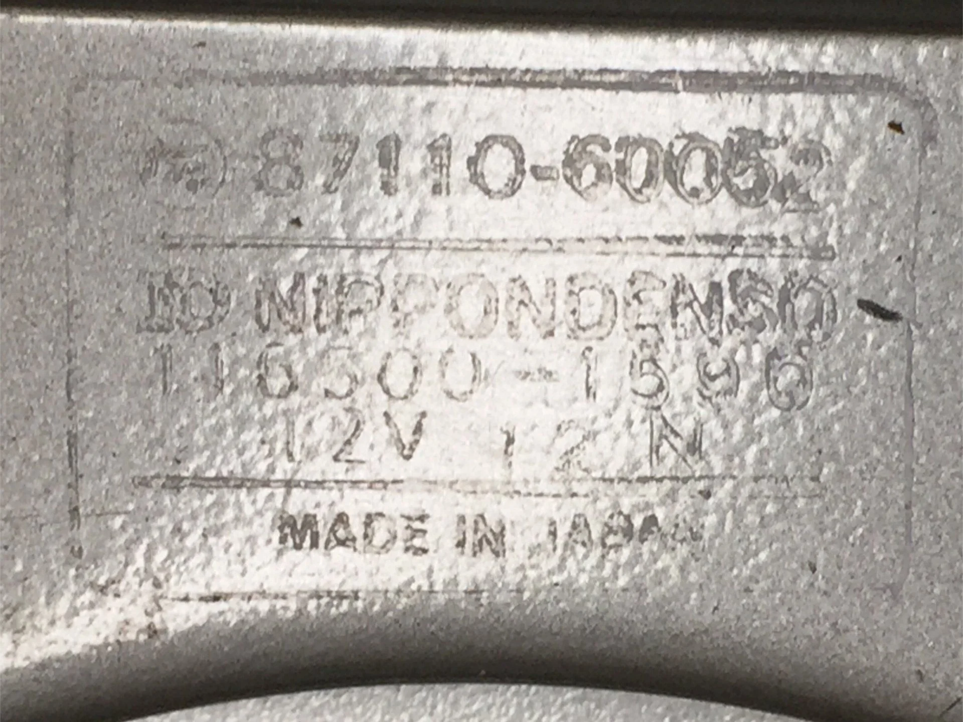

The factory stamp:)
Great pics Red Rocker. I think you are right about the color variations. Thanks!
I also wonder if the old paint has yellowed any? In the first pic, I shined a bright light and the colors seemed a closer match. Perhaps @Living in the Past might remember what the gray paint looked like when these rigs were closer to new. The grey on my 71 is "dappled", as if the darker particles didn't evenly mix with the lighter paint particles. The 76 paint is a more even blend of color.
