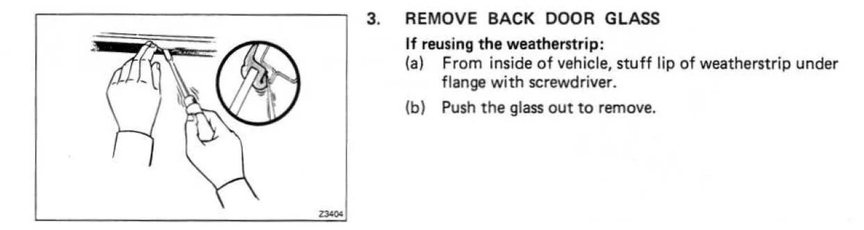

No need to overthink it. Here's what the FSM has to say:
If you're not reusing the weatherstrip, the manual just says to cut the outside lip and pull the glass out.
