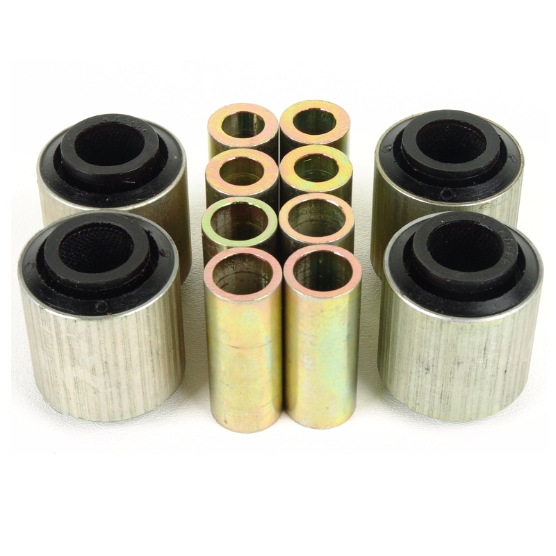

Can you clarify what's in the "kit"?
"KIT097K - Trailing Arm & Panhard Rod Kit (for the Rear only) Kit Contents: - Trailing Arm Lower Bushing All, 2 Bushings,2 Inner Tubes x 2; - Trailing Arm Lower Bushing All, 2 Bushings,2 Inner Tubes x 2; - Panhard Rod Bushing, 2 Bushings,2 Inner Tubes x 1."
$225 for about 6 bushings seems atrocious if I'm reading the website correctly (quote above). Maybe I'm not understanding what's really in the kit. Can you help?
Hello, I have just saw your question.
First let me state that the current price both on eBay and our online store for this kit is $189.99 not including shipping and handling.
Second, SuperPro Bushings are considered to be the best polyurethane bushings in the 4x4 after market. More information about SuperPro you you can find in the following link:
www.superpro.com.au
Third, other memebers in this forum who have purchsed bushings from us stated that the bushings are performing better than the OEM or other poly bush they have used before.
Fourth, There is a mistake in the description though.
The kit includes the following:
SPF2464K x 1 - Panhard Rod Bushings 14mm bolt 2 Bushings,2 Inner Tubes
SPF2460K x 2 - Trailing Arm Lower Bushing 2 Bushings,2 Inner Tubes
SPF2461K x 2 - Trailing Arm Upper Bushing 2 Bushings,2 Inner Tubes
We hope that we have adressed all you concerns. Please feel free to contact us with any question.
Best regards,
OBT Sales Team.
