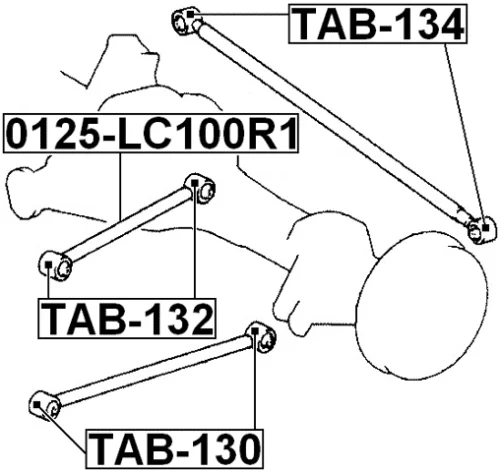

I might just go FEBEST all around, they have bushings for all pieces and yes, upper arms can be purchased ready.
Even if they going to last 1/2 of OE - works for me. Will be considerable savings. Like $150(FEBEST) vs $500 OE
Anybody had BAD experience with FEBEST?

I did all of mine and they worked great. These are Toyota bushes that are compatible, which is to say they're from a 200 series or GX or something. There is no official part number in the diagrams for the 100 series so this is the only option without going aftermarket or whole new arms. Whether the rubber is slightly different I cannot say, but their dimensions are exact and they work well for me.
Rears Arms:
4870260110 x4 lower
4870260090 x4 upper
4870660060 x2 panhard
Rears Arms:
4870260110 x4 lower
4870260090 x4 upper
