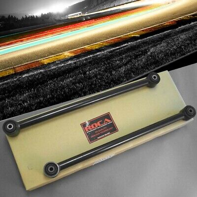

Anyone ever heard or used these? Two arms for $100 is cheap!
@Beau I see Febest and Rocar as 3-5 yr bushings . I see OE bushings as 20 yr bushings. You make choices based on usage.
Totally understand, but your reasoning is totally anecdotal, which is why I was asking for those who have actually used these items. Febest are a little more established and appear to have pretty good reviews across the board.

@beaas Febest has only been a company since 2008. I'm sure there are a lot of Toyota bushings still used that are older than that company. :)
I could see using aftermarket bushings when the application is fixed, like a differential or steering rack bushing. But with the rear control arms, the bushing is asked to twist constantly. It doesn't even spin.
I can believe there are a lot of positive reviews because they probably fit well and solved their issue for the time being. How many positive reviews are for bushings that are older than 5 years and used in the manner as the rear control arm bushings?
