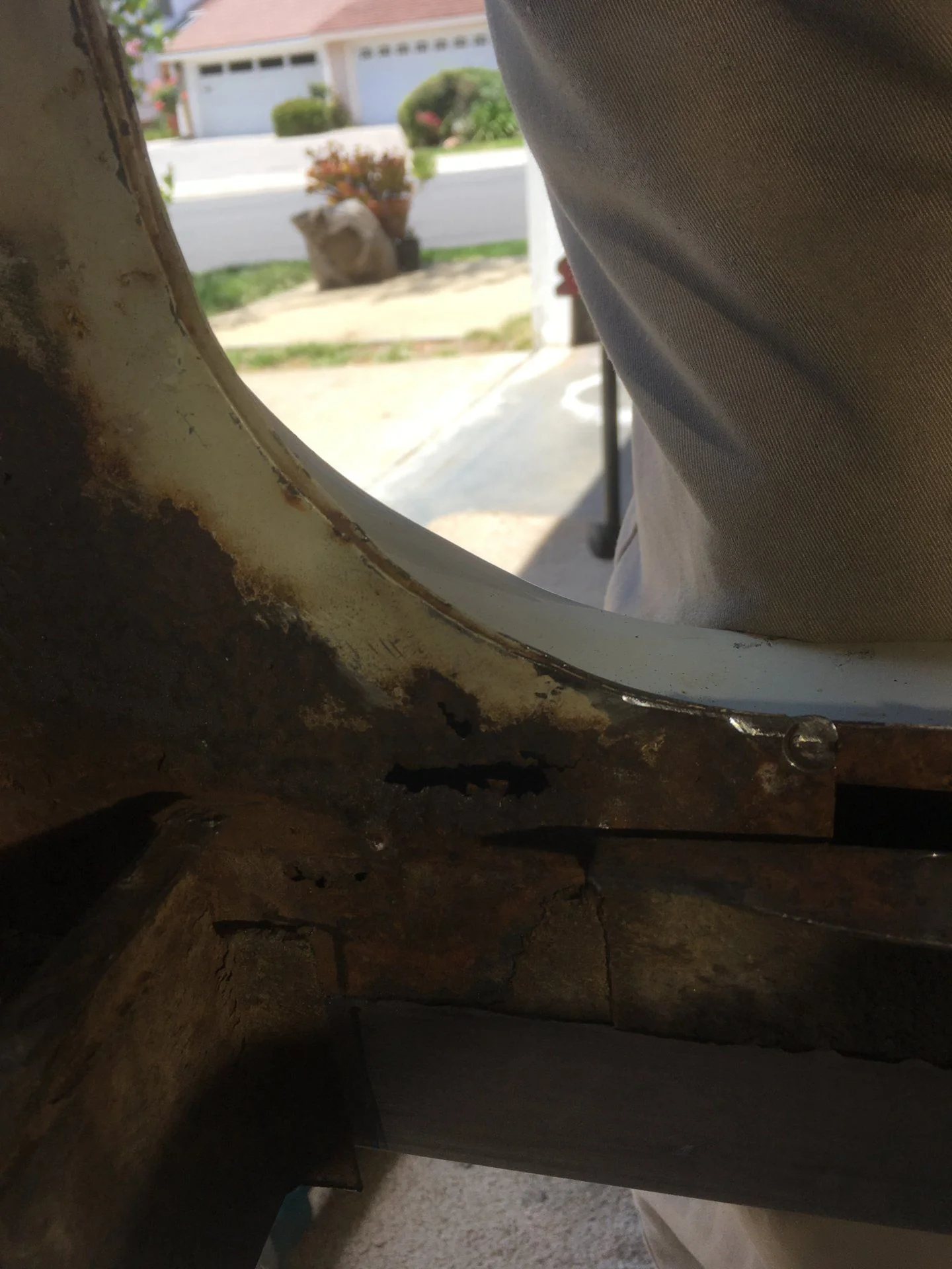

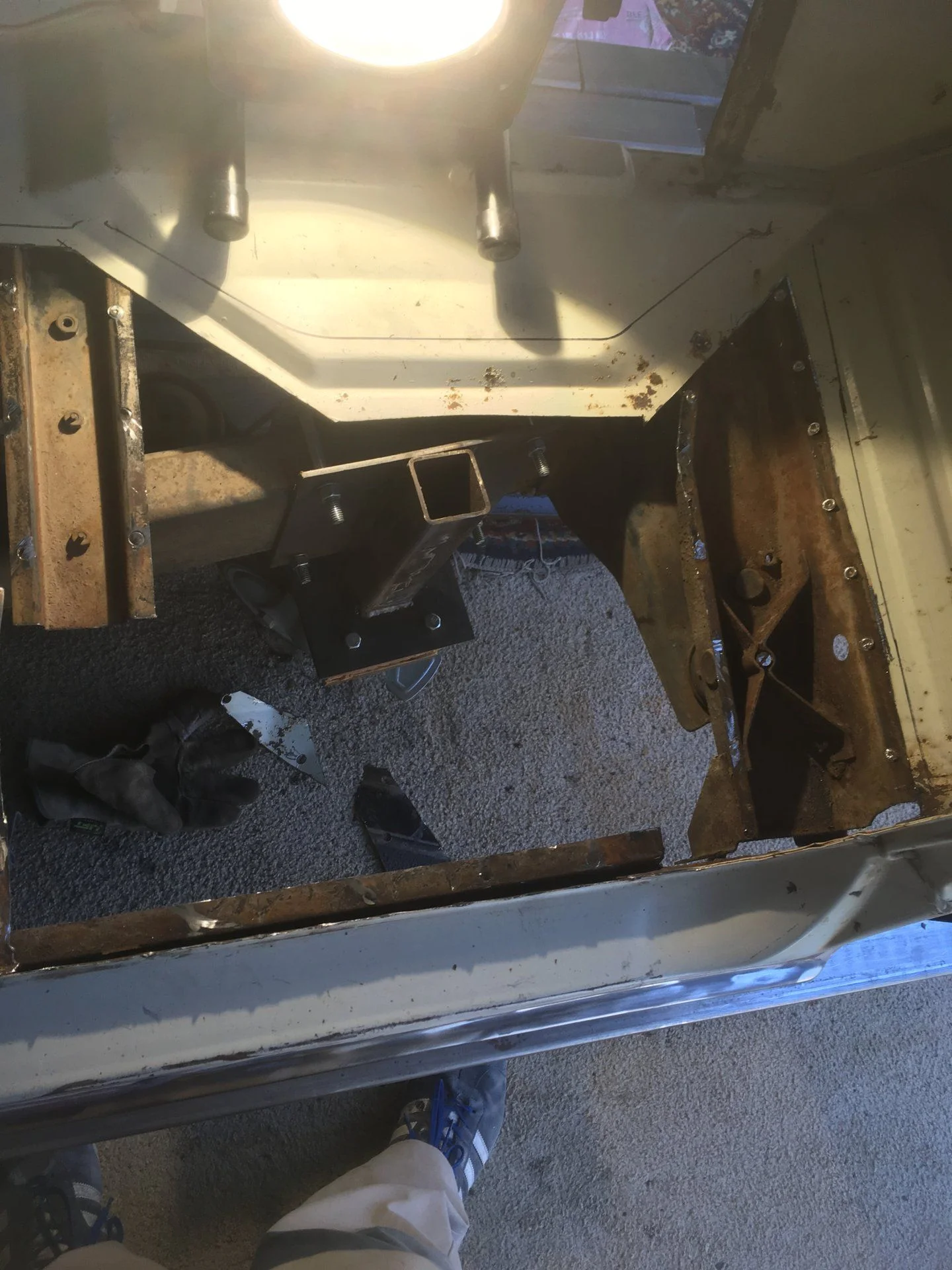

I have a little surface rust on them. I imagine that a lite sandblast will be enough to take care of that!
I have been dreaming of the day I would be using these things. Stoked!

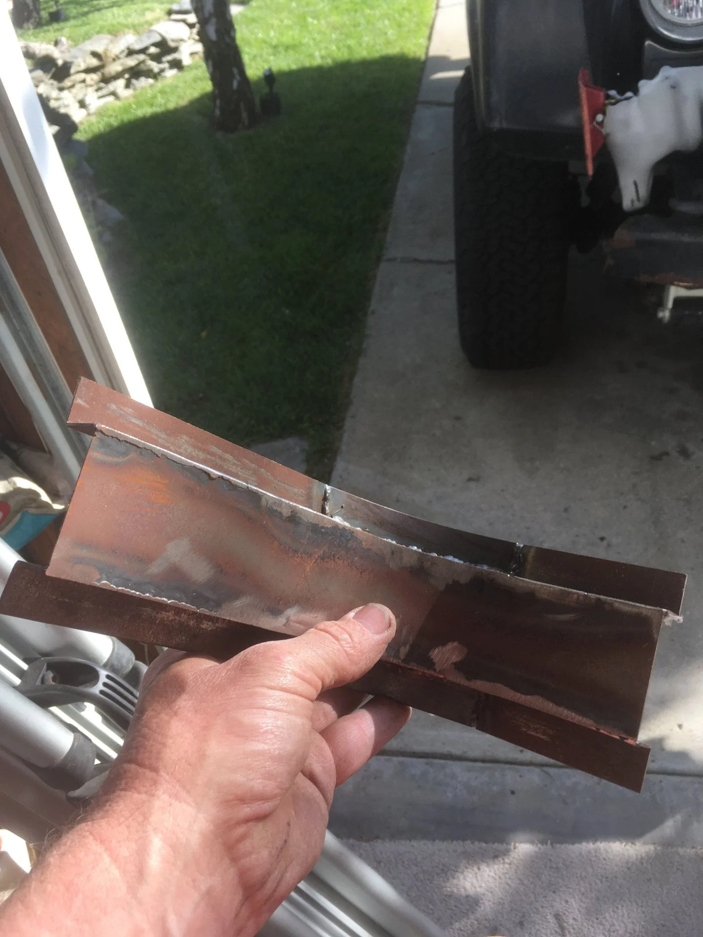

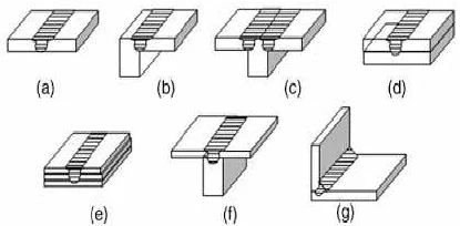

Ignorance abounds! What’s a doubler?
A backing plate to weld to.
Best photo I could find, if you look at "A" that is a "Square Butt Weld" what I'm saying I would do to make that joint easier to weld is add a third piece of steel on the inside to form "D" a "Lap Joint"
Hope this helps my crappy first description.

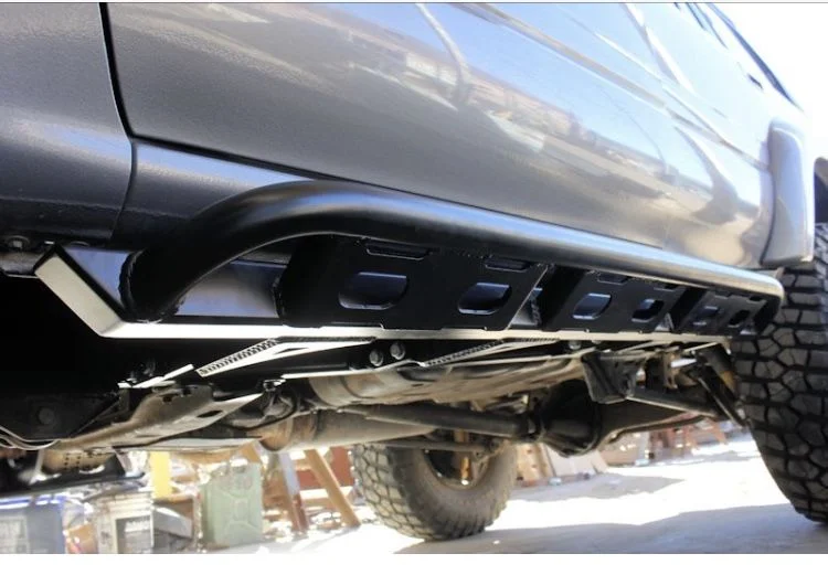

Just came across this company local to me for the “DIY” or “Martha” in you.
@TRAIL TAILOR has some sick “Landcruiser” tread plates. I wonder if those can be ordered a la cart.
Or just order the whole slider from him 😁🤘
Nookshnear you are always hookin me up! Still stoked on the white knuckle affair.
On my original the 4x4 that is on the above picture, I extended it to the front of the fender. Meaning I cut the fender. The reason I go into this is because I saw those two tabs to stabilize the bottom of your fender a long time ago! Haha I LOVE PICS. Thanks! Those two tabs are on my original and, as well, will be on this project.
