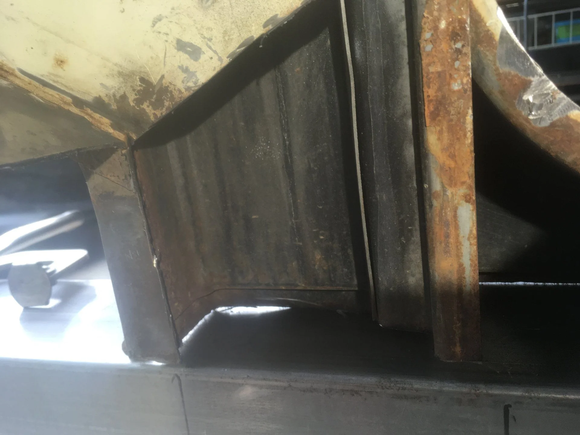

rear body mounts
What ya’ll think about an overlap tack welded seam vs running a bead the whole seam?

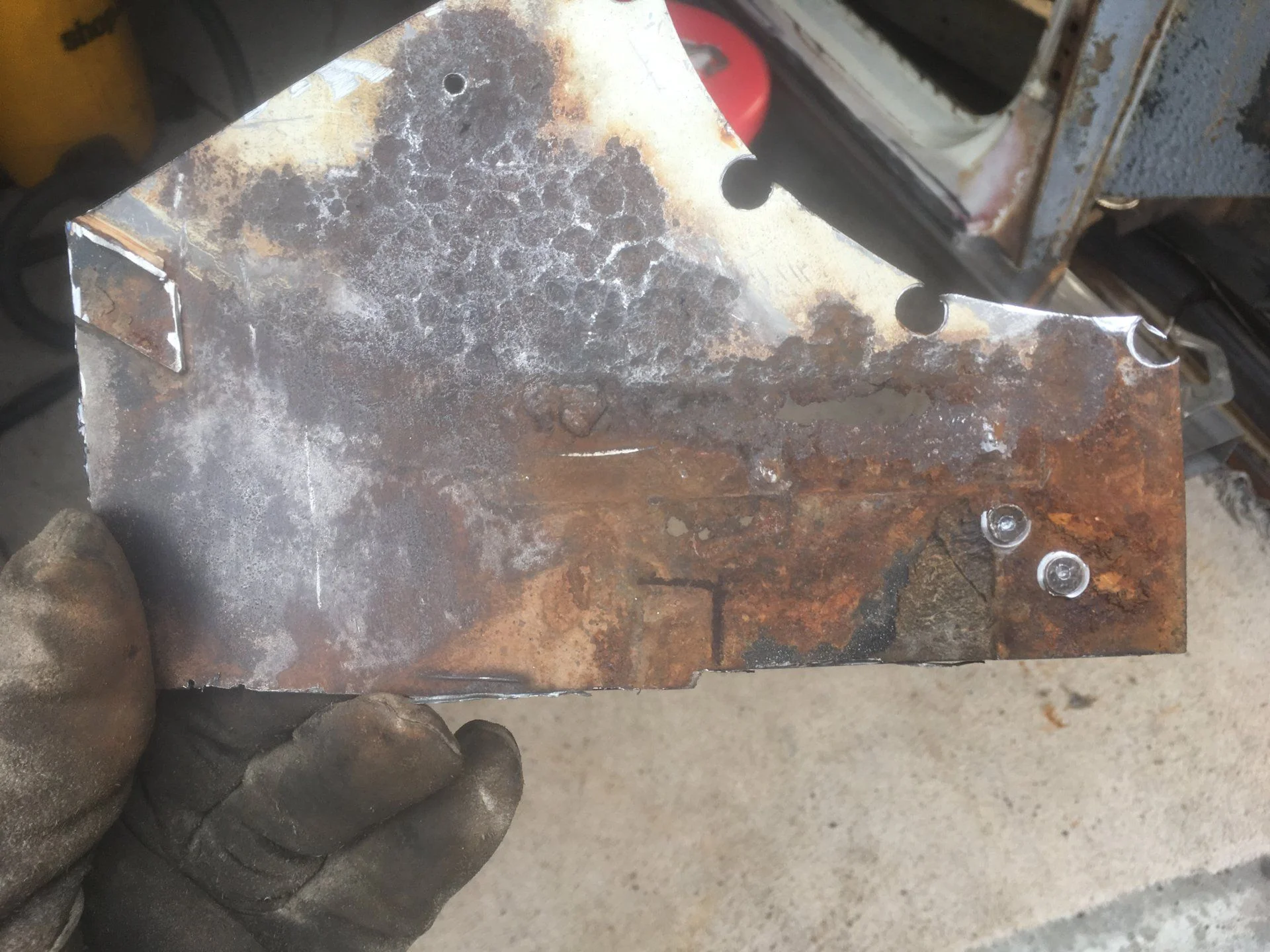

I am dealing with a ton of tack welds and am wondering if it was an economy thing or something like flexing. It surely seems as though all the rust areas are an overlapped tack welded seam.
Why butt weld over creating a flanged overlap? Especially if inside of flanged overlap is accessible.

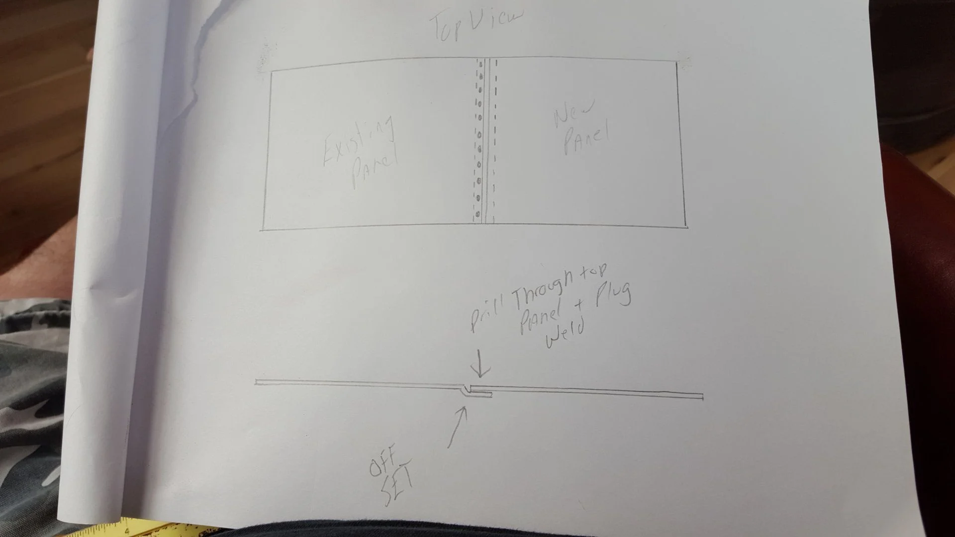

Other option is an offset then you can just spotweld in a few places as opposed to welding entire seam.
Agree spot weld or plug weld if using a mig on an overlap joint is the fastest best way to repair, for me creating the "offset or flange" to form the overlap without using rolling dies is hit and miss. I've tried the hand held pneumatic type and vice-grip type and both have worked but distort the panel almost causing more work than they save. I find if I'm doing a repair like @xtiaan2000 on the under side is doing on his rocker if I plug or spot weld a backer plate to the inside to form the flange it saves me time and looks better.
