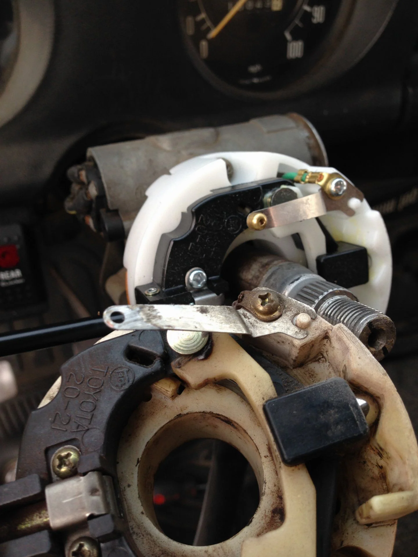

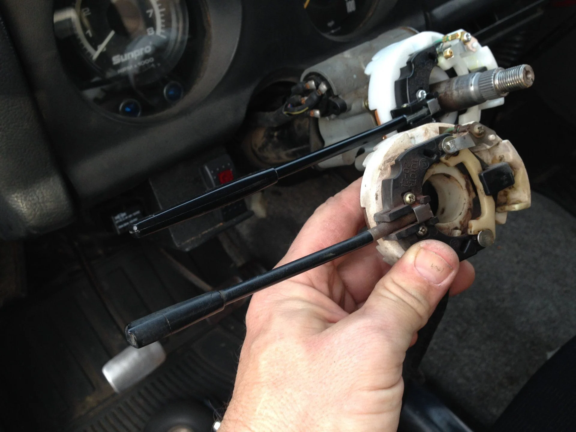

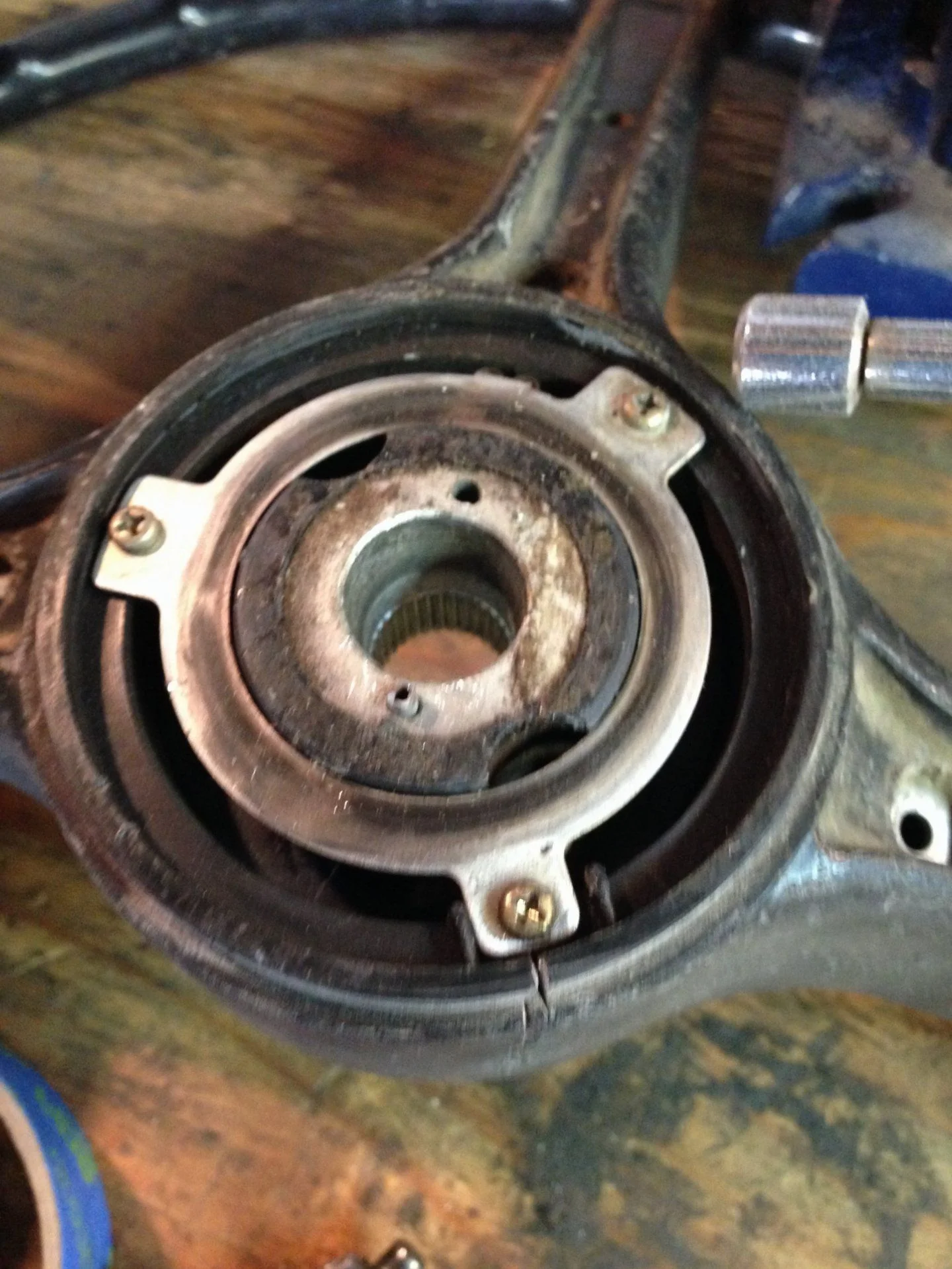

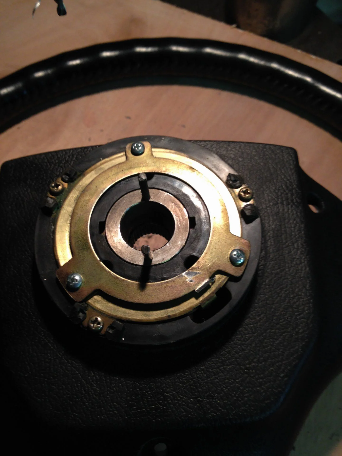

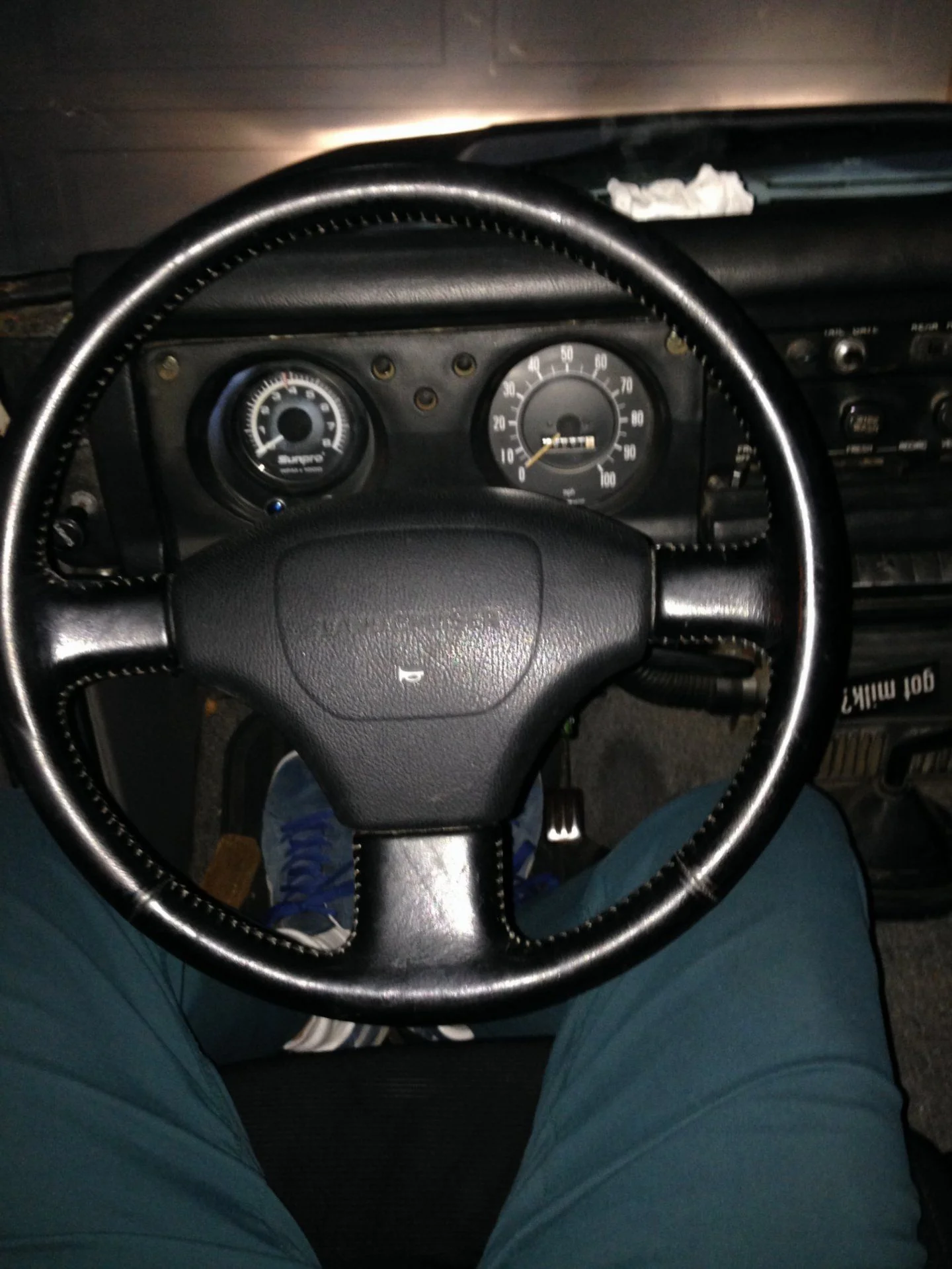

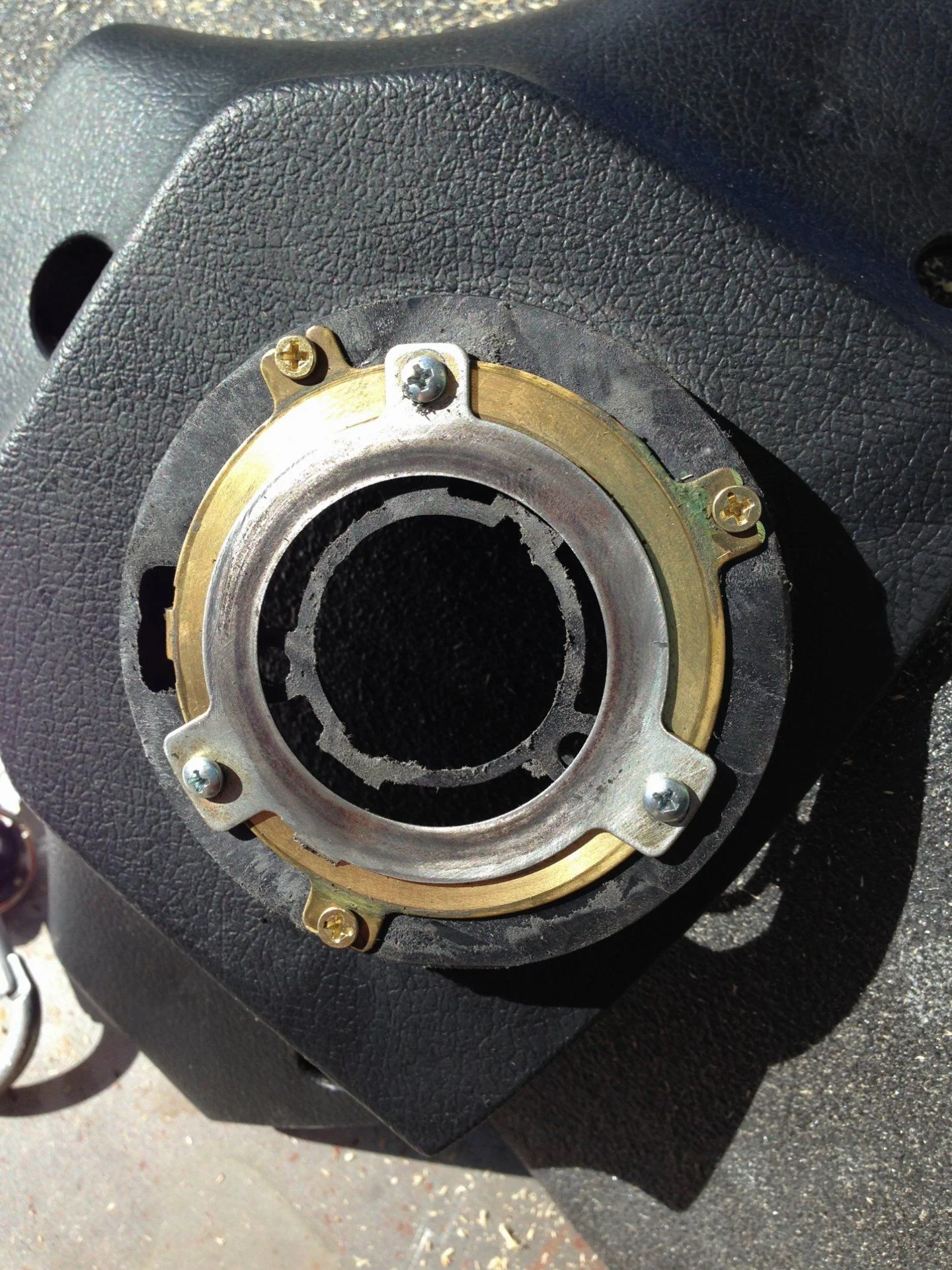

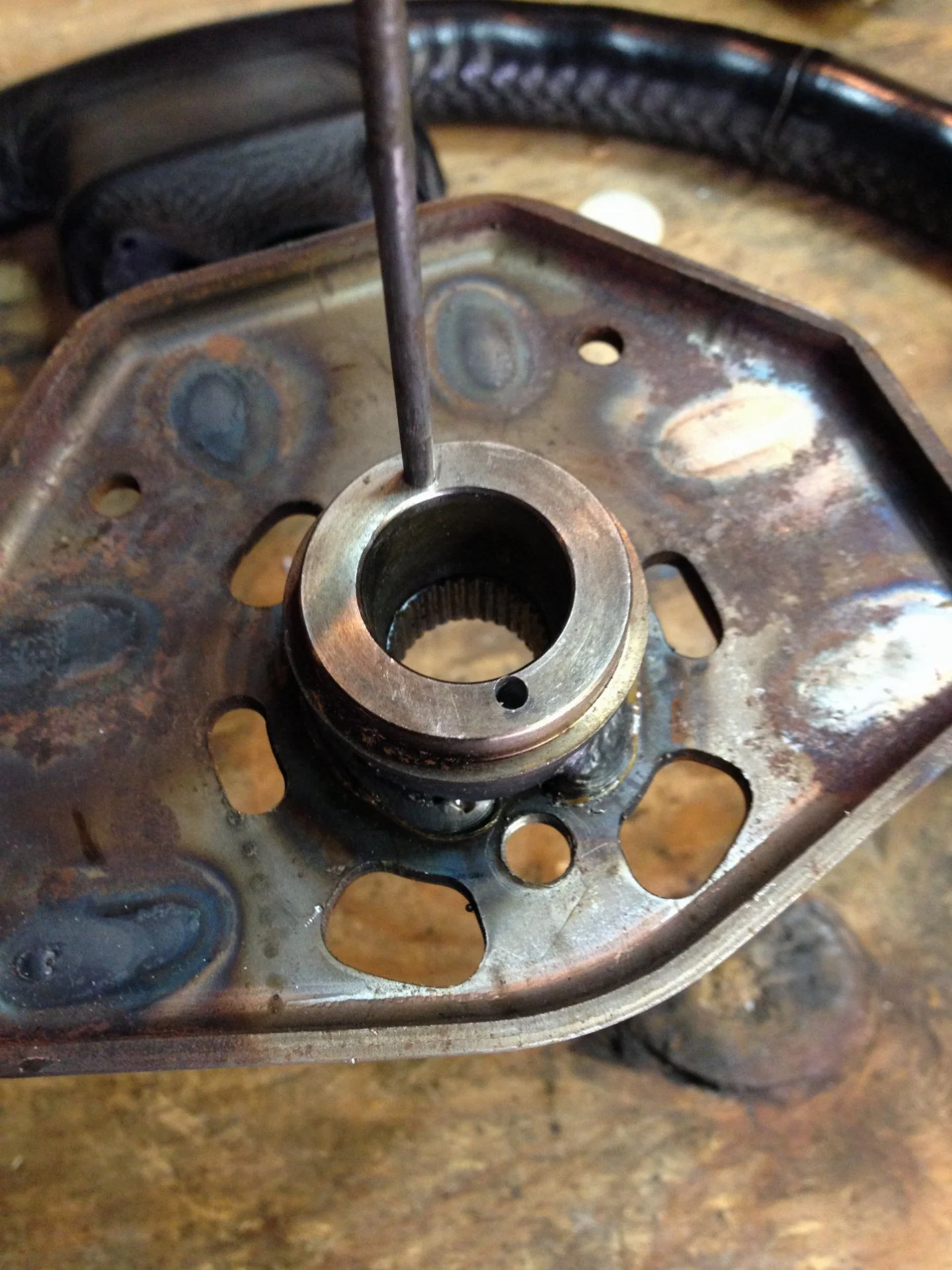

Put on a fj80 steering wheel. Pretty stoked. It is smaller, feels cooler, and, I think, looks great! When driving down the freeway the steering has alot of play. So now the movement is minimized with a smaller diameter wheel. Had to do a little grinding, drilling, and such, but now I have blinkers and horn and am on my way! Oh, as well, got a new blinker assembly too. Way better then the 42 year old version. Funny the little "horn glide' was non existent and not having the notches on the plastic makes the action like butter!
