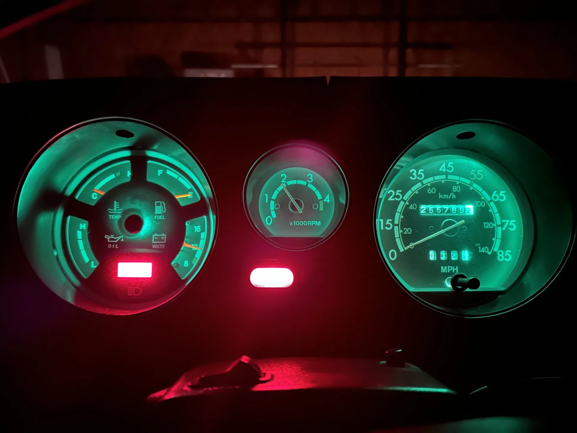

Old thread, but I’m glad I found it. The .25 cent solution worked wonders for me tonight. I may try to get a new dimmer to swap out but the led bulbs I installed aren’t overly bright anyway.
Now to get the tach and other gauges to actually work…
