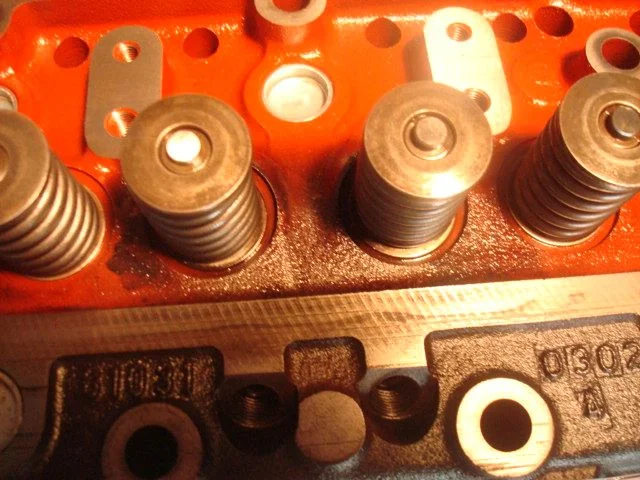

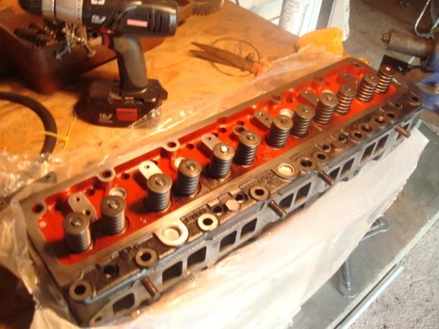

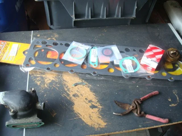

Got my head back- milled with all new springs, a new valve and seat and new gaskets. The head cost $380 and the SOR gaskets and thermostat cost about $130. That sound about right for the head?
Turns out after getting it tested the radiator was fine and good to go.:D And the thermostate housing turned out to be good enough. Got this new style exahust manifold gasket. It feels like cork.:meh:

I'm not up on current pricing, but that good to me. Looks good, too.
