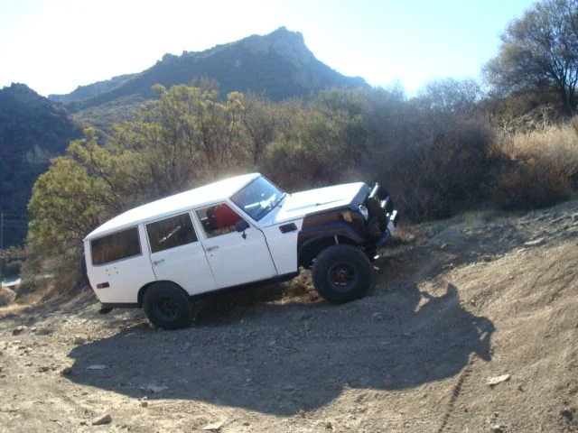

Some mellow messin around. There is a little touch with the driver side shock and the box, when I try to bury the front drivers tire, but I don't think that it will be a problem. :meh:

you're already on a 60 series front axle, right? would some 1/4 or 3/8" spacer help the rubbage? I have always thought that some old-too-thin-to-use rotors could be best used to make 3/8" spacer from...I salute you:cheers: but have to ask what you're going to do for off the rock upper arm excersizes now that your pig doesn't provide it for you?

I have 62 knuckles out with spacers to clear the forerunner calipers. I have spacers but still the touch comes in with the shock tube hitting the box. With the front tire buried in the fender it just barely touches. I really don't know how I could fix it but by cutting and repositioning the shock bracket. Not going there:flipoff2:
