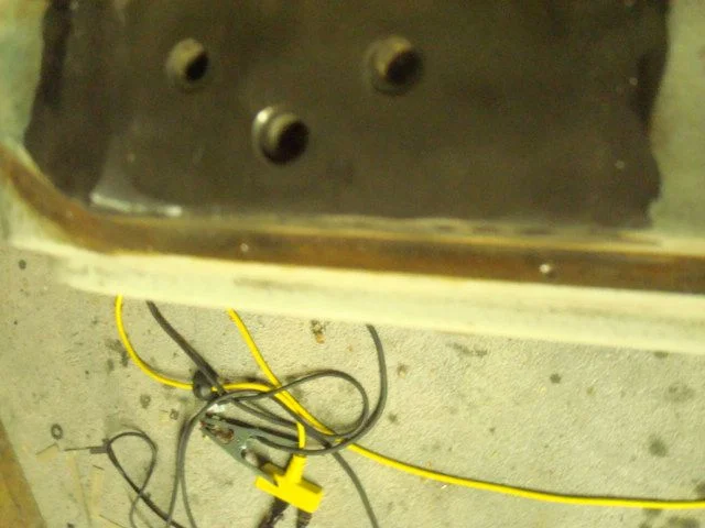

rear body mounts

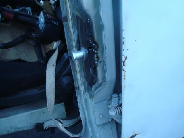

Also did some finishing work around the latch area.
Pablo-the stricker is tacked in the place where it should work. At least it works as is now. I will make sure before but I plan to box the area in after everything is refit. You know I will take pics for sure.

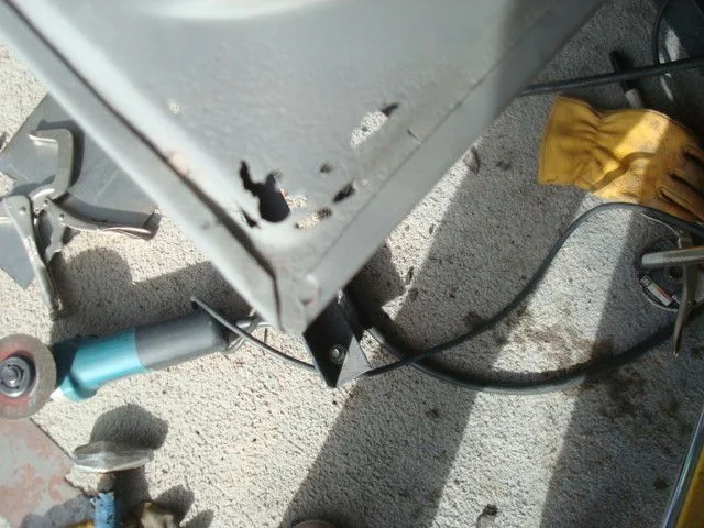

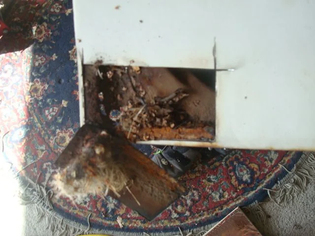

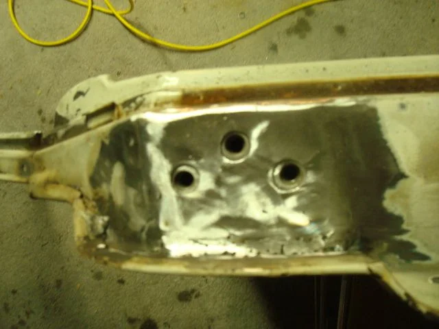

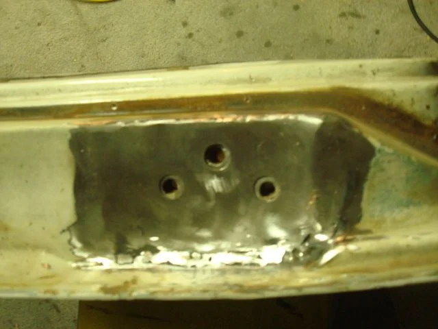

Got one of the door's hinge areas welded and ground down. Took off the door rubber channel and found supper rust. I am glad I took them off, when I get the doors sandblasted I won't ever think 'gosh, I wish that I had done that.'

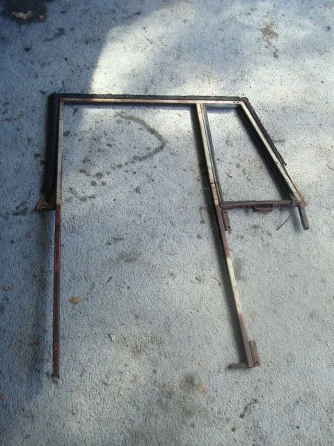

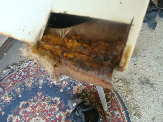

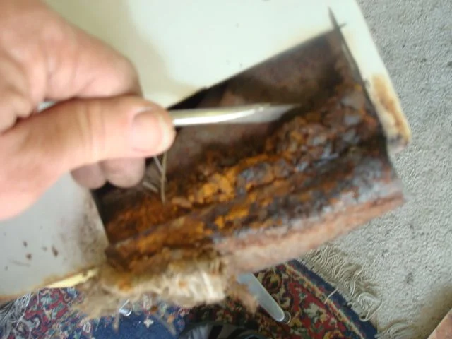

Well I got this from SOR and I guess that I will have to fab something that will work.
Unless someone out there has an old ratty door that they could cut the aft window channel out of. I have posted under two different titles in the classified to try and get some bites, to no avail.
Wouldn't new weatherstripping do this outward pushing you speak of?
yeah I keep forgetting how fat that bulb is on that trimseal stuff...I am using just a welt on the door opening and the rubber on the door; fagehtabbatit} my model varies...carryon
I found the window trax...pm me your addy

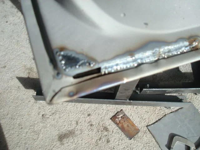

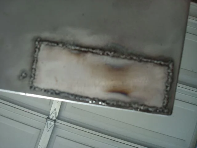

Got'em blasted and I worked on the corners that were kinda like swiss cheese. It is really cool how you can just cut a little out: patch it, and grind it and it looks cool.
Next I'm gonna por 15 the insides.
