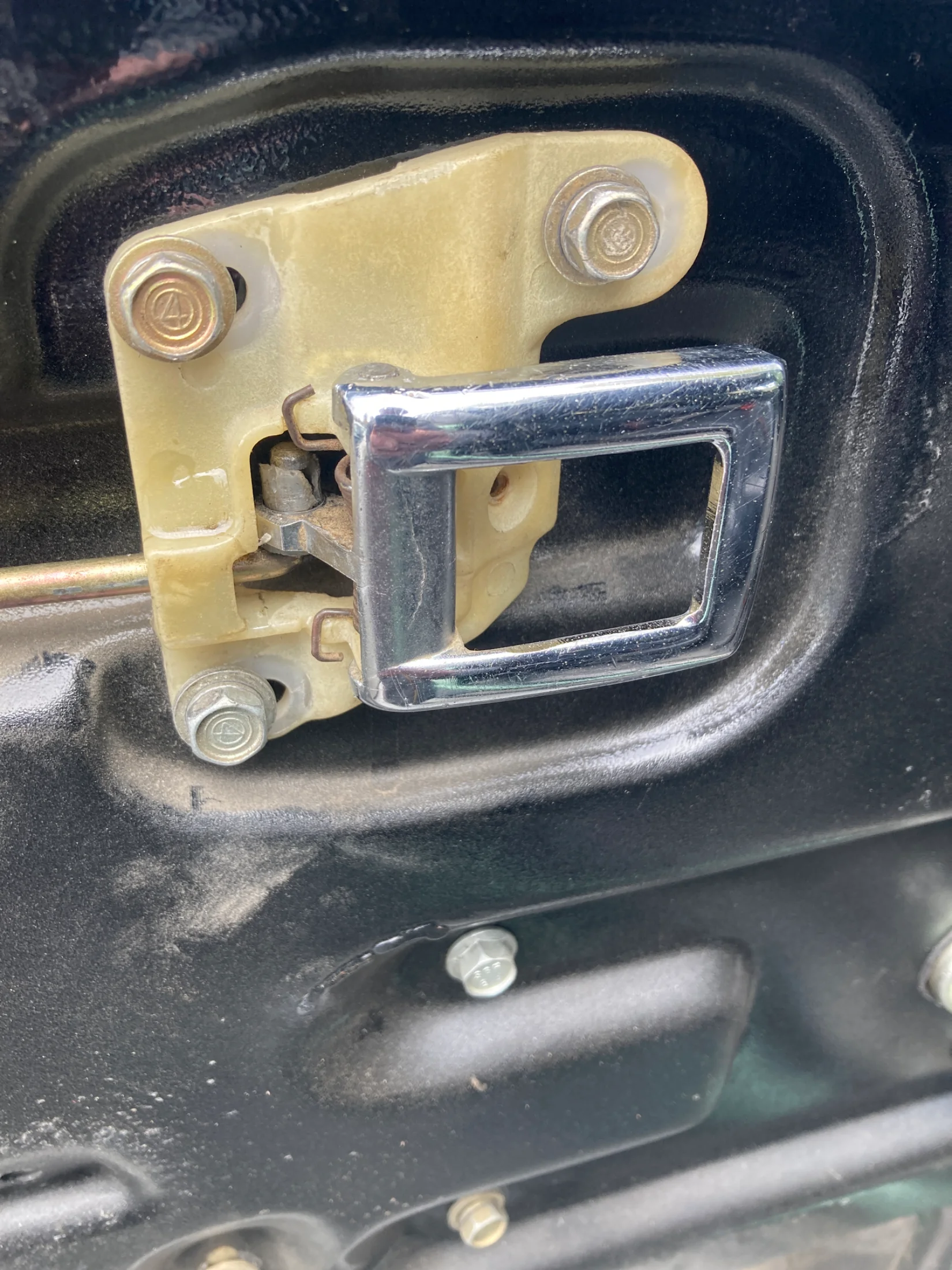

This hinge is causing havoc!
That rusted area is the amount that it can move. Which at the other end of the door!
Which makes it tough on my inner door components.
Just broke this guy out in Paniment. Fixed now, but the problem stil exists.
I think I sent these hinges to midgcanic back in the day. Anyone know if he is stil blessing us with that service?
Just two little bushings! I know Spector used to sell nylon versions. Maybe I have a set? But not as good as the metal ones. Bronze?
Out of town next week but may be able to help with new one when I get back. Got a few in stash I purchased.

Toss that hinge and start over. Do you have a good drill press and drill press vise? If not you will have no chance to drill that out correctly. FWIW I was able to reuse all my pins. That made the job a little simpler.
