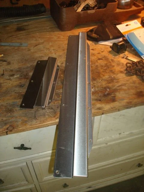

I am getting all sorts of things in the mail! I just got these KILLa Scuff plates from bobm, but I can only get one to fit cause my doors are all of kilter:frown:.

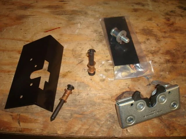

No worries I was planning on doing the doors- from the hinges to new latches (bear claw hoping I can get the locks to work as well), sand blasting to new felts and rubber. Then I can re-aline and access those scuff plates.

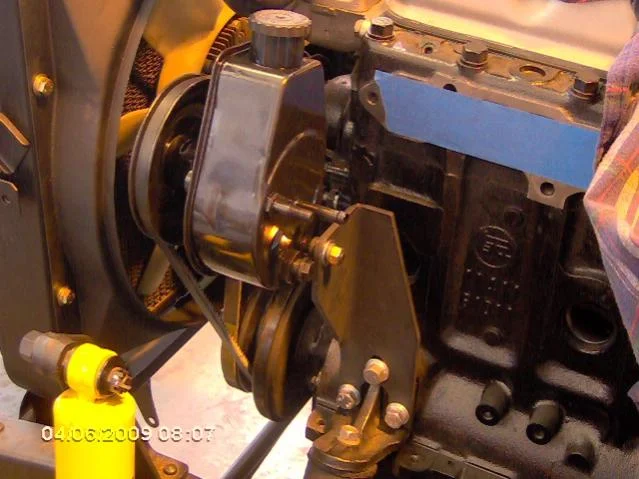

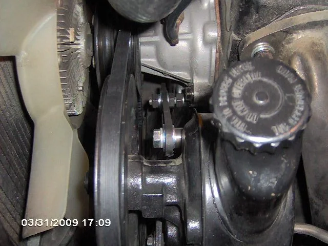

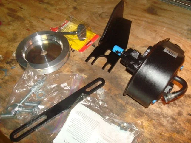

I am trying to get some ideas on the power steering pump bracket that I got from Orange45 and I don't see how it attaches. Anyone got a picture of how this thing goes on?
IIUC, you back the bolts out of the drivers side front motor mount brac on block and slip the Bill Dorey onto them. there are likely a couple of other shared bolts for tensioner(waterpump area) and whatnot. check in the 40-55 section at the top of the main page for install threads...

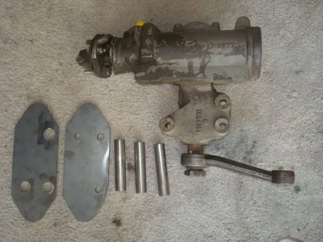

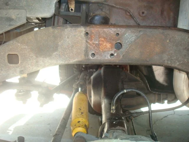

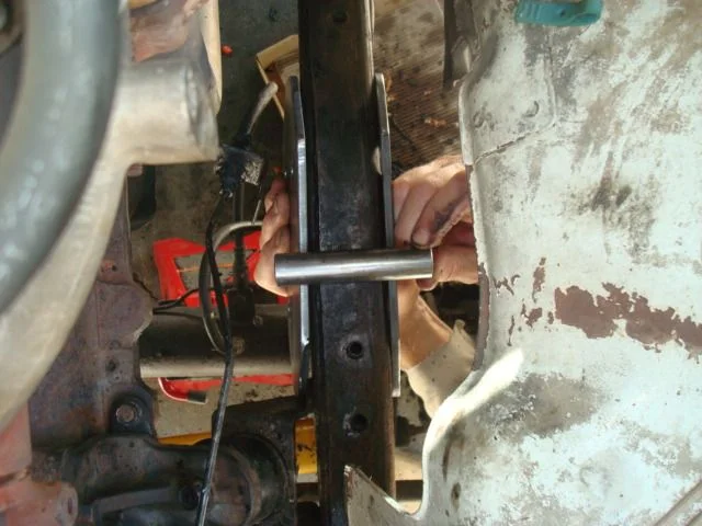

I am moving the box around and trying to figure out how this thing is going to fit. It seems as though for me to use the plates that will sandwich the frame, I will have to move the engine mount to be able to use the inside plate. I know that some have said that the did not have to do anything to the engine mount, but did you have a plate on the inside? I am using some plates that 4x4labs made for me.
Pighead, I saw somewhere a picture of your inside rail, but I can't seem to find it.

It also looks like the sleeves that they gave me are tooo long.:hhmm:
I have hollered out to the guys at 4x4labs but ya'll know that that can take some time getting back. Anyone got some suggestions in the meantime.

Xtiaan,
My Opinion: If the inside fish plate is a problem, either cut it down or don't use it. The DOM tubing will be plenty, since you won't be able to collapse or crack the frame with the tubing welded in.
Also, the tubing is too long, you will have to cut it. You want it flush with the fish plate or frame.

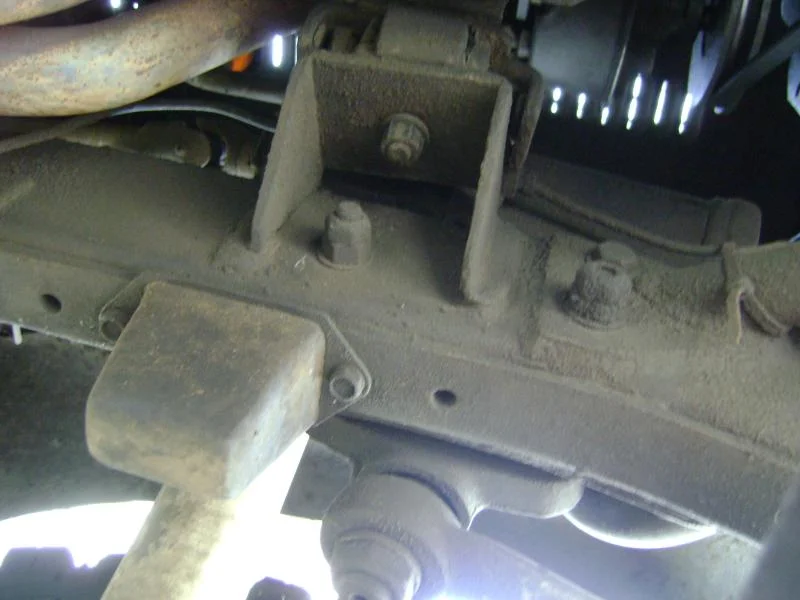

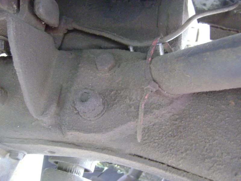

You did? I don't recall posting pics of my inside frame rail...let me drop everything and run outside to take some for you.

Those are the pictures I needed! Thanks Pighead. Never have to drop everything, but all the same I am stoked you did:cheers:!! By the way that flying piggy is pretty sick!
i think my pitman points straight ahead...
Geez, you couldn't pressure wash it first?
that's lookin a gift horse in tha mouf...I saw those an said to meself, "Me, your frame looks ok, stop frettin, look at what the Pigodd is runnin:hillbilly:" an then think about it...Why are these frames still so stout? cause of the protective grease layer left by the mighty F series engine what drives these beasts. So, think like your pig before you go posting about "make it cleaner":flipoff2::cheers:
My frame gross, too. Pighead just sounded so eager to help. I can't really talk, cuz when I was pounding the TREs out today I could hear random clumps of crap dropping on the driveway. The did a good scrape job before posting progress.
