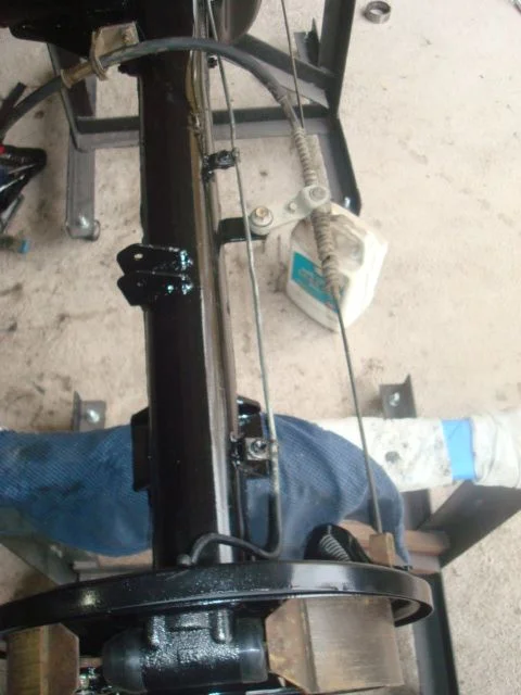

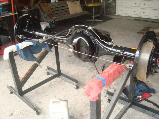

Got to get it back in and then just the ebrake setup left. Any glaring errors? Wish I could get that hard brake line perfect looking:meh:.
Anybody done the e brake thing before? Only thing that I think might be a problem is the cable length. It worked in the 60, it seems like it should be long enough.:hhmm:

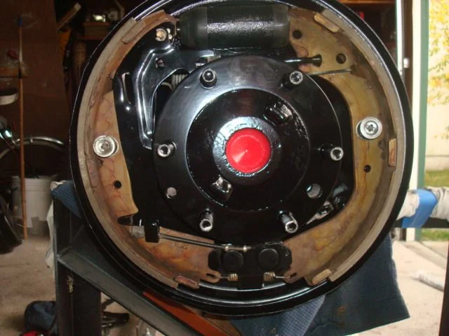

Look at your e-brake cable, inside the drum. Is it installed right, I can't tell. Here's a picture of mine, the two little knobs on the cable, should be set inbetween the pulley slots. If that makes sence.

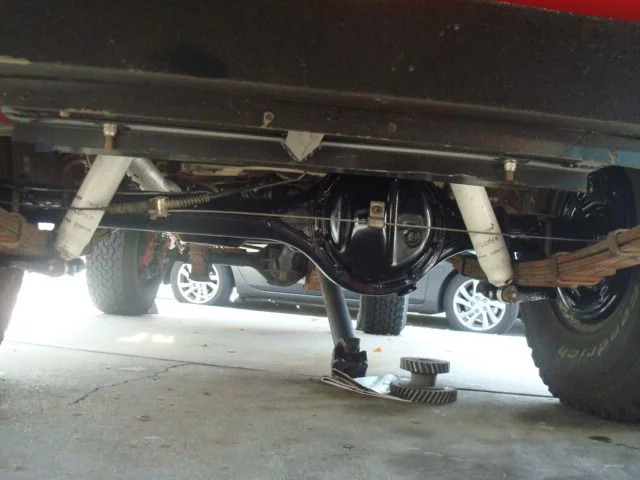

Got the tires on and think that I might be done. Still have to test drive. I have got to get the drive shaft on, but it has been recommended to torque the pinion flange bolt to 124 or so. I couldn't get the twrench to click. Seems like I didn't take that much to get it off. That is what is holding me back from the test drive.:confused:

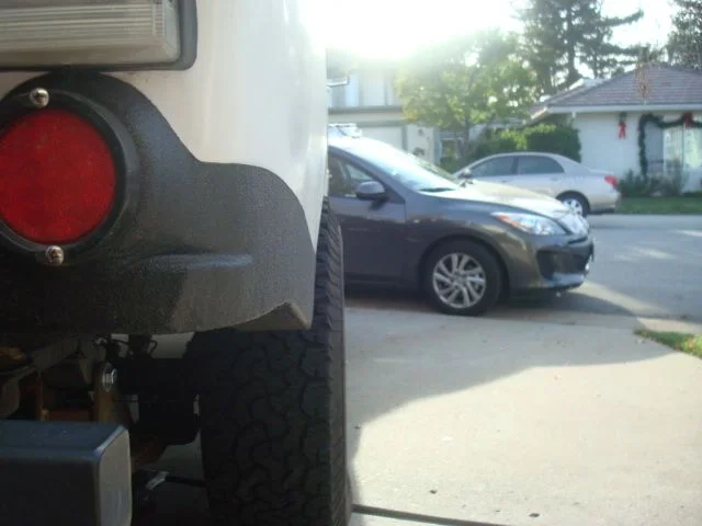

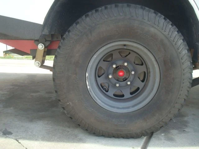

Pics. Got a shot of how far the tire extends out the side and others too
The ebrake is not as simple as I had hoped, but might not be too hard. First I am going to move the rear heater to the passenger side. Then it should go. I hope.

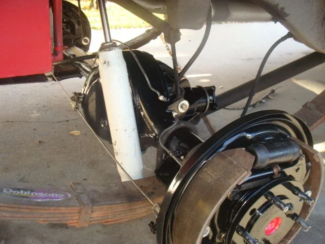

Does the parking brake cable rub the rear shock? It's looks so in the pic.

There is about an inch and a half space between the shock and cable. Yea, what a bummer to have to move the heater, but the 62 handle won't fit unless I do. Actually the handle looks to fit, it is the cable run that is the challenge. I seems like it should be no big deal to move the heater over to the passenger side. Tons of space over there.
Progress looks great, I am hoping that when I get on the freeway everything doesn't fall apart. Hopefully I got the pinion angle right.
I still haven't attached the driveshaft. It was recommended to torque it to 124lbs. Seems like that is alot. Any thoughts? Anybody?!!!
