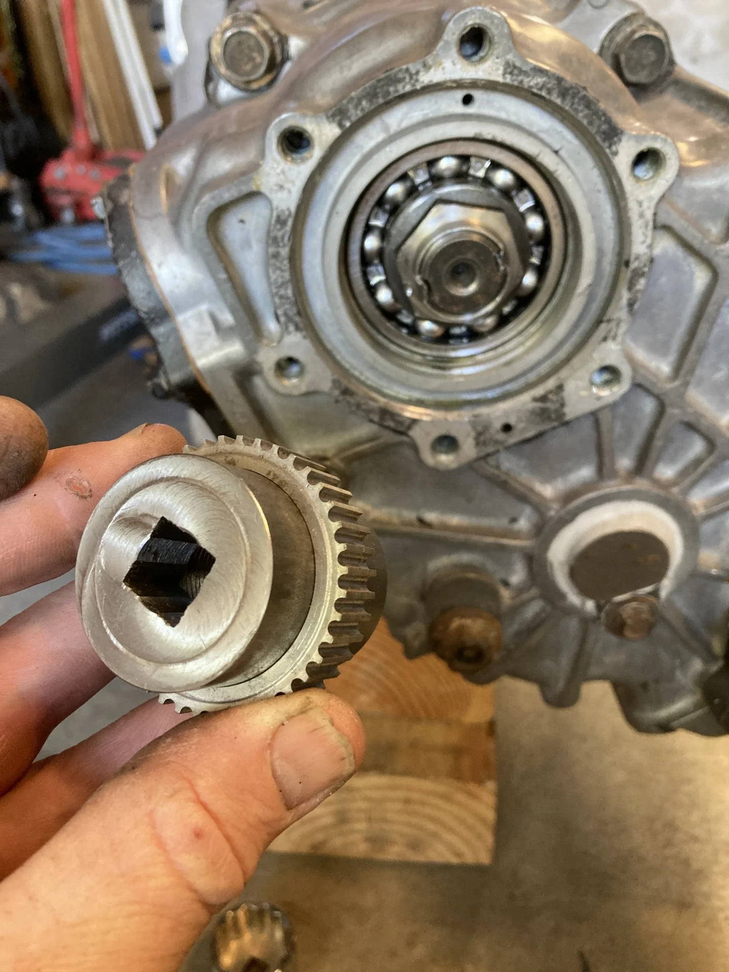

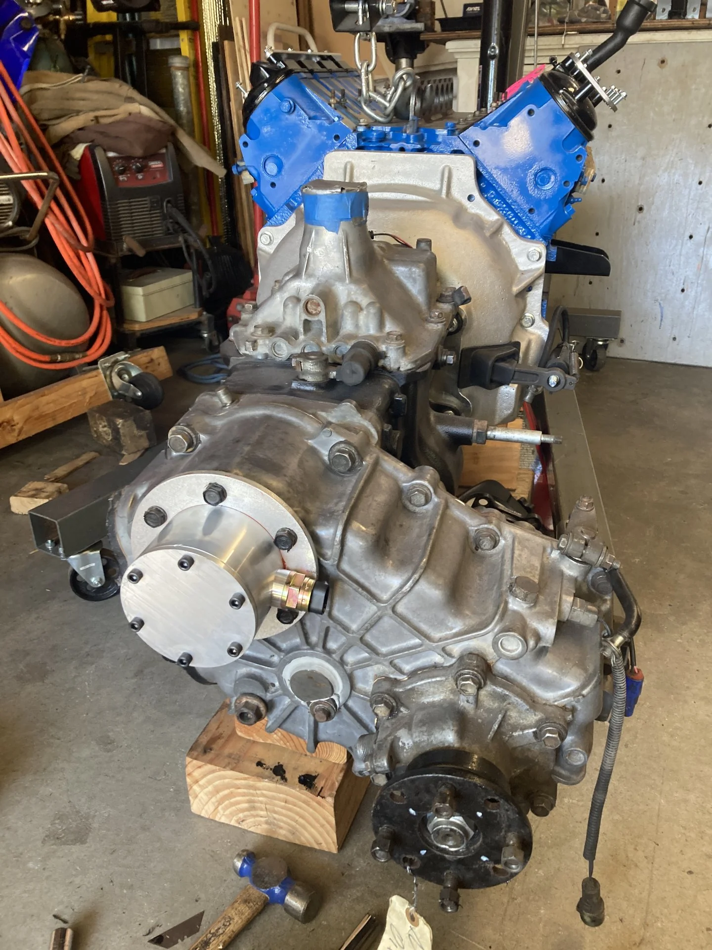

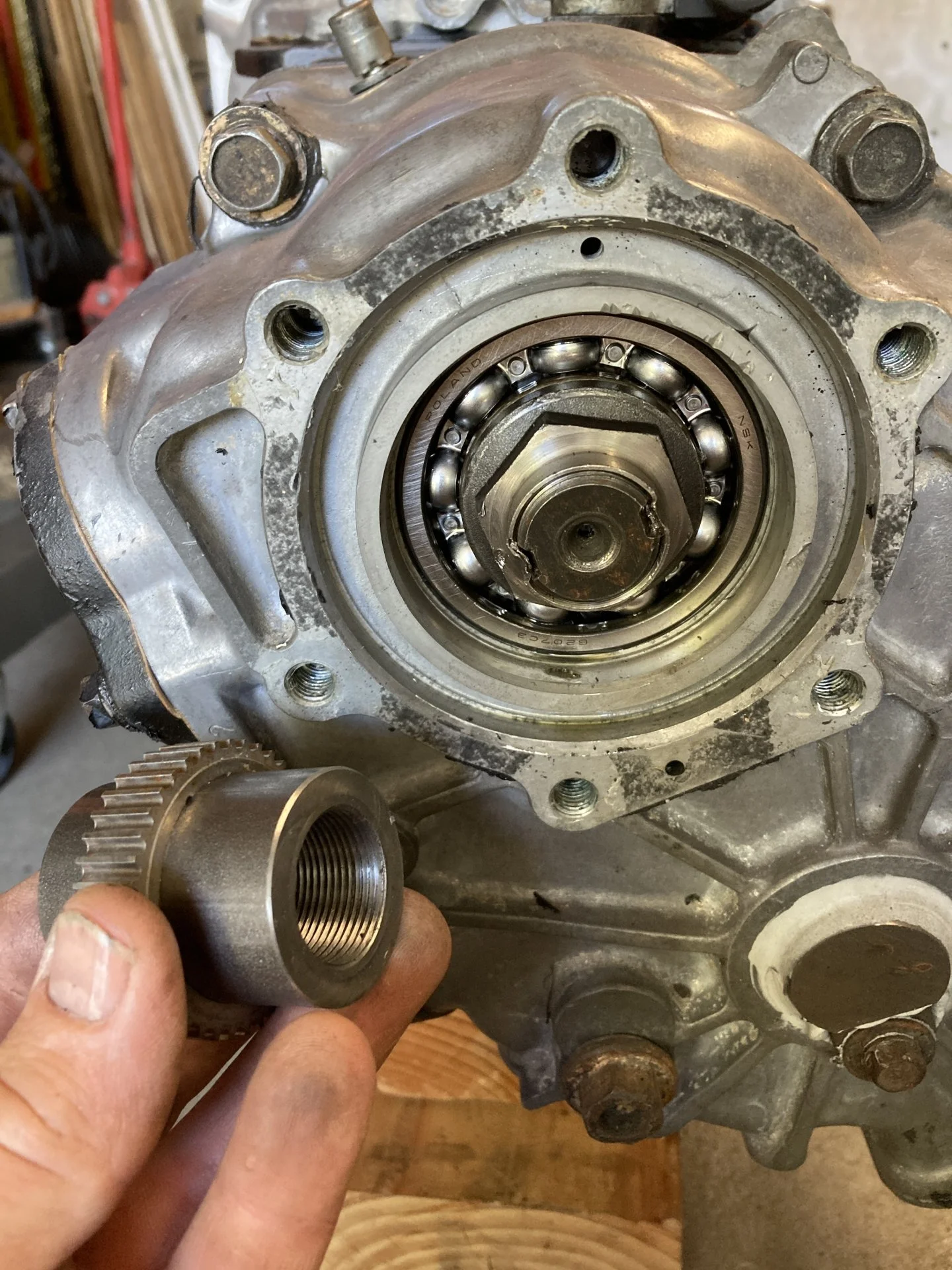

Was gonna get the engine in but thought to get this JTR VSS Reluctor kit on first while it’s easy to access. It’s to be used for cruise control.
Took what I think is the input shaft cover off and got to the staked nut. First off this the input shaft, right? I am imagining that there is a preload with this nut.
From what I see I am to replace that nut with the provided reluctor, and tighten it w 1/2 ratchet.
I am worried about how I will get the right preload and as well there is no way to stake that down. I am finding a torque of 94lbs.
Anyone use this kit before.
Otherwise I will have to wait til Monday to call. Damn!

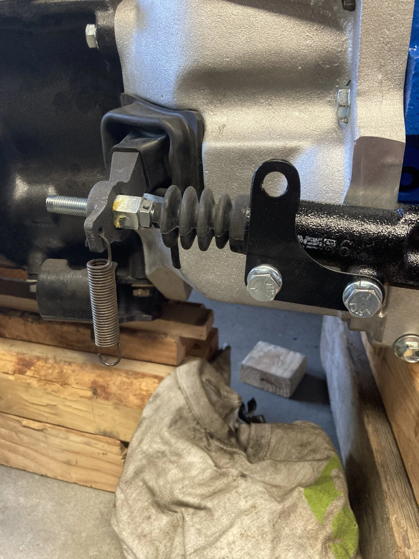

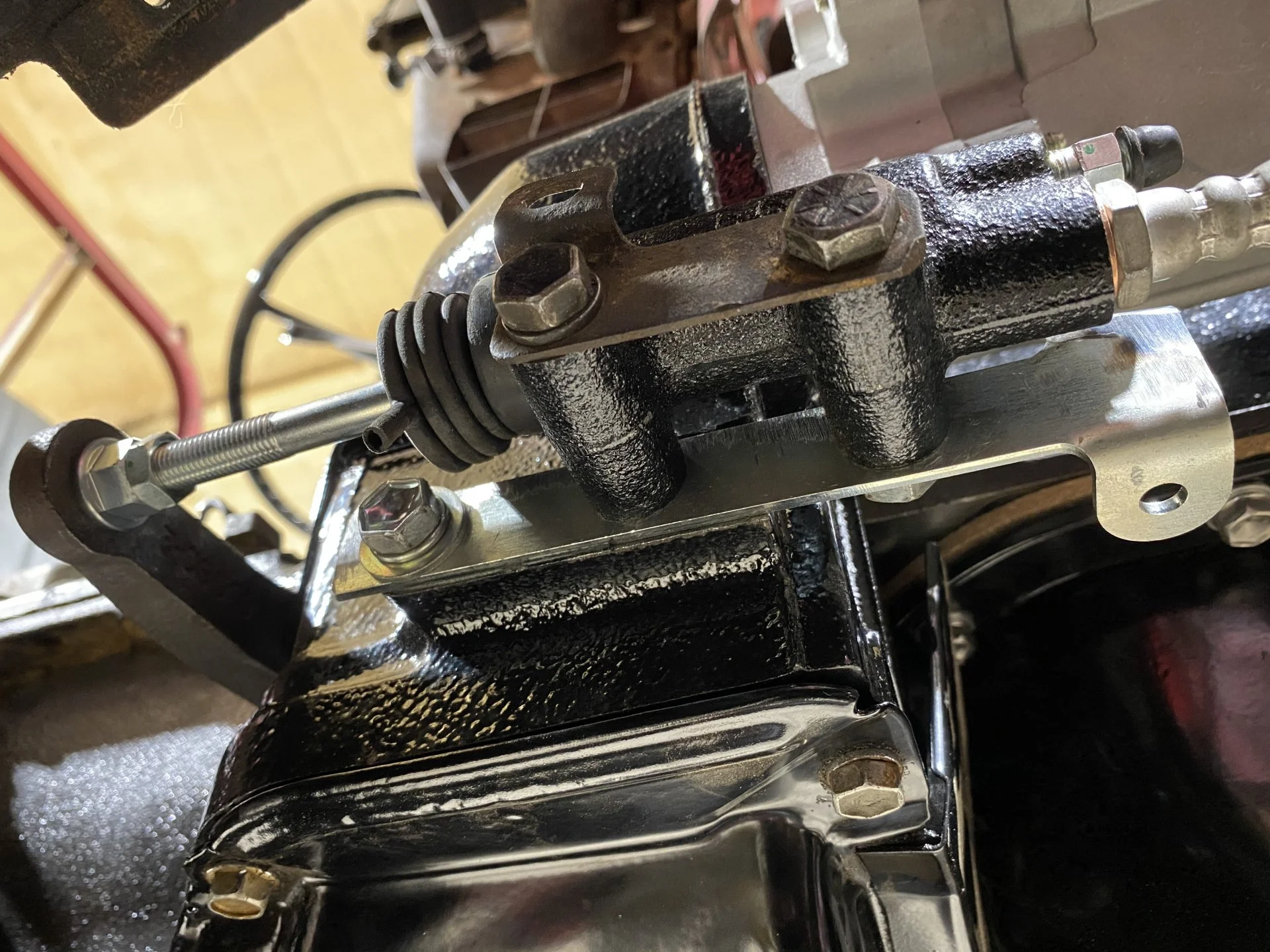

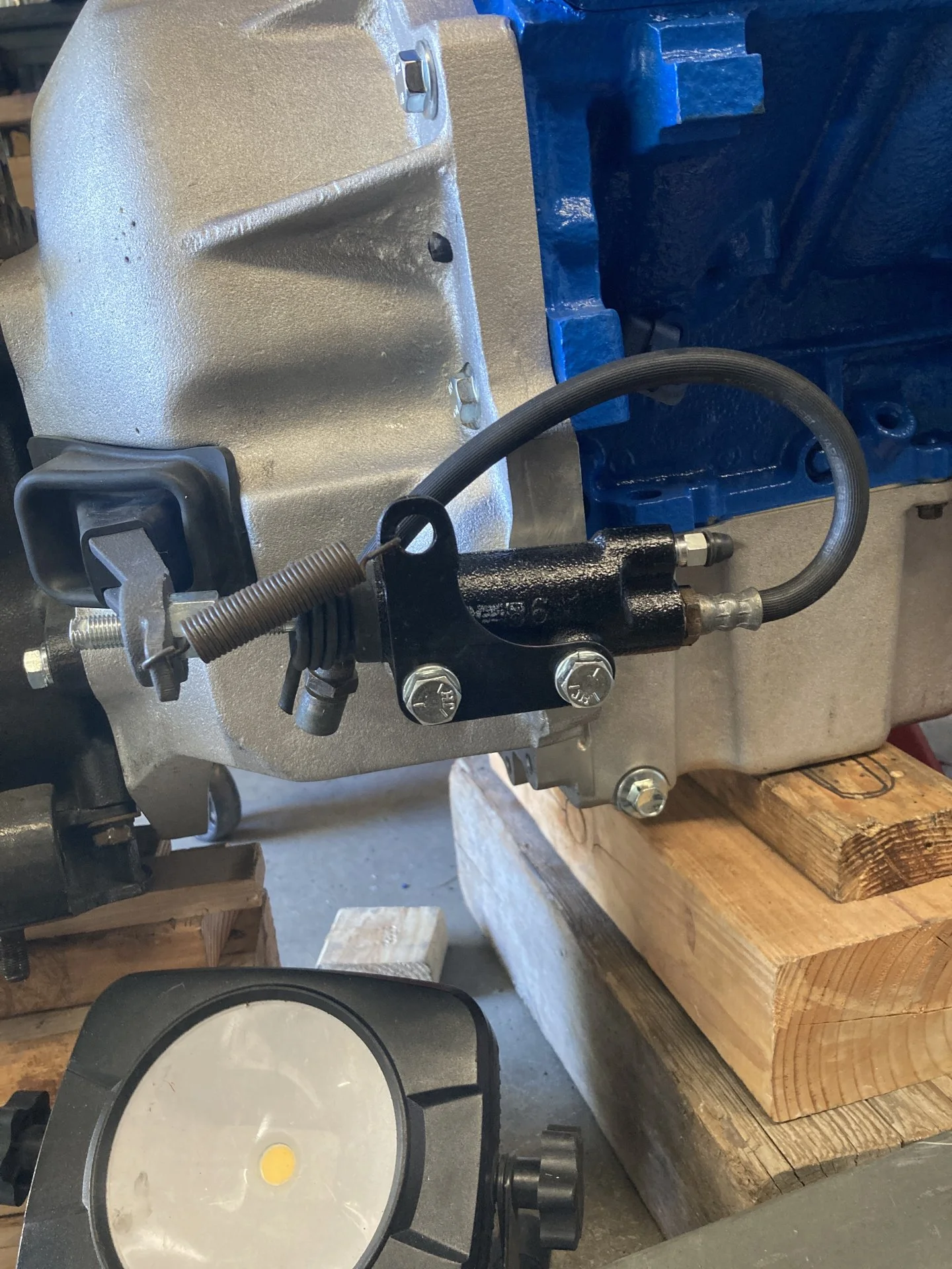

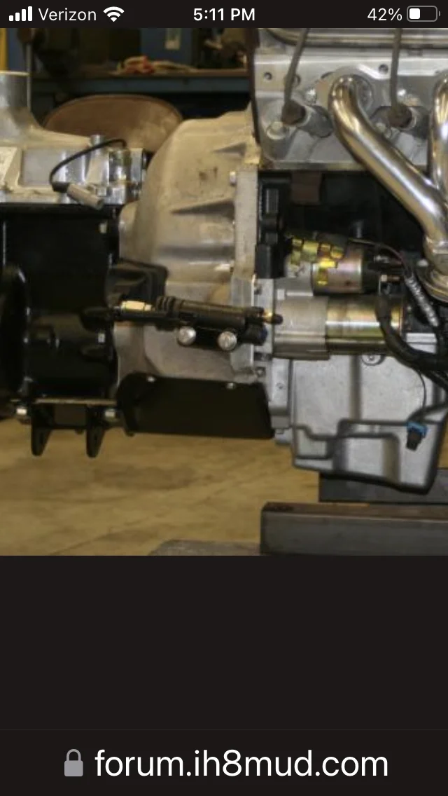

I just got my two buddies attached and even with the rod adjusted all the way back there is stil pressure on the TO bearing. Looks like I might have to make a plate to move the slave forward like Wngrog.
The slave is from a 2f engine.
Unless there is something I obviously did wrong. :/
Got so focused on the 2002 sierra idea and forgot that I have a pedal from my other cruzr! Yeah. Thanks LJ!

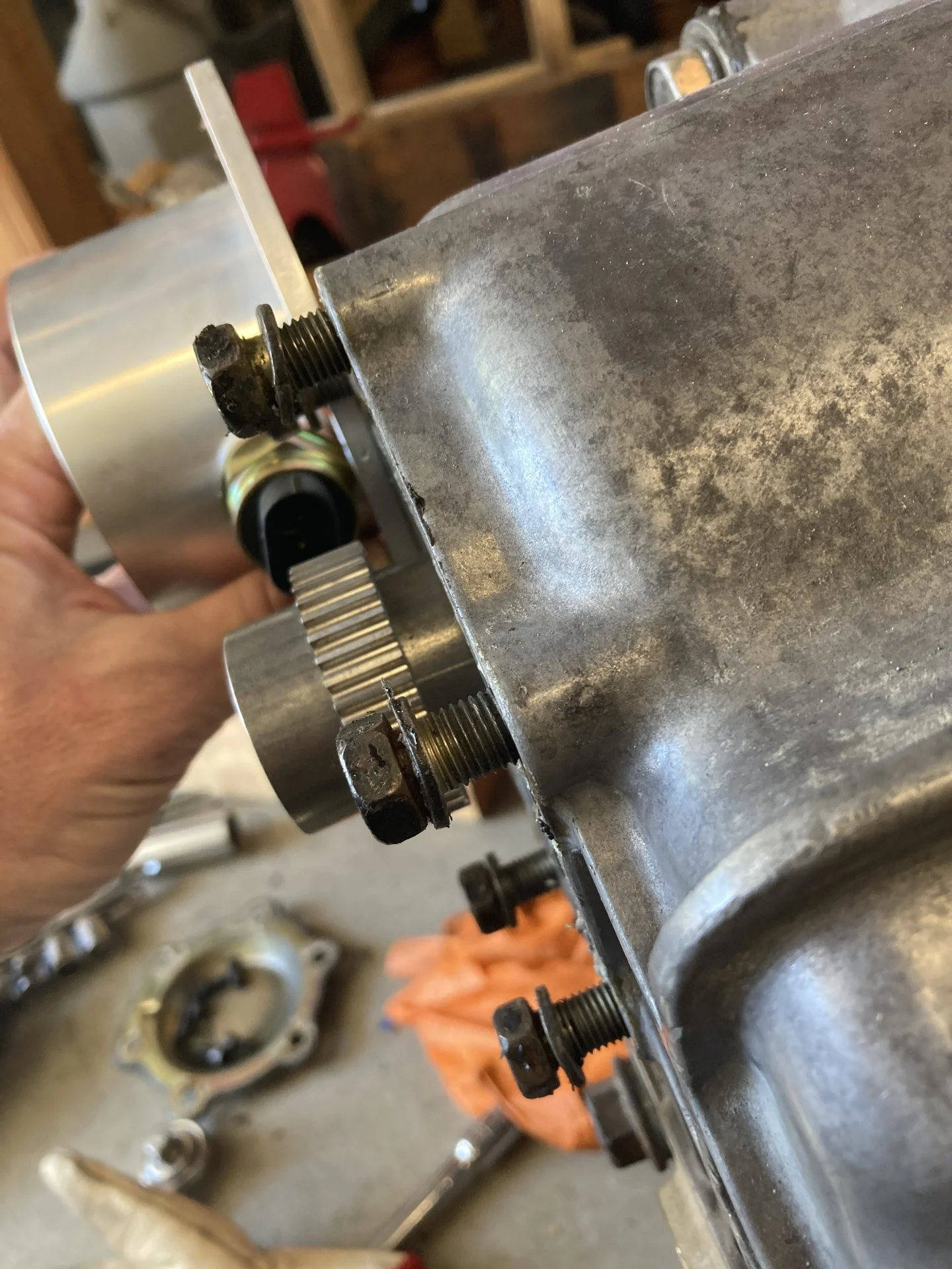

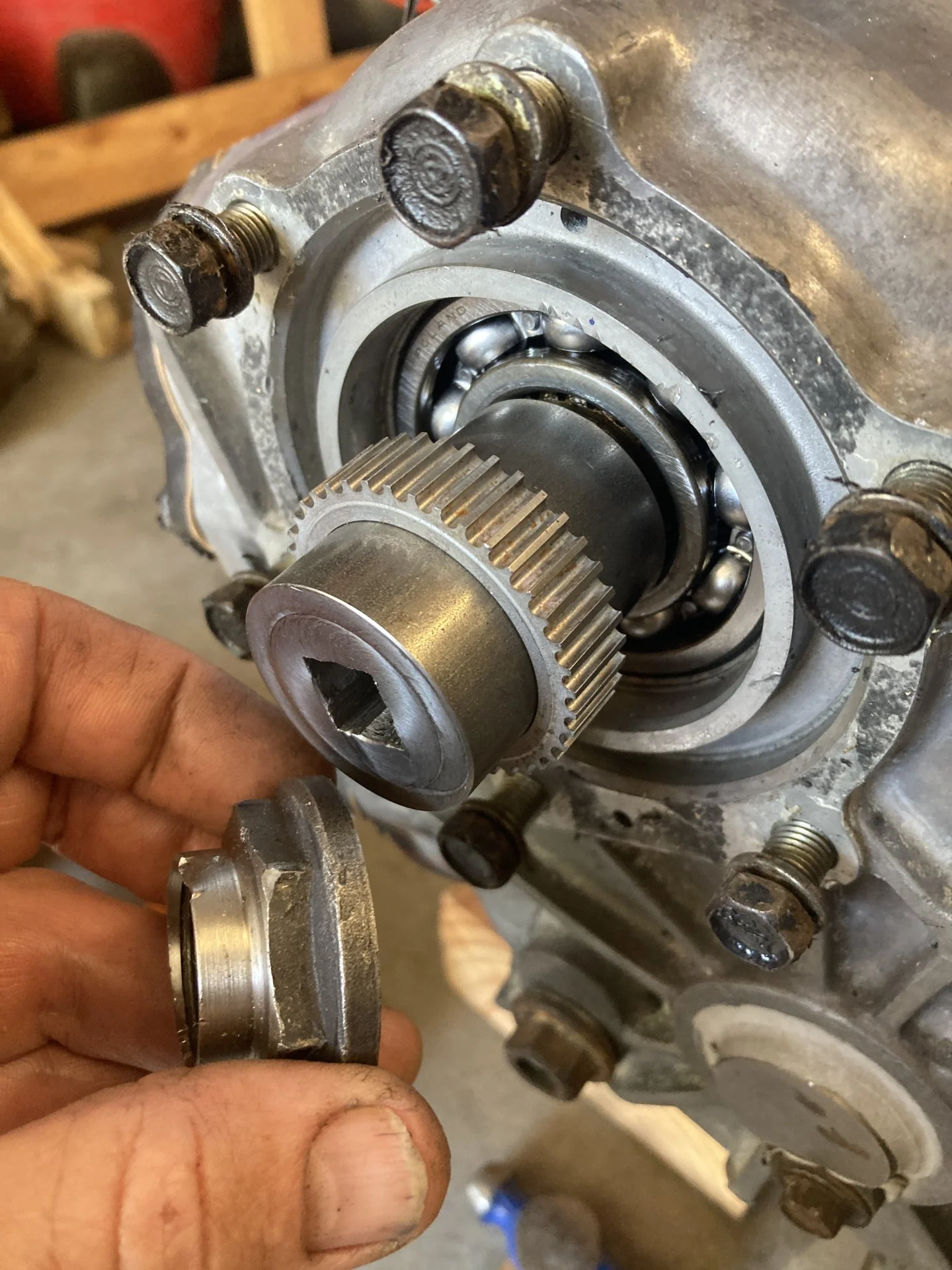

Also took this nut off and really it seems the only way that this will work is by just screwing it on.
The end seems to match right up to the sleeve, and it lines up the the sensor. Maybe it didn’t come with instructions ‘cause it’s straight foward. Let’s hope so!
Gonna torque to 94lbs and call it good.

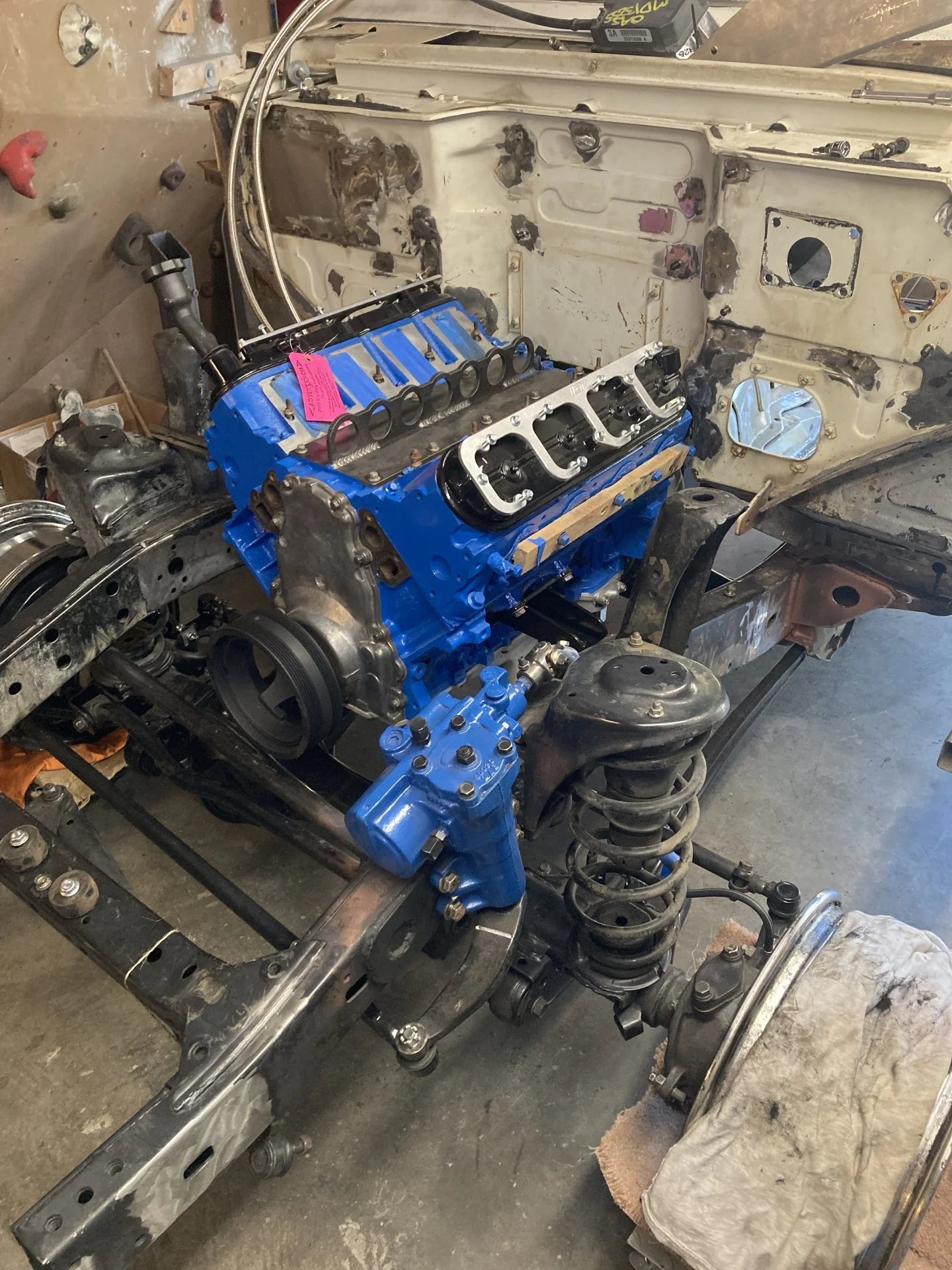

My big moment- get the engine in the last time before I take it out the last time to paint the whole car. Gonna drive it to make sure that I have done everything right then tear it all down for paint.
Looks great!
I amaze myself. Rush55 even suggested putting all the accessories on to ck clearances. So we did. He’s awesome.

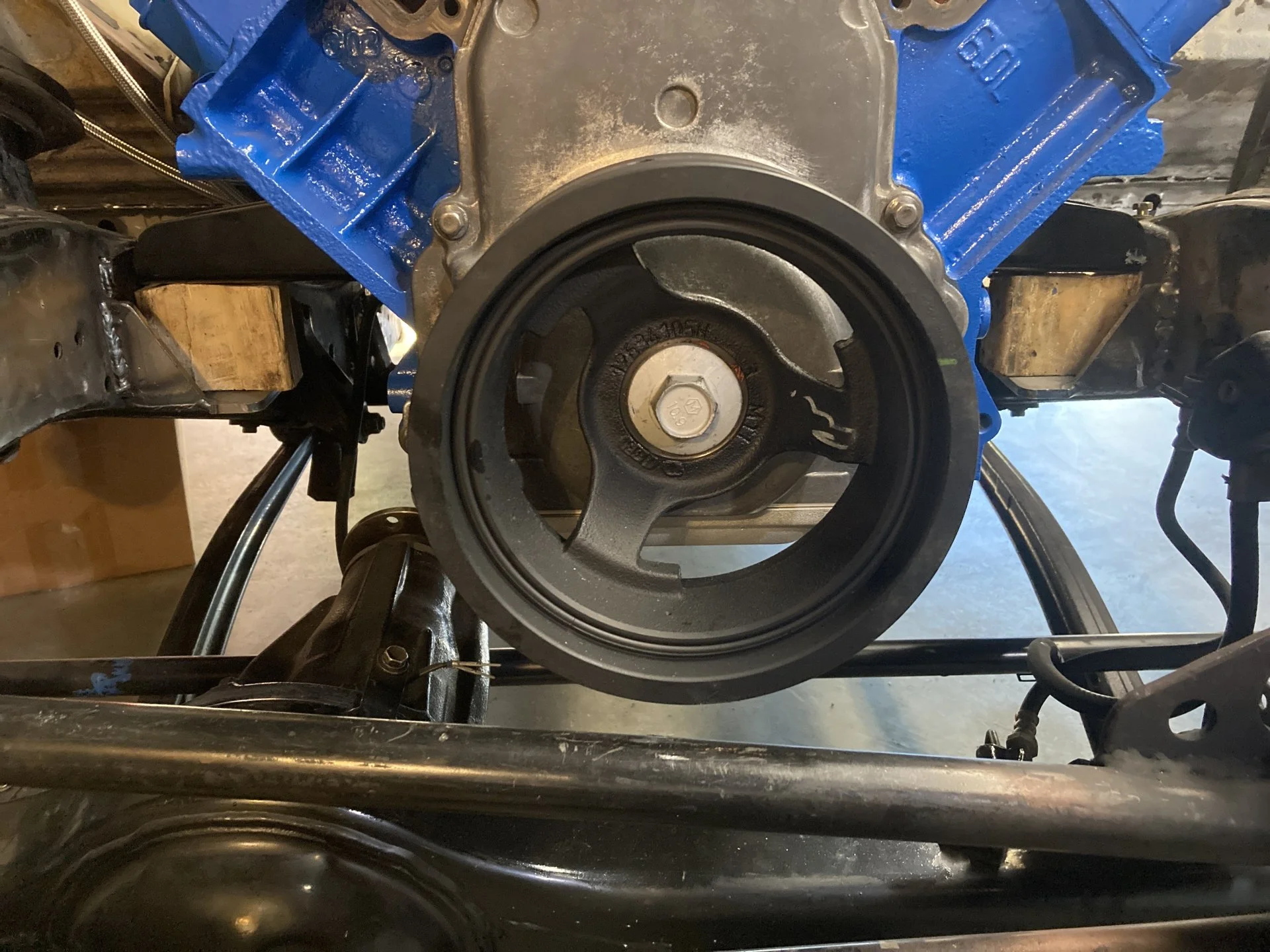

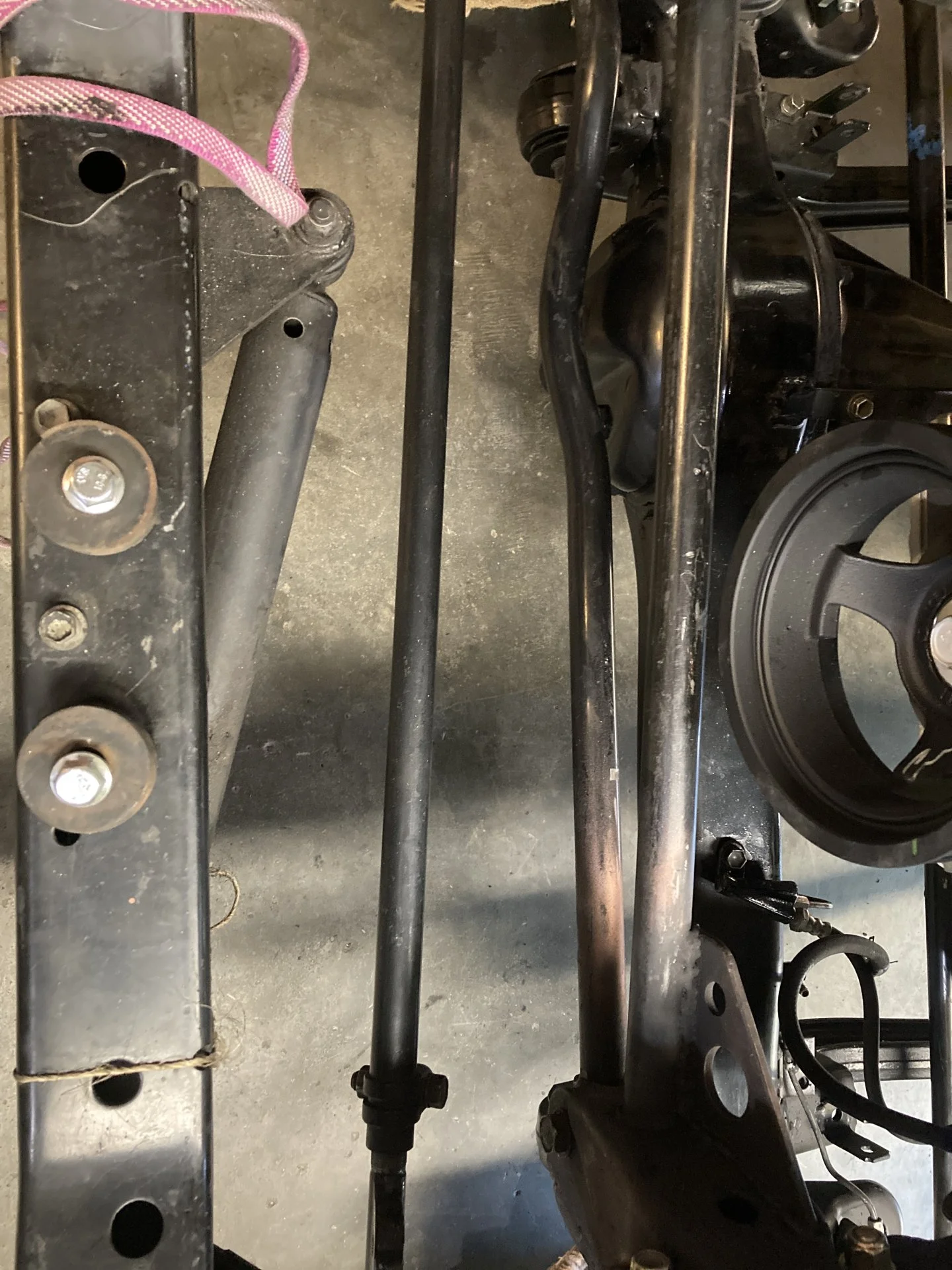

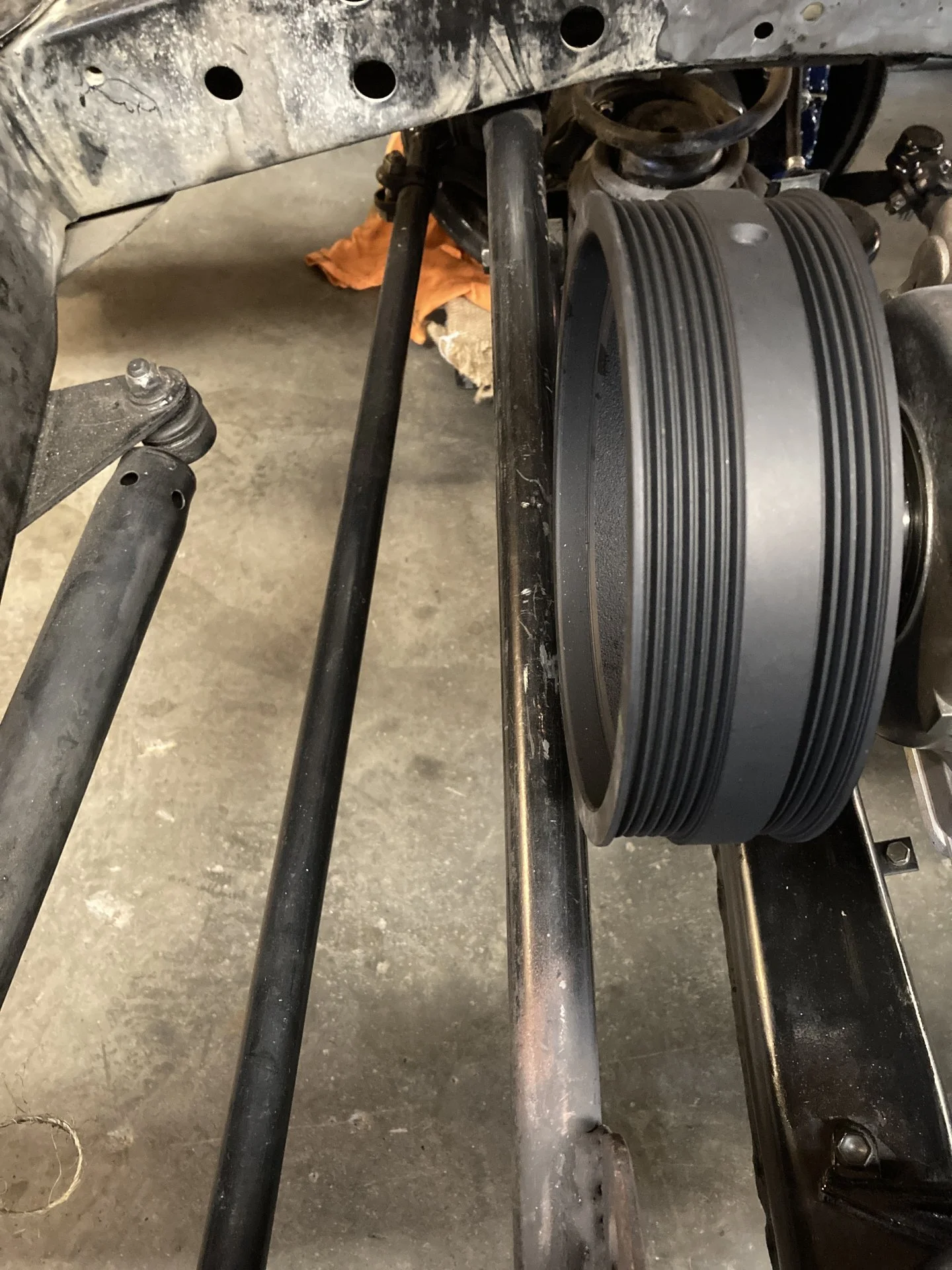

I just eyed the crank pulley. :( !!!
It hits a little more than an 1/8”
Won’t let me drop onto my nicely welded in engine mounts.
Not sure I can go with those wooden block, no?
Lag bolts , bam!
Seriously though moving the mounts up the frame rails doesn’t look too bad a job?
Will everything be happy with it sitting up there?
