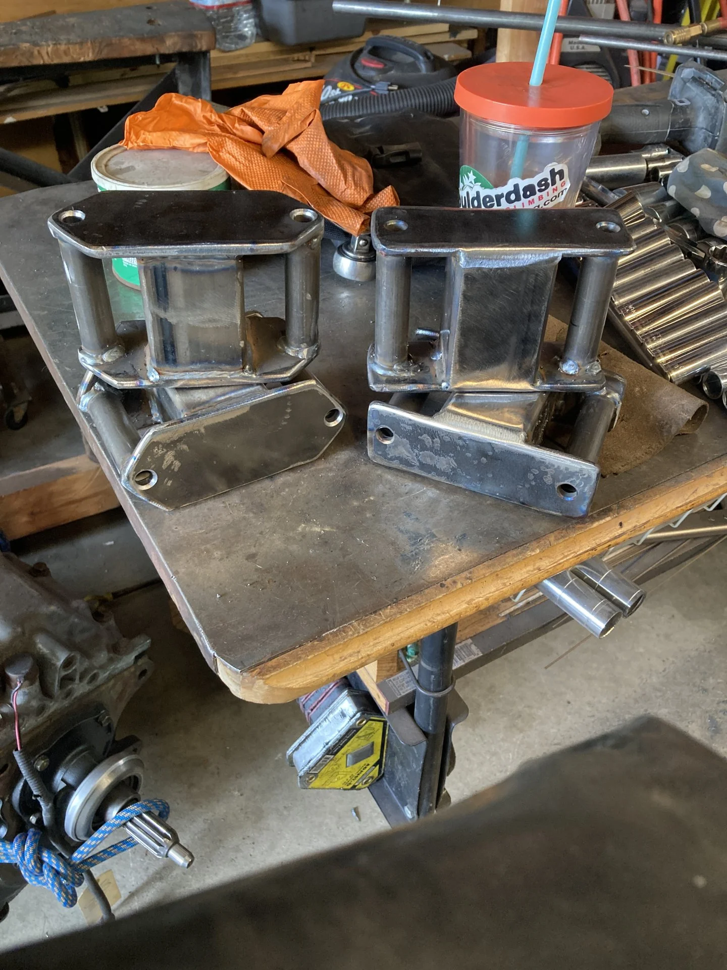

rear body mounts

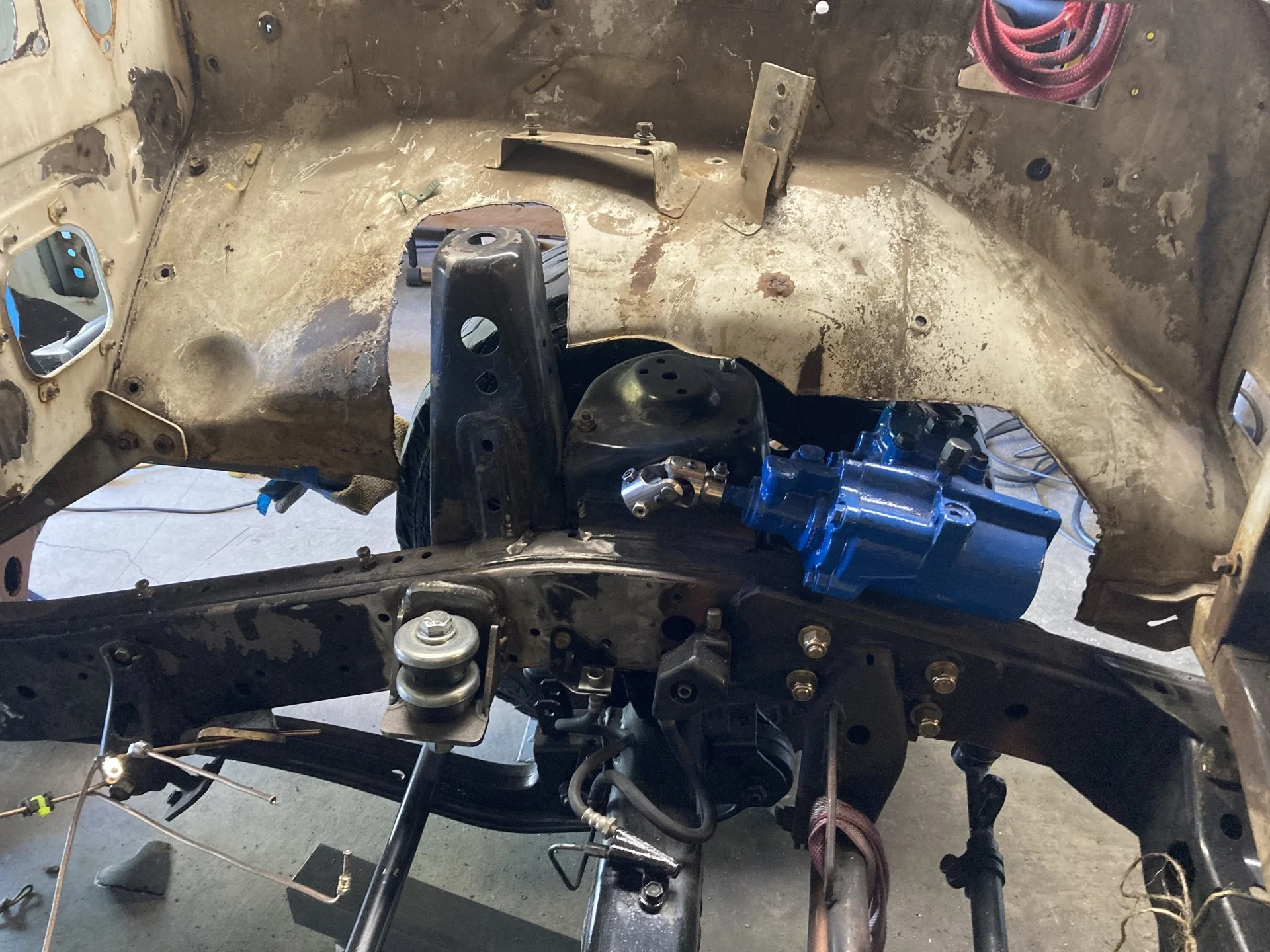

Executive decision to use the flanged bolts. The plate pulled up against the FW with the first pass of tightening. If I need those type of bolts later, elsewhere, I will just get some more! Can’t imagine where tho. I am thinking extra bolts for different set ups.
Never been happy ending up with extra bolts tho. 🤪
Went with 7-15-22lbs of torque. Did do some reading and some were saying that one should go up to 54lbs. 🤨
Got this shot but not sure with the different crossmember.
Any chance of getting a measurement from the aft of the 3 fram bolt holes and maybe a height measurement?
Just curious as I tried to follow all the steps that you guys did.

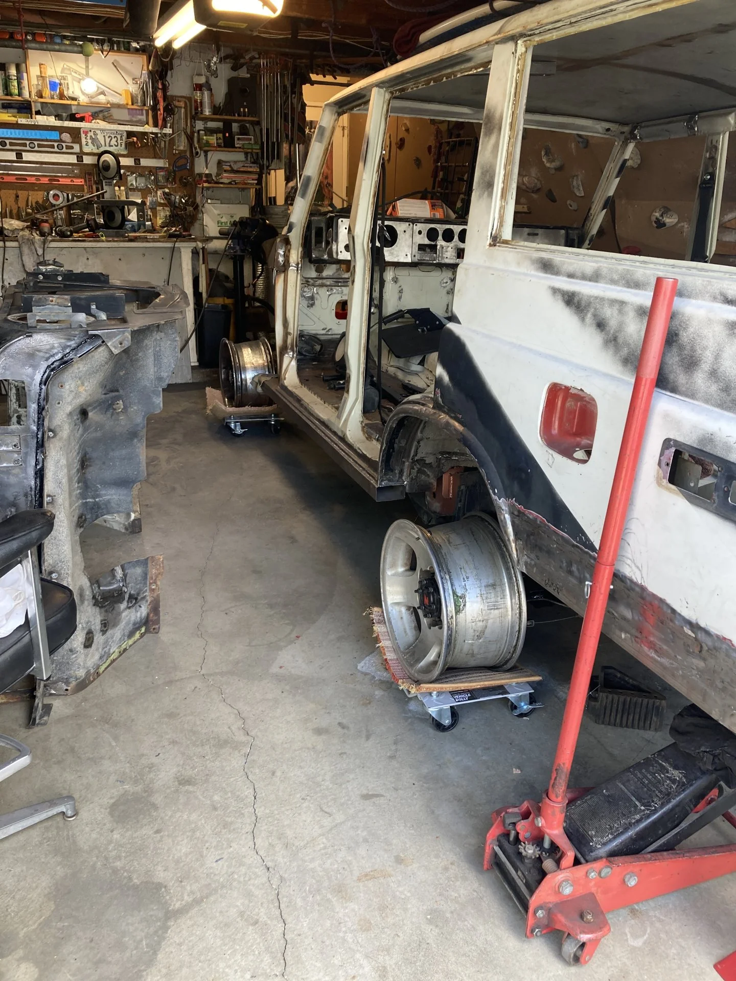

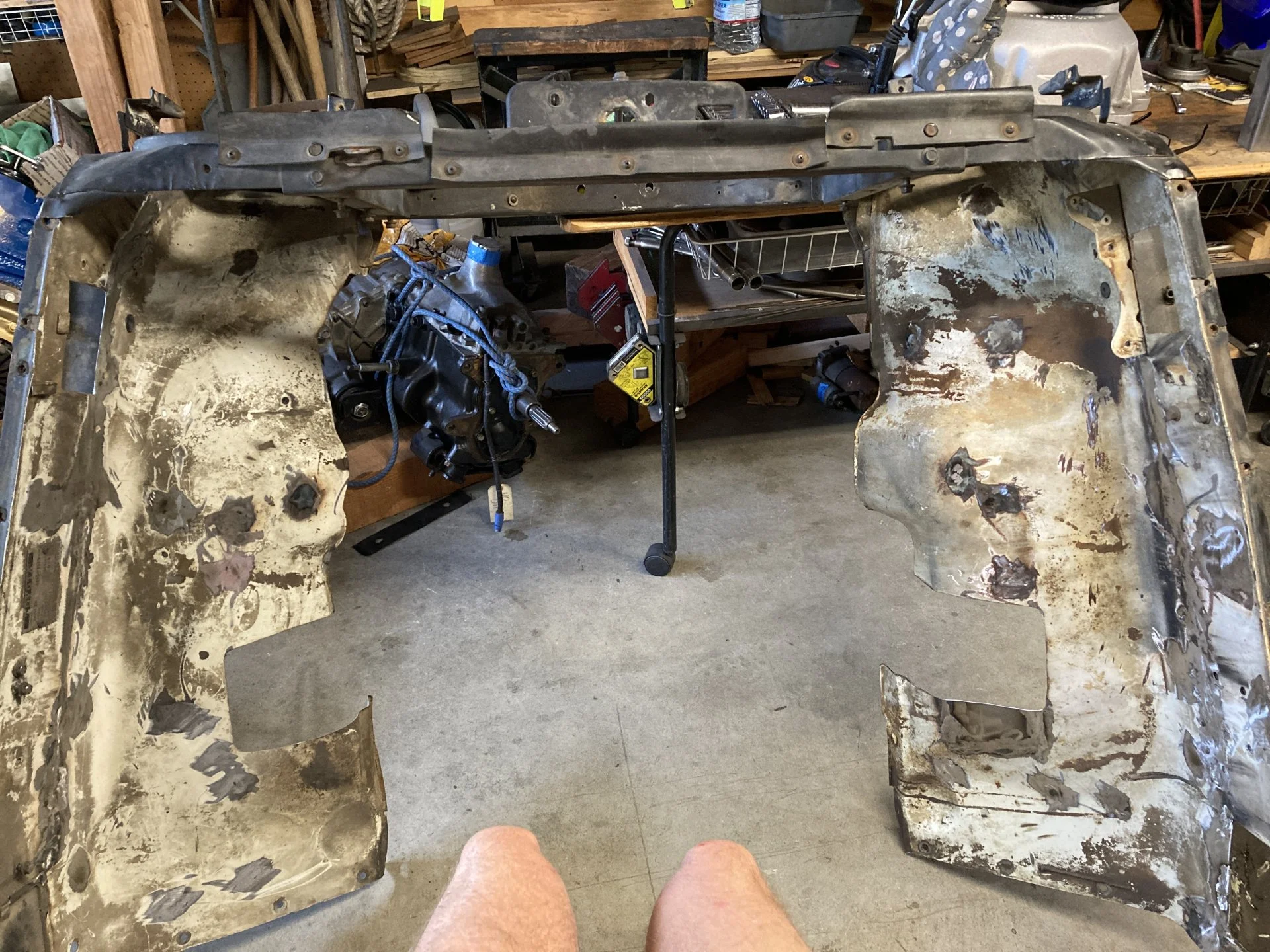

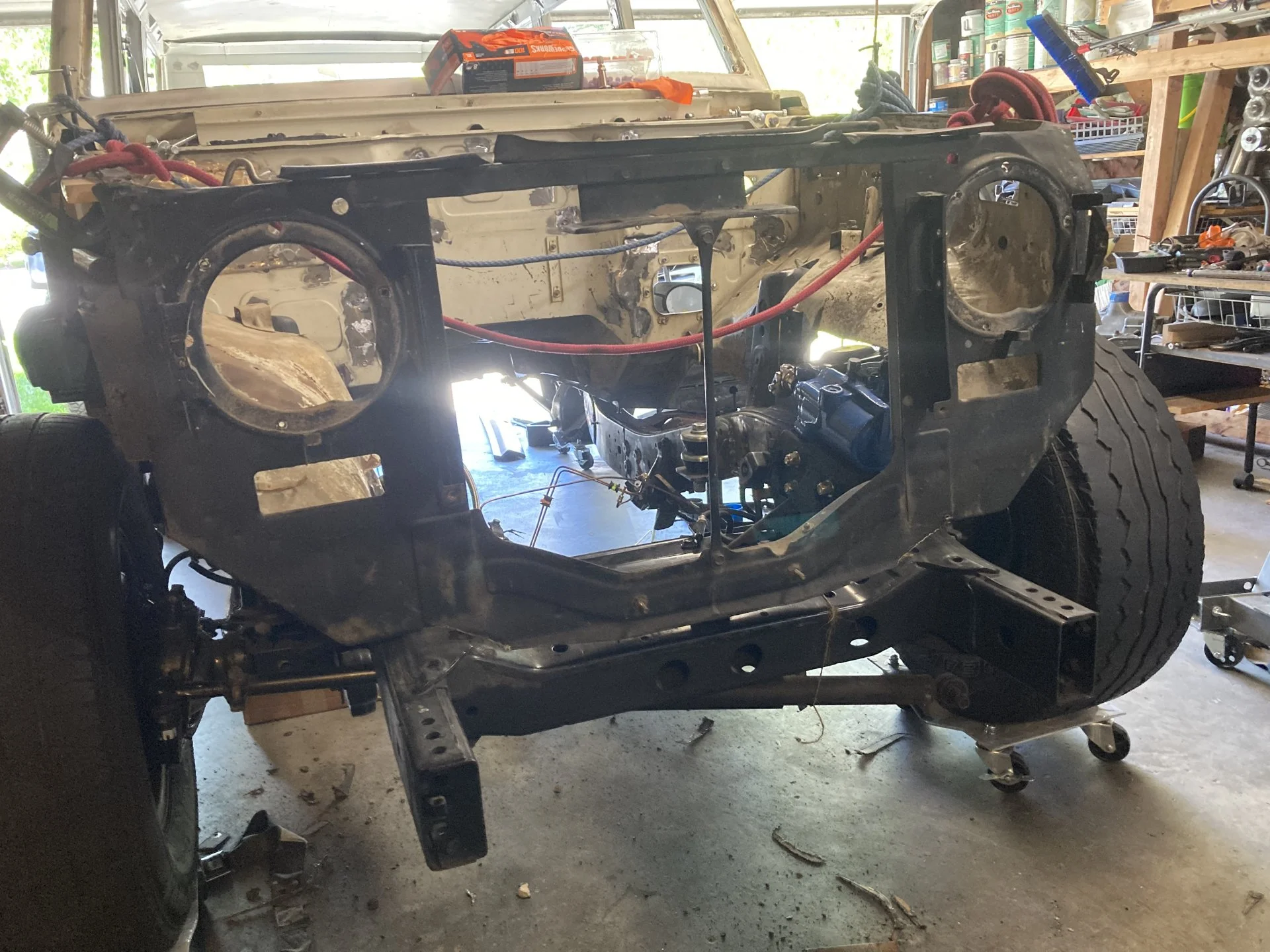

Worked all weekend on getting the dog house all fixed up. Removed all the brackets filled and sanded all the holes for a new and clean slate.
Then I saw a little rust area about 5” down on the engine side. Talk about a rabbit hole! Now if I lived up to my better’s standards I would have removed the outside fender attachment and put in new metal. But, alas, I fell short. Ended up wire wheeling, filling, filling, filling, chasing. I am done with it.
My penance will be having people saying, “looks great, but what happened here?”. All I have to do is get the fenders on so that no one but me will ever know.
And, boy, I have a short memory! Is it 420?

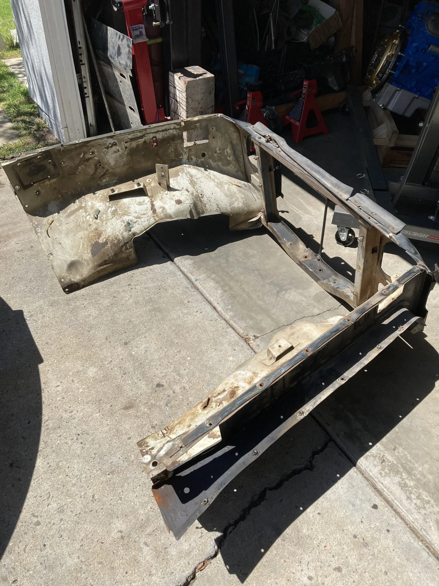

First is the Inside shot. With sandblast, maybe a bit of bindo, and paint gonna look great.
Well the second you can see for yourself. The outside edge following that fender connection piece. Oh my, that is some shabby work. Y’all see it right?! It’s just to the left of the cab. See it?
