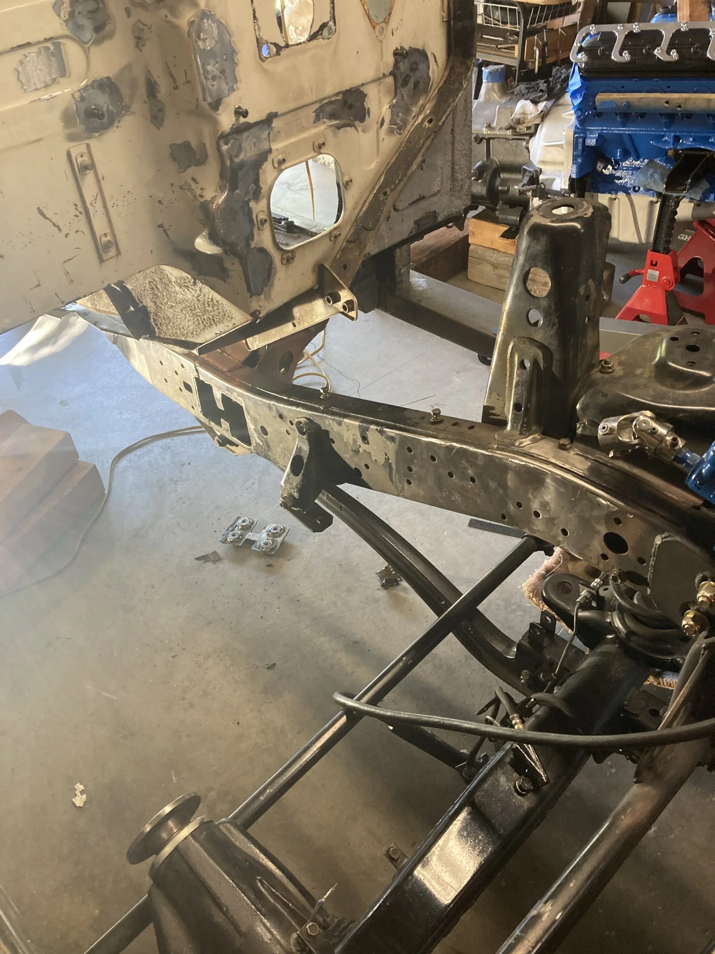

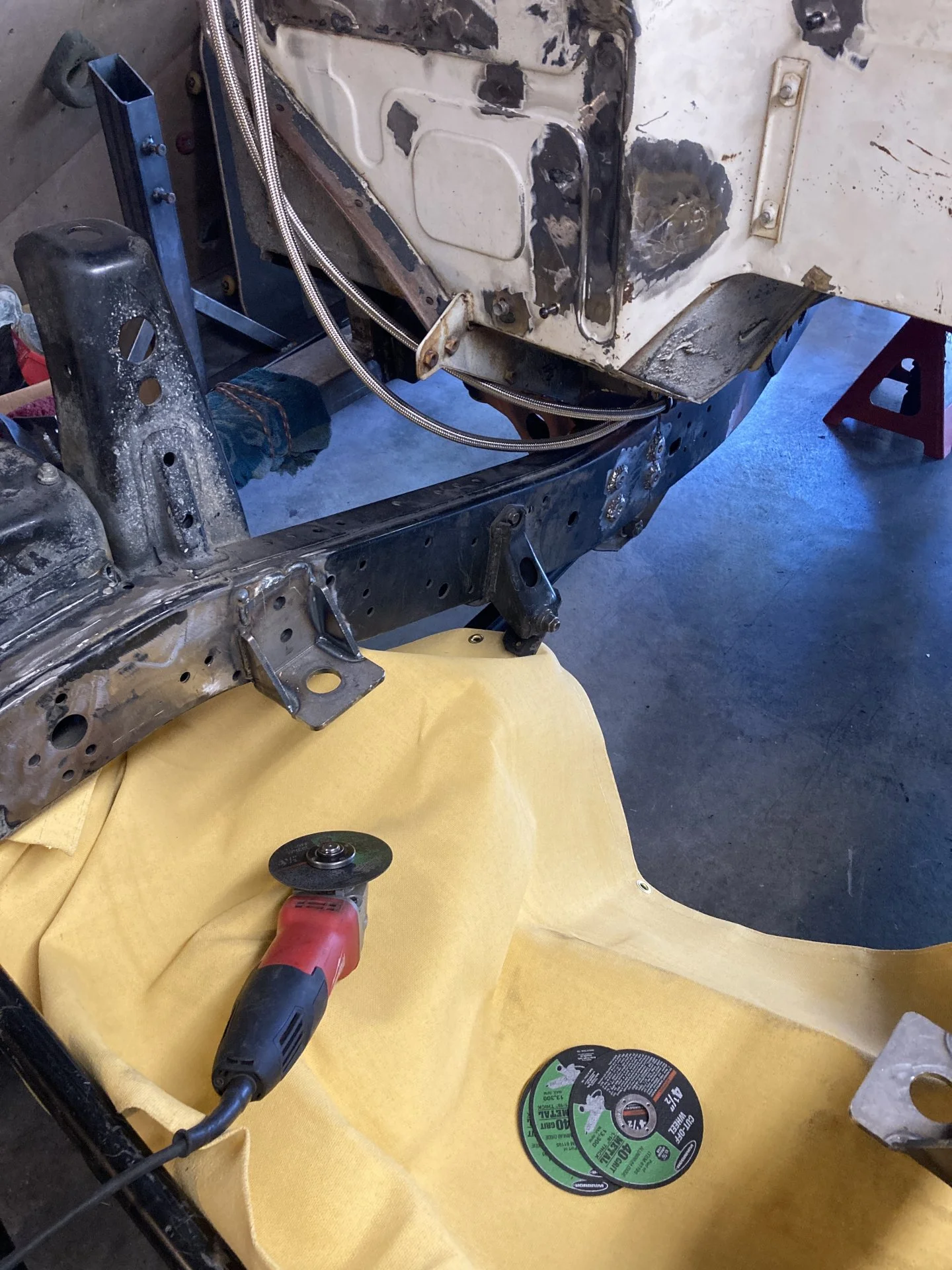

rear body mounts
Se le vi for the newbie!
Get to practice some more fab/welding I guess.
Hahahahahahahahahahahahahahahahahahahah 😂
Trans mount will be fun. Got some ideas on how to make it prettier.
Danger must be your middle name.

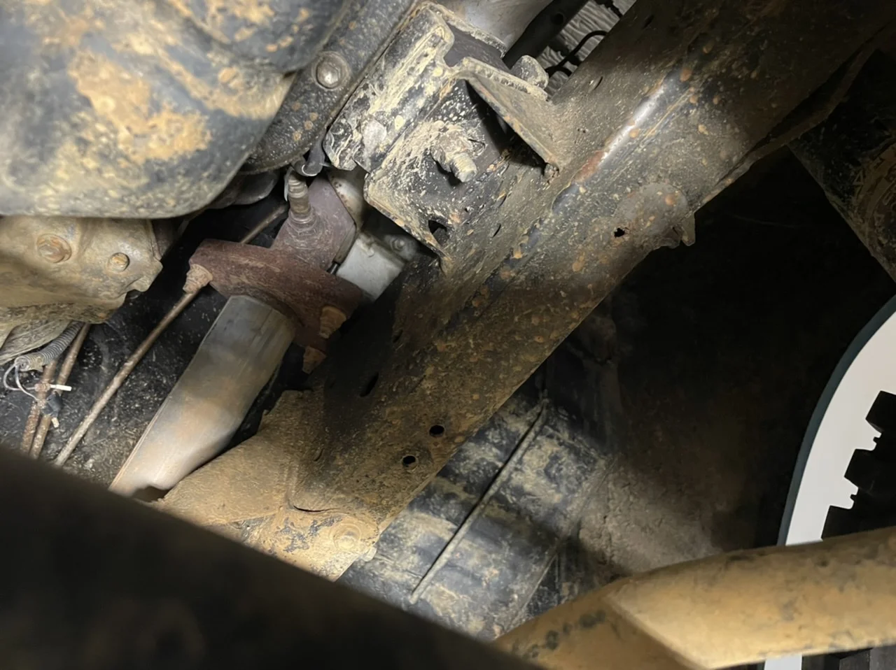

You guys that out different engines in, did you keep your rear heater? I welded up the hole for those lines and it looks like my engine would have been in the way anyway.
How did y’all keep it? Did you link into your Restomod Air system? I saw this switch a long time back. Perhaps something like this?
I do not have the rear heater. Here in San Diego you don't need heat for 80% of the year. If it was a rear a/c that would still be here

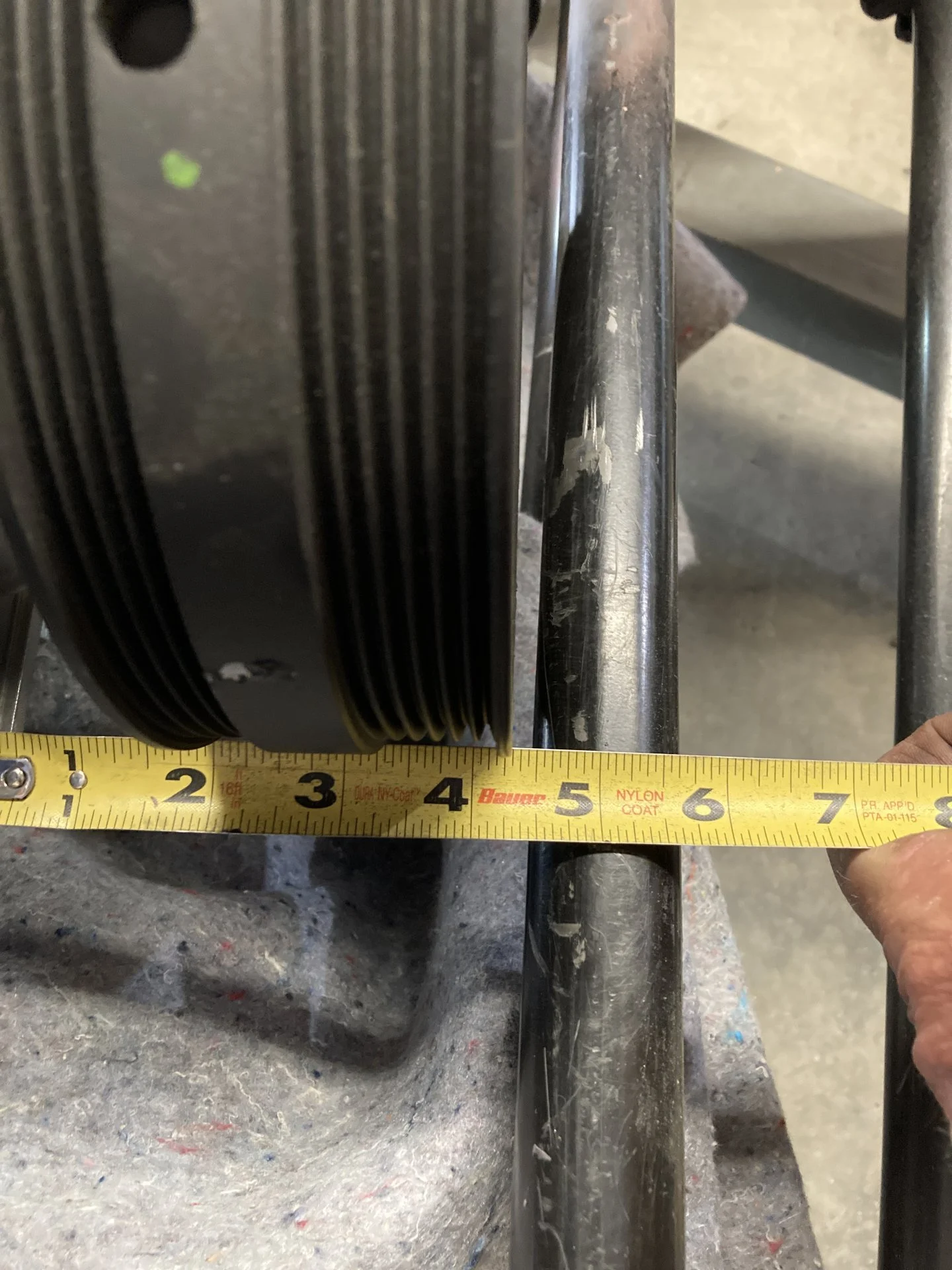

So I’m back in.
Thoughts

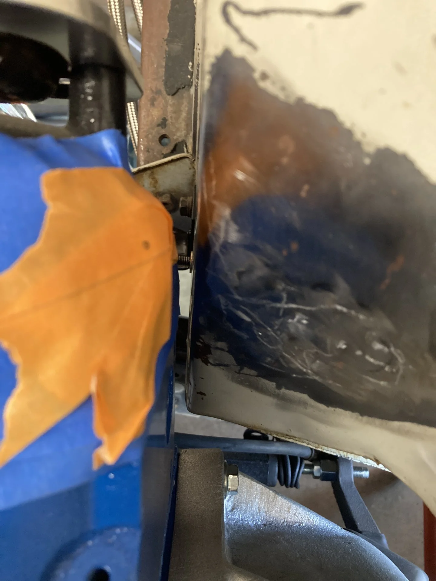

Without getting into cutting the firewall I have about 1/4” between the crank pulley at the tightest and about the same at the firewall passenger side, maybe a bit more.
Do engines move around more than that?
If I do a little cutting on the firewall then I could get more distance. You know I want to but not really. Especially if my spacing is good to go!
is your suspension at ride height or are you stuffed?
“I think” between the sheet metal, frame, and motor mounts, it could flex 1/4”
To have it compressed that much on the pulley side with the springs in would take a pretty sweet jump and hard landing though.
Run you bump stops out 1/2”? Might be easiest
