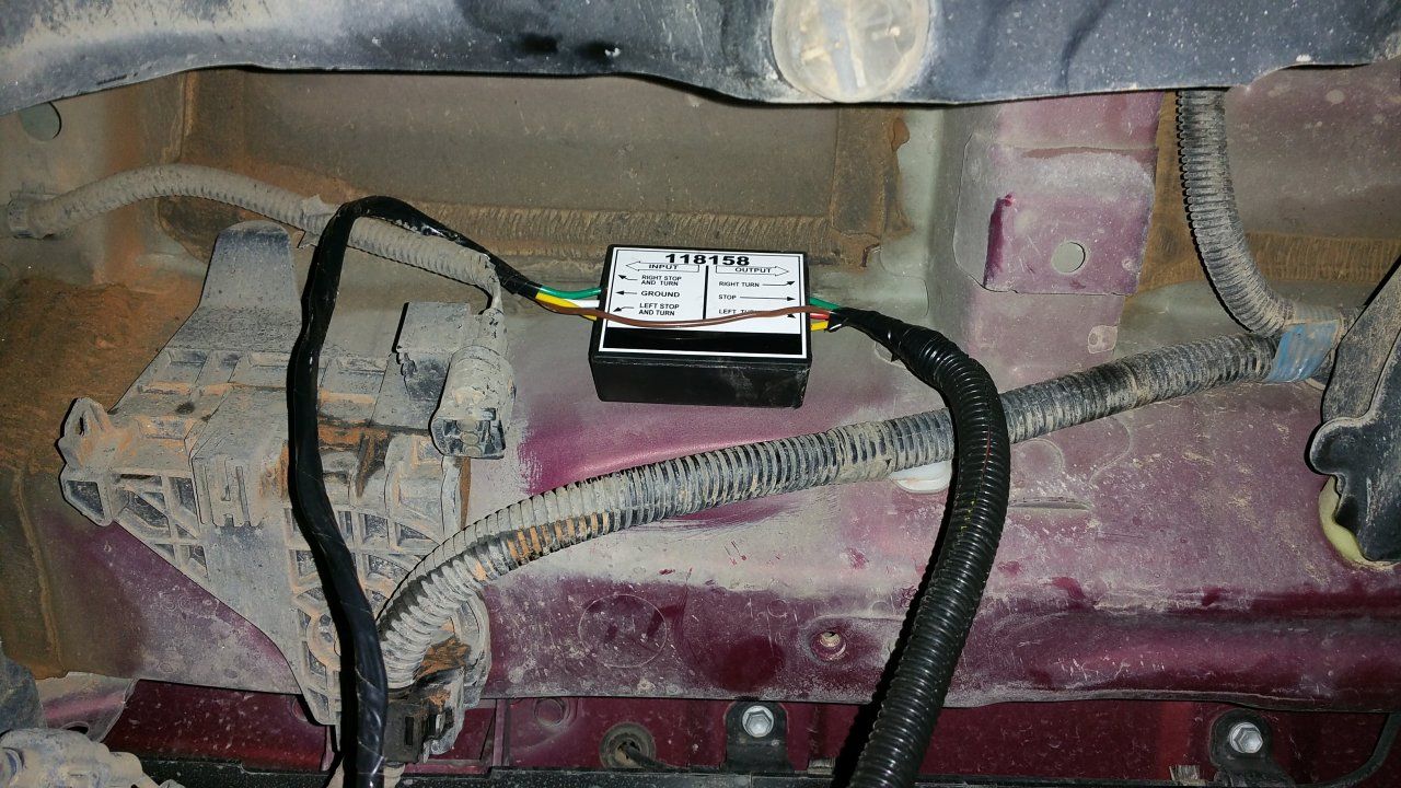

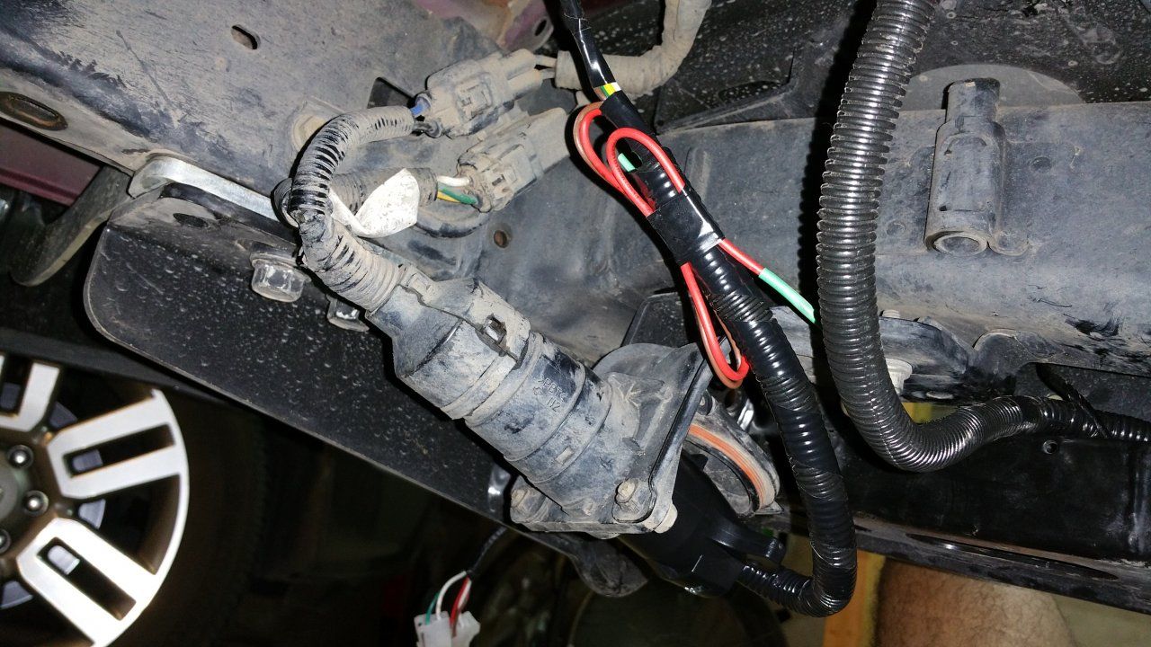

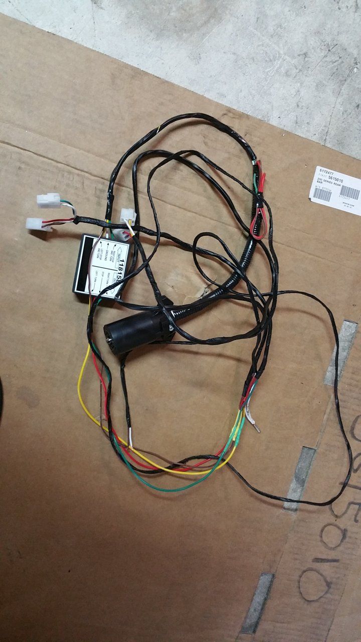

I finally got my lights working correctly. Thanks to help from JamesC. I purchased a tail light converter and wired it through a 7 pin plug that is plugged into the vehicle socket. Wiring is straight forward. Match the colors and tuck it away. The converter has an adhesive pad to stick to the body. I tucked mine away up on the body and routed the wires through the bumper to the lights. When need to tow a trailer I will just unplug the bumper lights since not needed with the trailer back there.
Ready to install
Where I mounted the converter.
Harness plugged in
Lights working

What does the tail light converter do???
I am having a hell of a time wiring my rear carrier, and I think it might solve my problems! Can you enlighten me, someone?
The tail light converter takes an intended combined-circuit and splits it for an independent. Normal two elelment bulb (compound) trailer circuits carry the turn signal and brake signal combined on the same wire. This box allows you to light exactly what you want to light when you want to light it. :)
I guess I need to order one then. I've been trying to figure out wiring for the last 4 hours.
Now I know my problem.
@TJsTACOMA used the ARB wiring but we ran all new. I think there is some opportunity there for things to be correct for Australia but not for US trucks? Theoretically the ARB lights could work without the converter because they are dual element.
