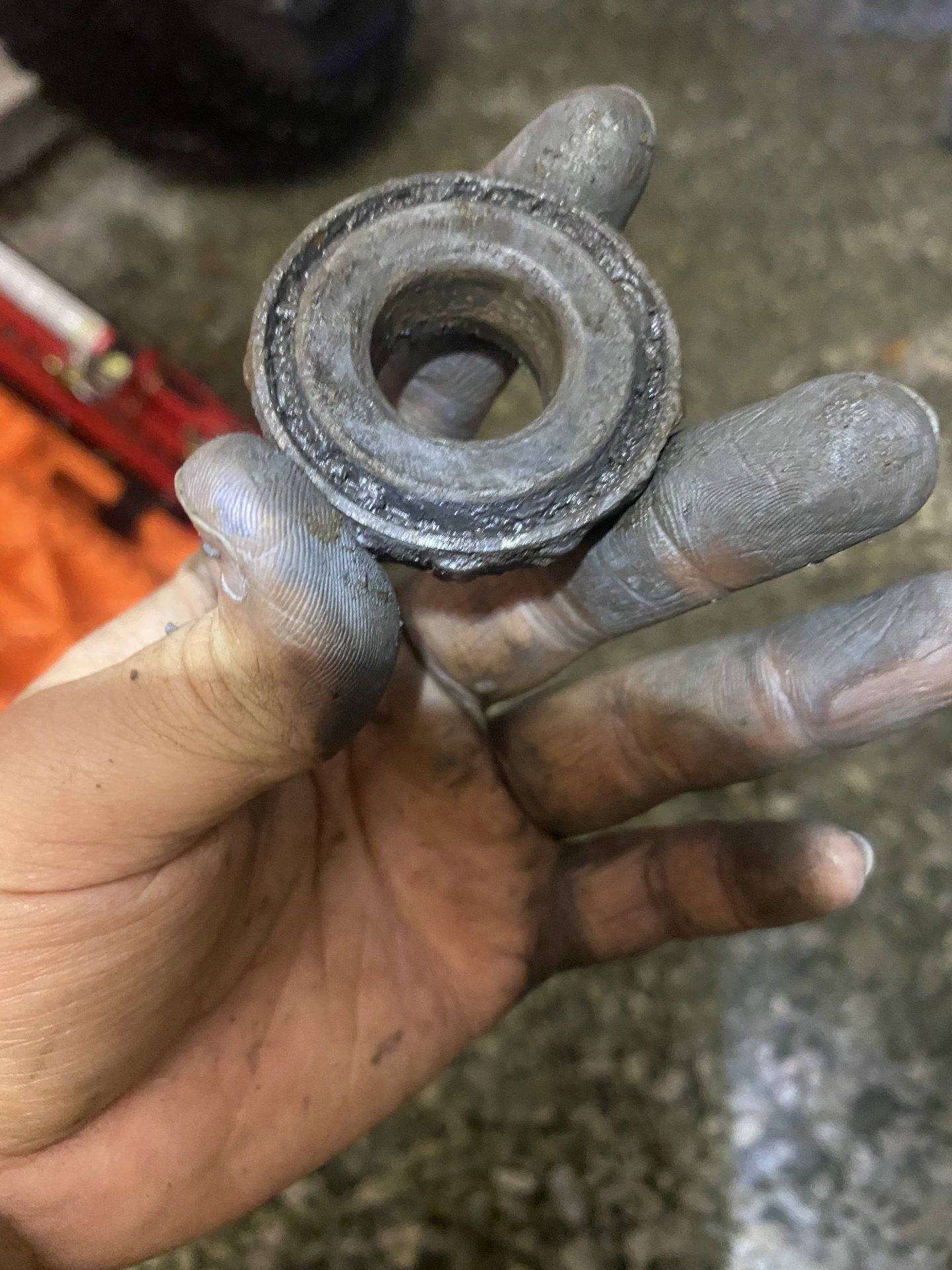

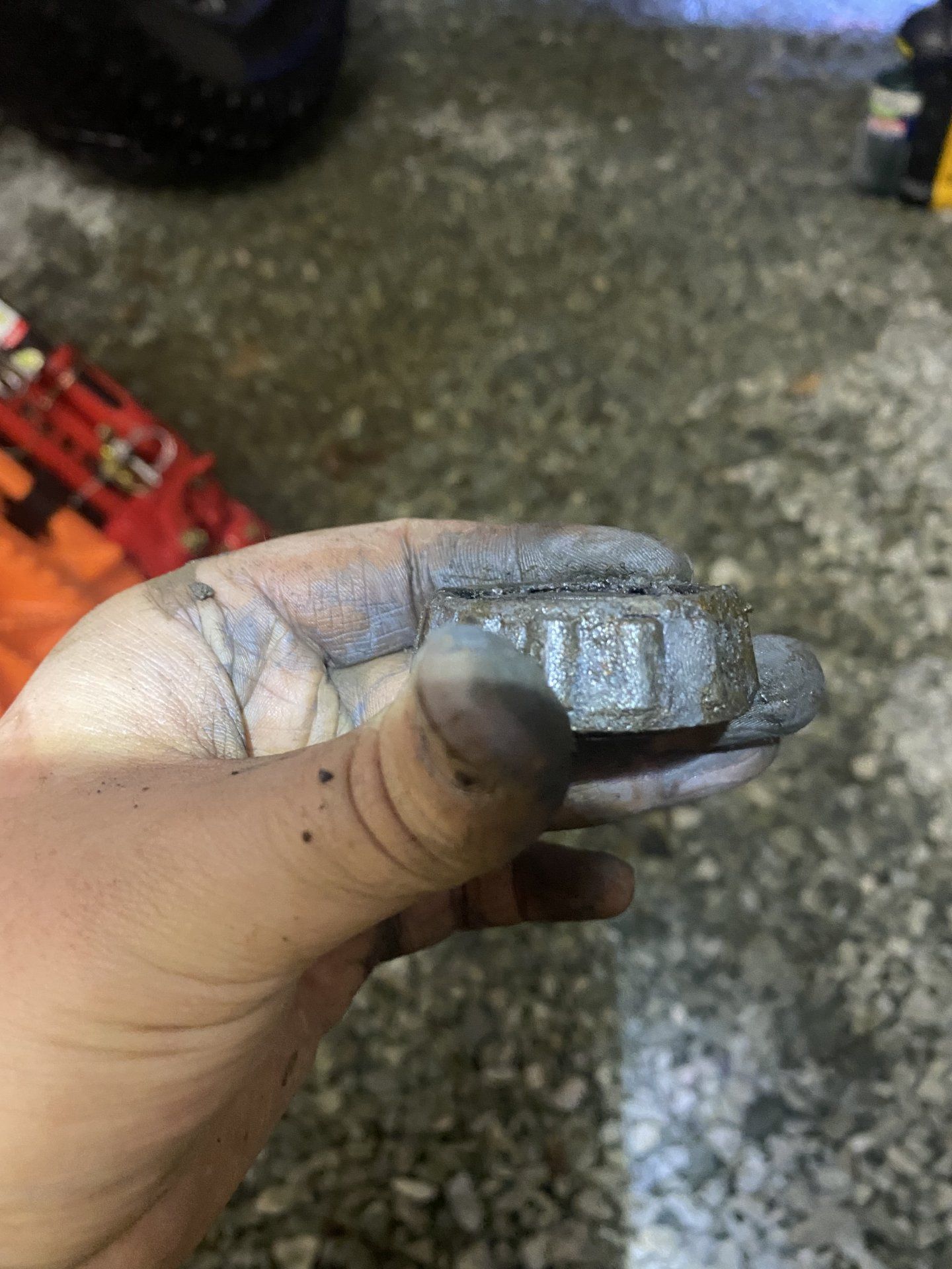

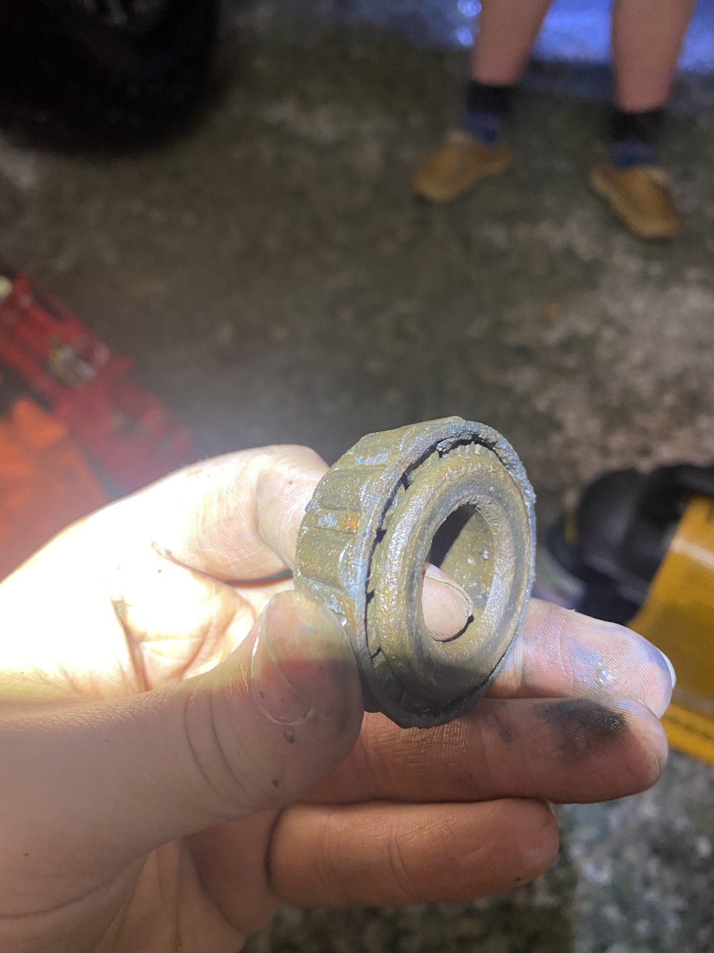

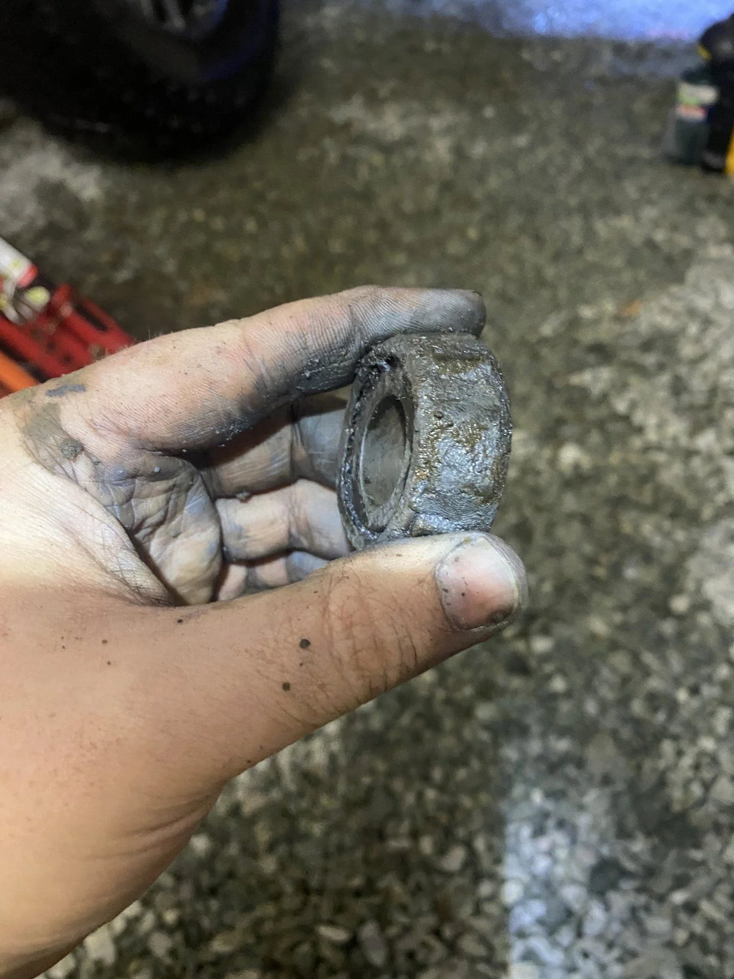

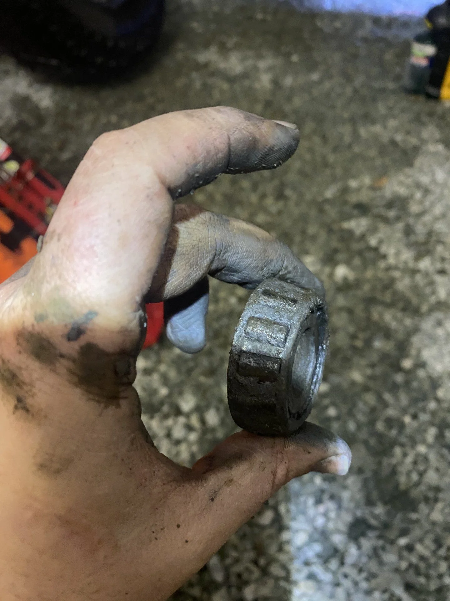

Well I need a rebuild ASAP. Also I need bearing part number desperately. I found number for the seal. But can’t find crap on the bearing.
My friend is a mechanic and when I need a bearing I do not know what it is he just measures it and ordered one from a place like napa or some auto shop. I have had to do this with some military trailers. The one on the other side is likely in fair enough shap to measure it. or you can measure the bolt and the race.

Thanks, I'm hoping I can go to napa and match it up somehow!
Bearings and races usually have a part number on them. It may be obscured by the old grease and grunge. I'd clean it up with parts cleaner, brakleen, whatever solvent you have handy
There is nothing I’ve used my magnifying glass. They must me worn off
The bearings are available via ARB fwiw. We stock the bearing/seals as spares for the bumpers we sell.
I’m going to try a Napa tomorrow hopefully they can help. This was supposed to be a quick project. But that went out the window real quick. 😂
