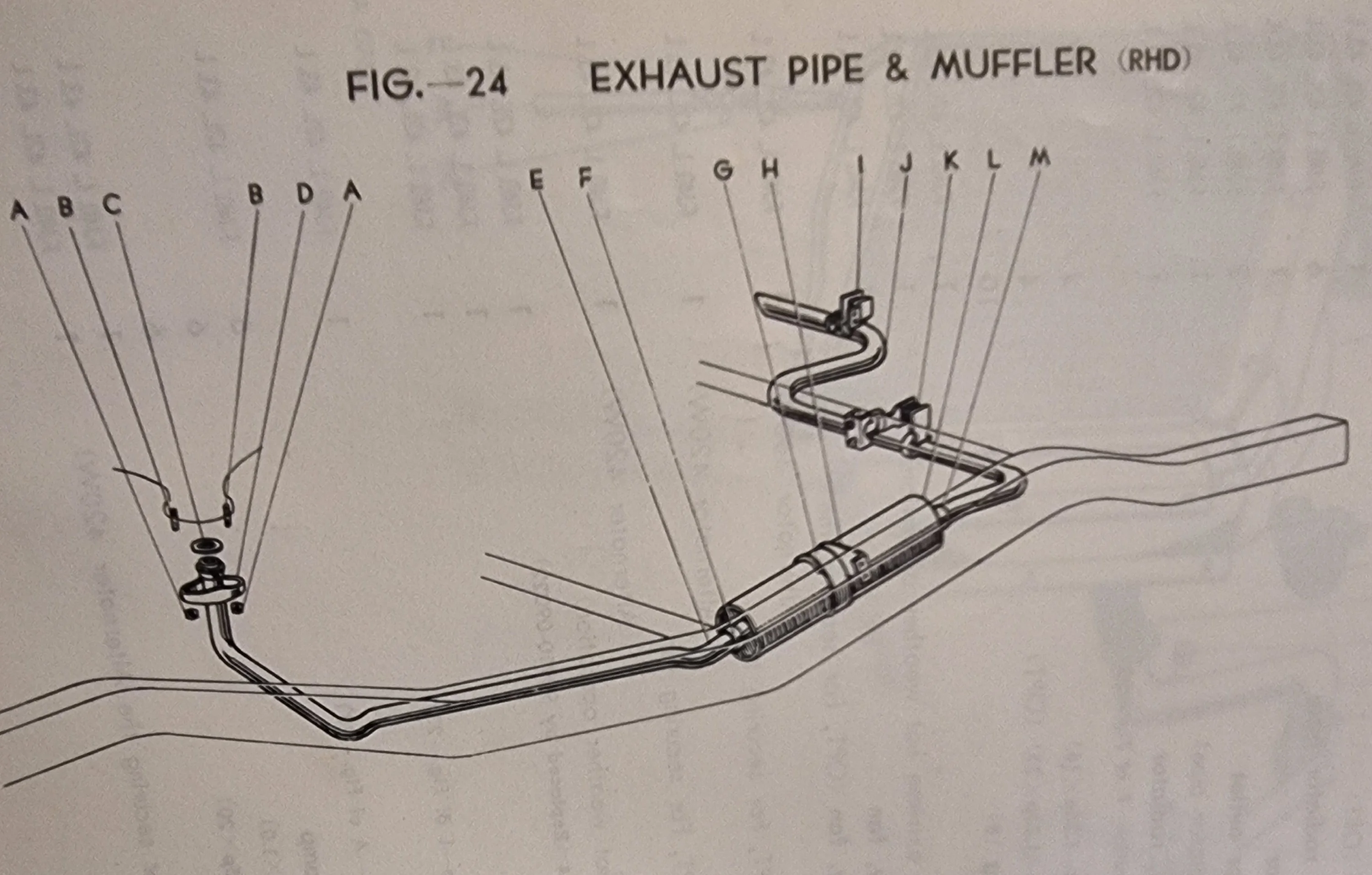

My parts Manual shows rhs exit
Thanks. Very interesting, nevertheless, if it matches the manual that is spec. My early 70's ones also exit RHS on mostly stock exhaust with the correlating brackets in place. Might be that the FST vs hardtop accounts for the difference since my '65 manual shows LHS exit on a RHD hard top -
I wonder if it was changed from the early ribbed Hardtops to late 1964? ( which is mine - Engine # etc / Vin early Jan 1965)
Aah, ok. Thanks so much! Mine is early according to the catalog (early '64 production) and the routing you show is exactly how my '72 with intact exhaust is routed. I have now had to change some basic bits to close holes, hoping the Heritage stuff comes through.
To mix it up further, my early '72 43 routes to the left side also. Toyota is keeping us on our toes.

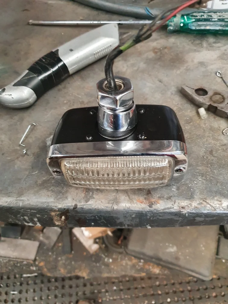

ANDY ,
will you please post any related tech pics and info in your VADER light in my NEW VADER LAMP and its related pull switches TECH thread please .......
my new ANYTHING Vader Lights tech thread would not be the same without your valued input and above photos Sir ...... :cool: 🍻

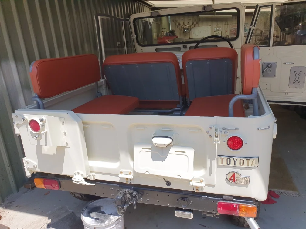

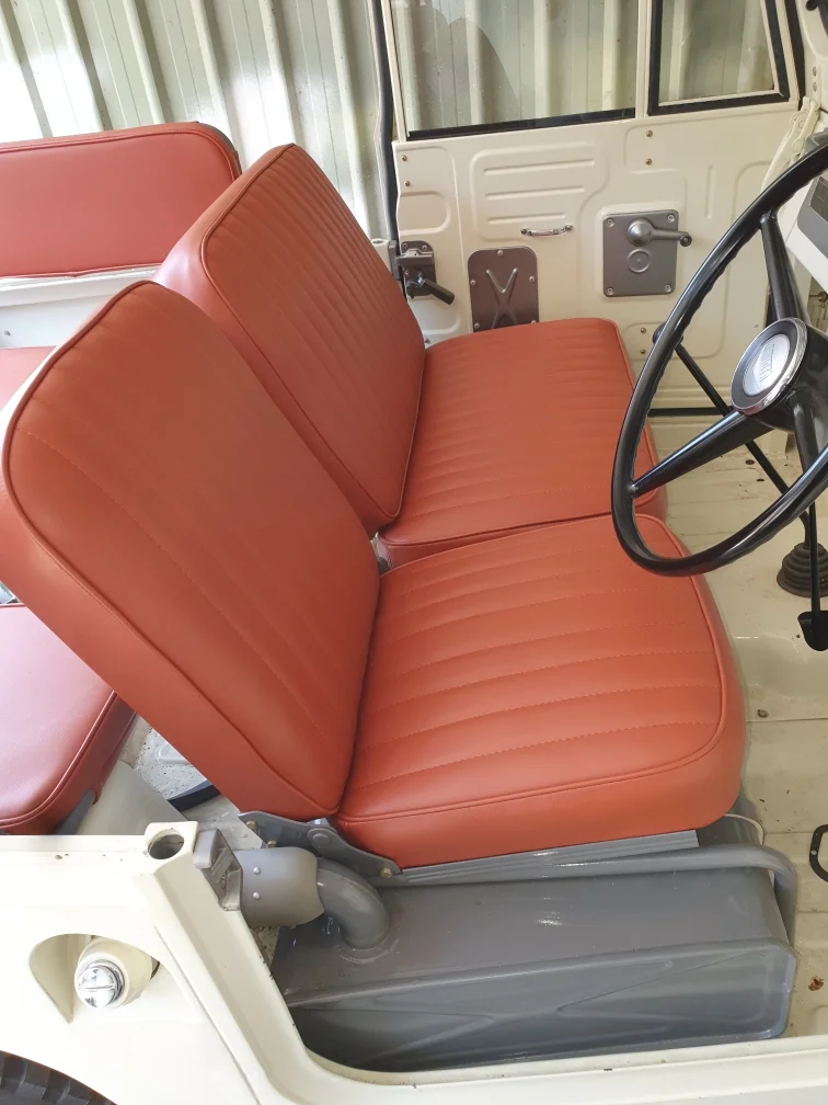

I want that bench seat! :D

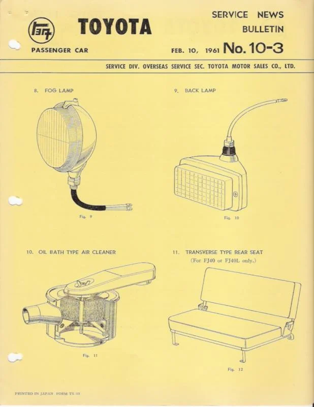

As for the reverse lamp I think I had seen it mounted under the rear rail
If I remember I’ll check some pics to see… I’ll post up if I find anything

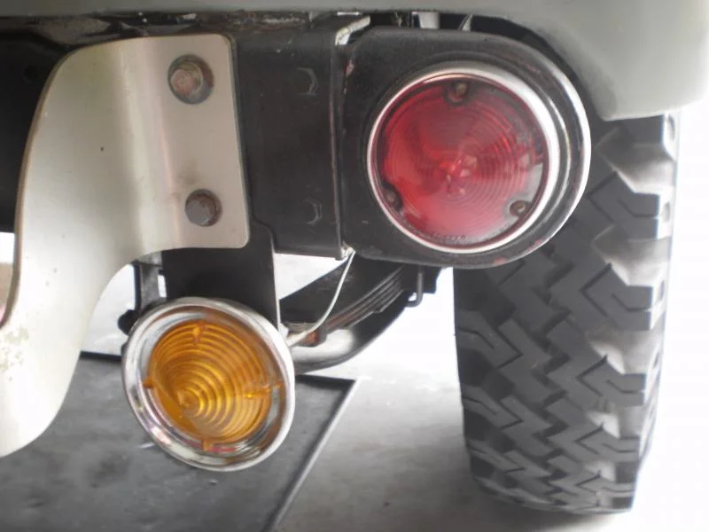

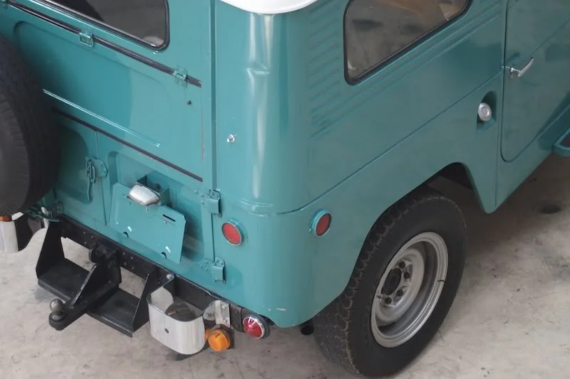

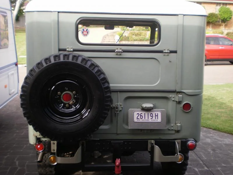

here are the aux lights and how they typically mounted them... the amber were all aussie trucks... the fj21 was japan and aussie
the fj21 shows the reverse light that was used prior to the oval that you have
just a simple bracket or mount directly to the rear rail
