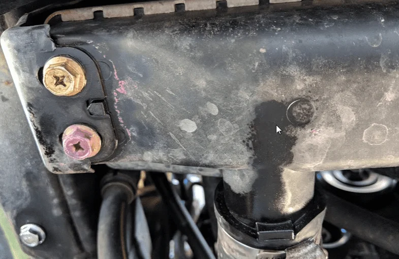

Yes, they all come from the gasket seals where plastic meets aluminum fins.
Geeeze that really sucks. I did buy a denso radiator as it was listed as an OEM replacement. It is leaking from the EXACT spot as savirc’s pictures.
I am going to look at it a little more to see if i can pinpoint it but it does appear to be near where the plastic tank meets the fins on the bottom.

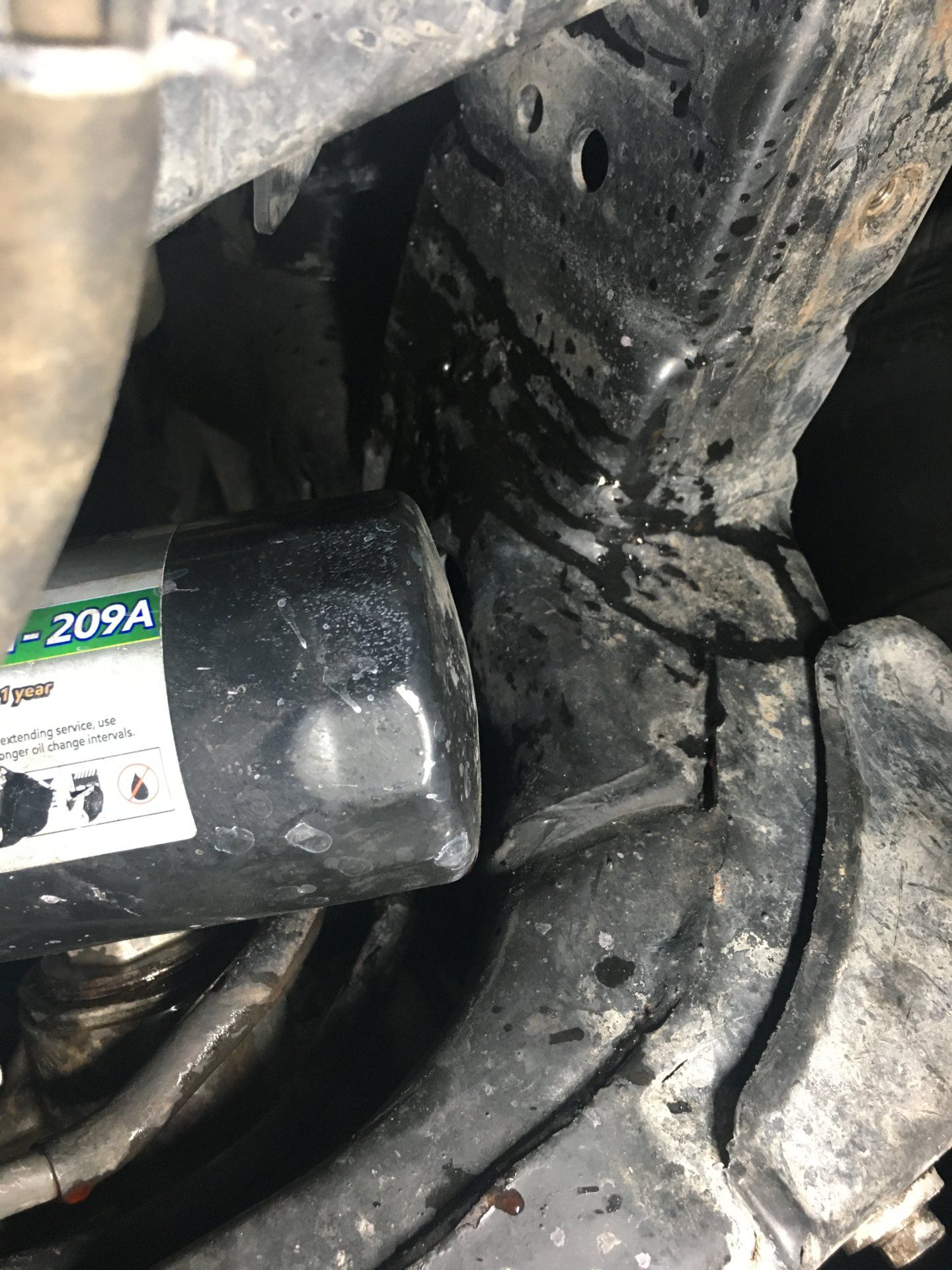

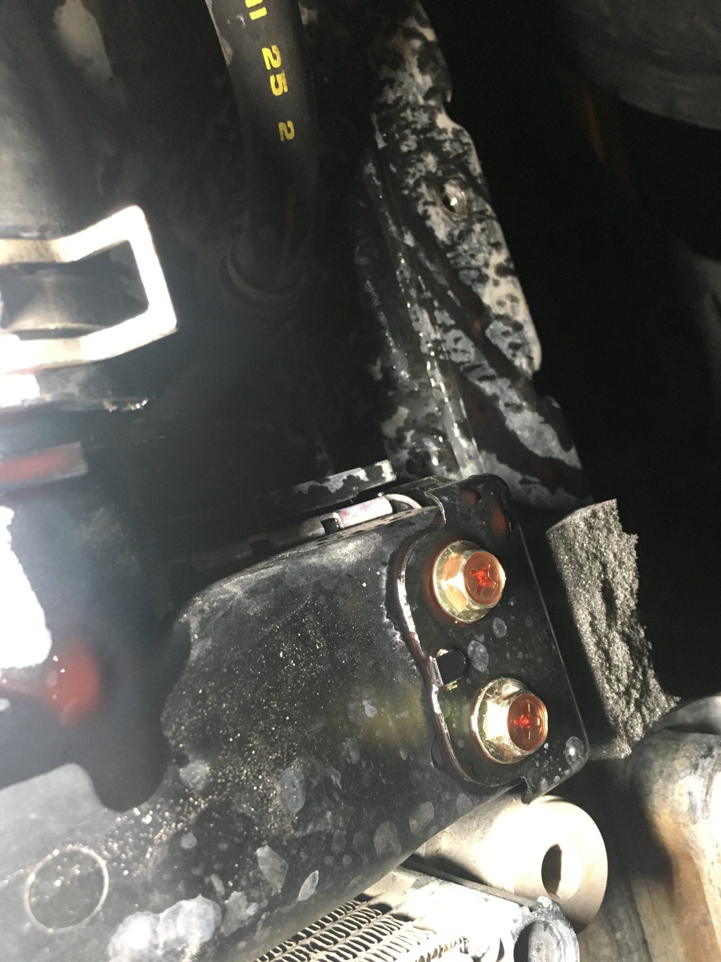

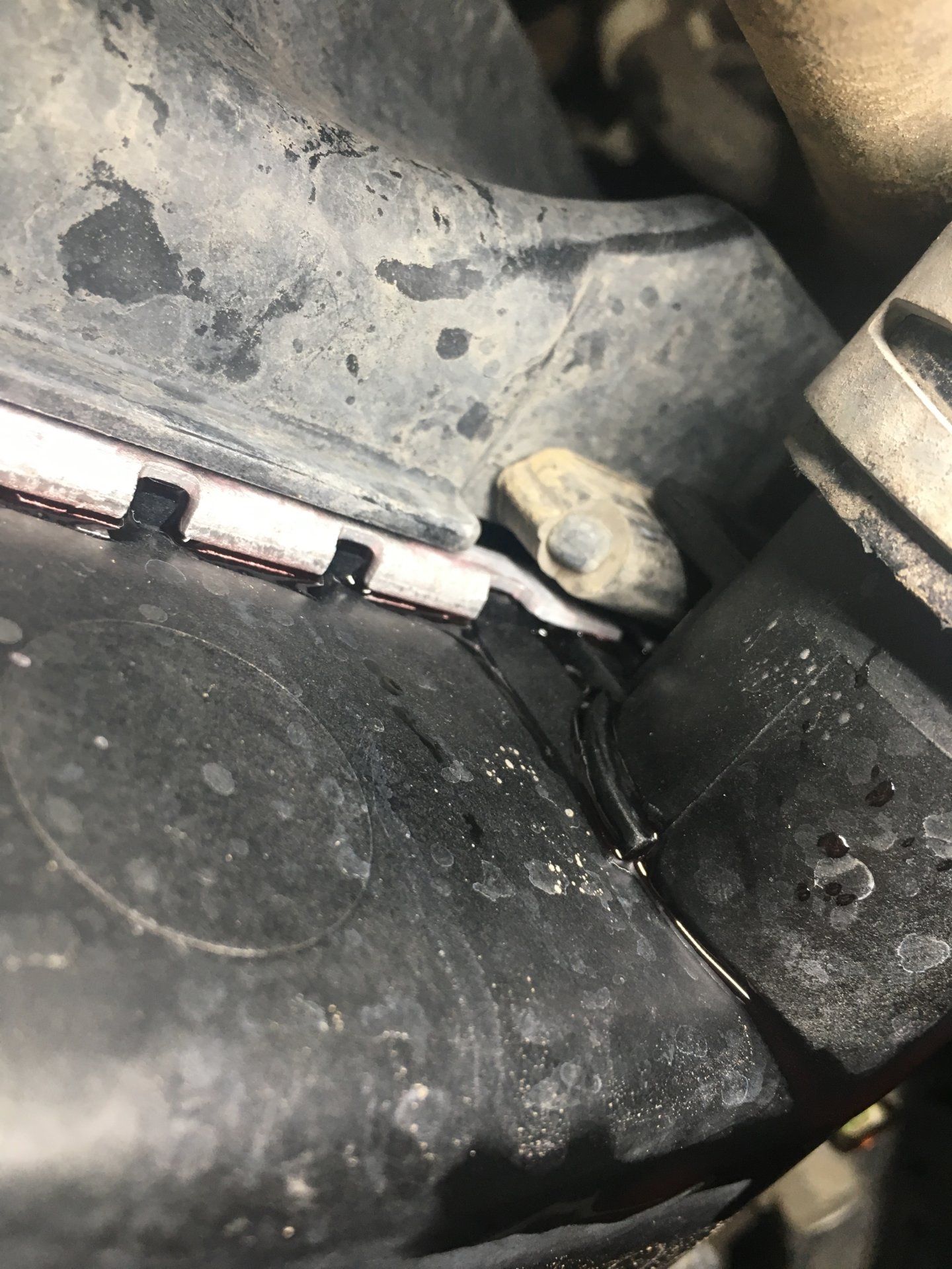

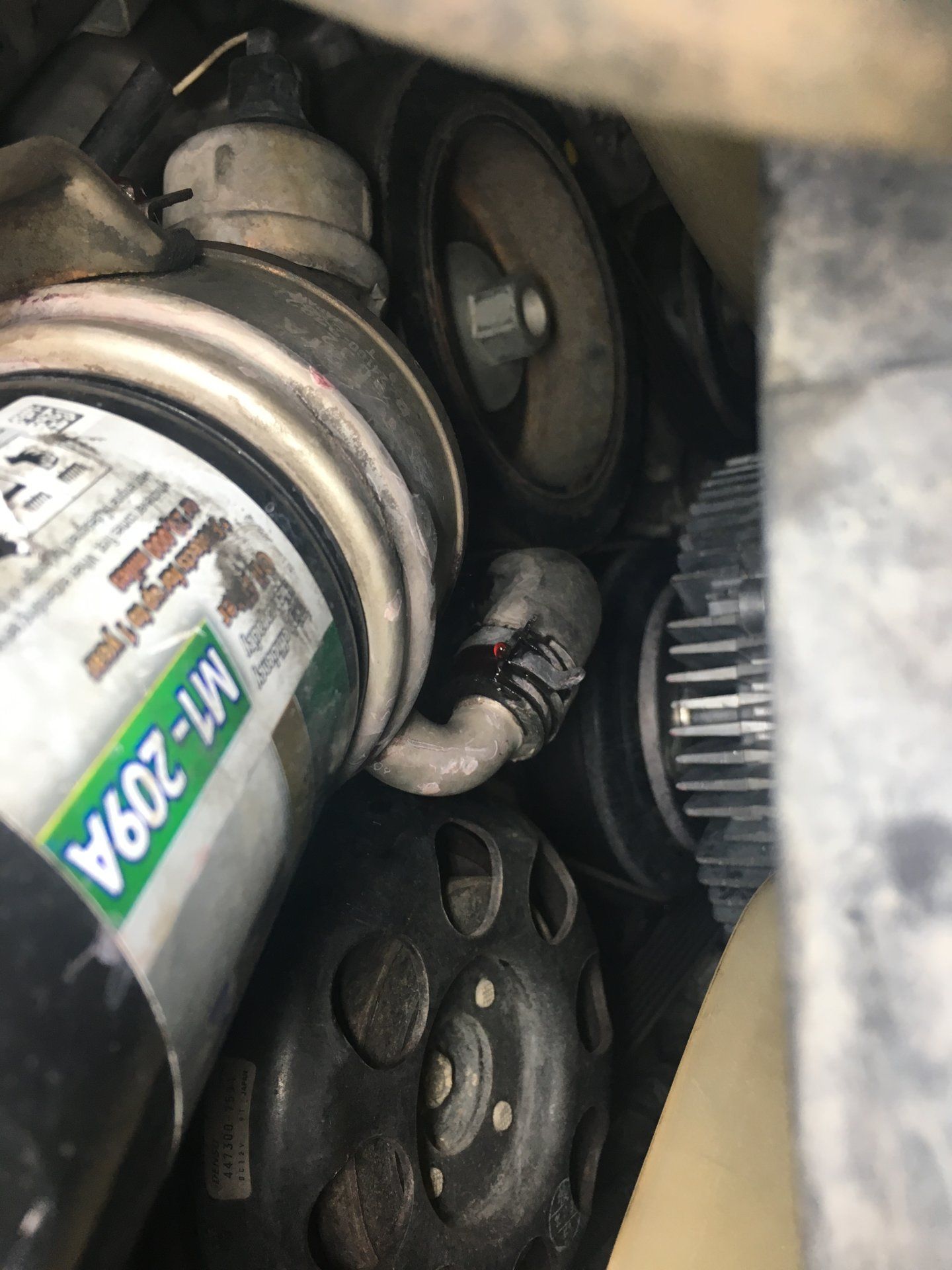

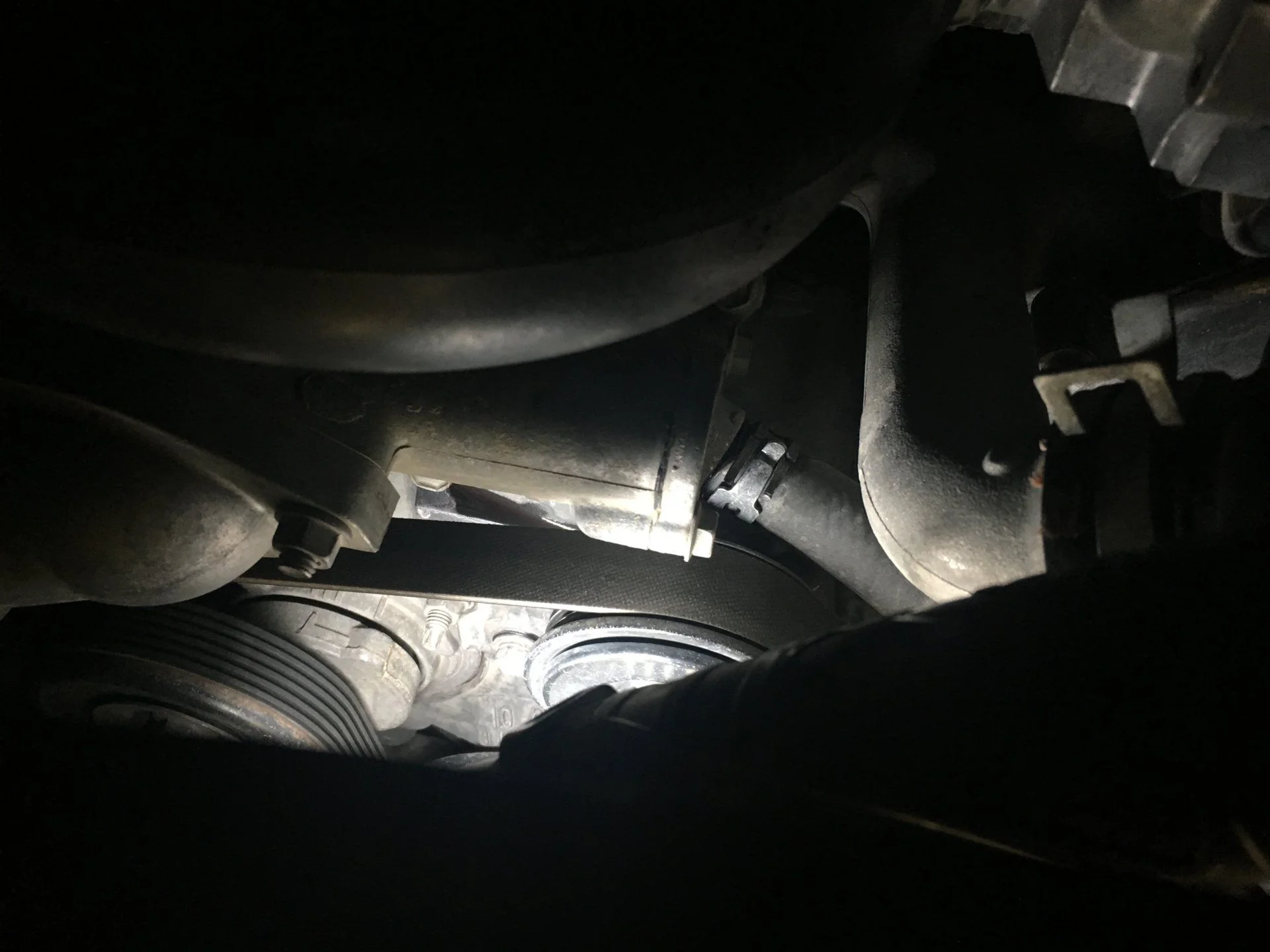

Hey everyone,
I got home and go underneath the truck and confirmed it is leaking underneath fins between the tank on the passenger’s side. (See pics)
However, i also appear to have some dripping on the driver’s side above the oil filter somewhere that wasn’t dripping before. The hoses appear to be clamped well, not sure where it could be leaking from? Bad gasket? Cracked line?
I guess I am trying to diagnose the leak(s) to verify that the radiator is in fact faulty before I replace. My concern is that the leak from the first radiator is very similar to the second, so an existing leak is not out of the question.
Any input is greatly appreciated!

When the radiator is leaking the fan throws coolant all over, making it look like other things are leaking. Trust me it's the radiator. Especially if you didn't have a leak before the install. There is no coolant line going to the oil filter. Only transmission oil lines go to the radiator.
