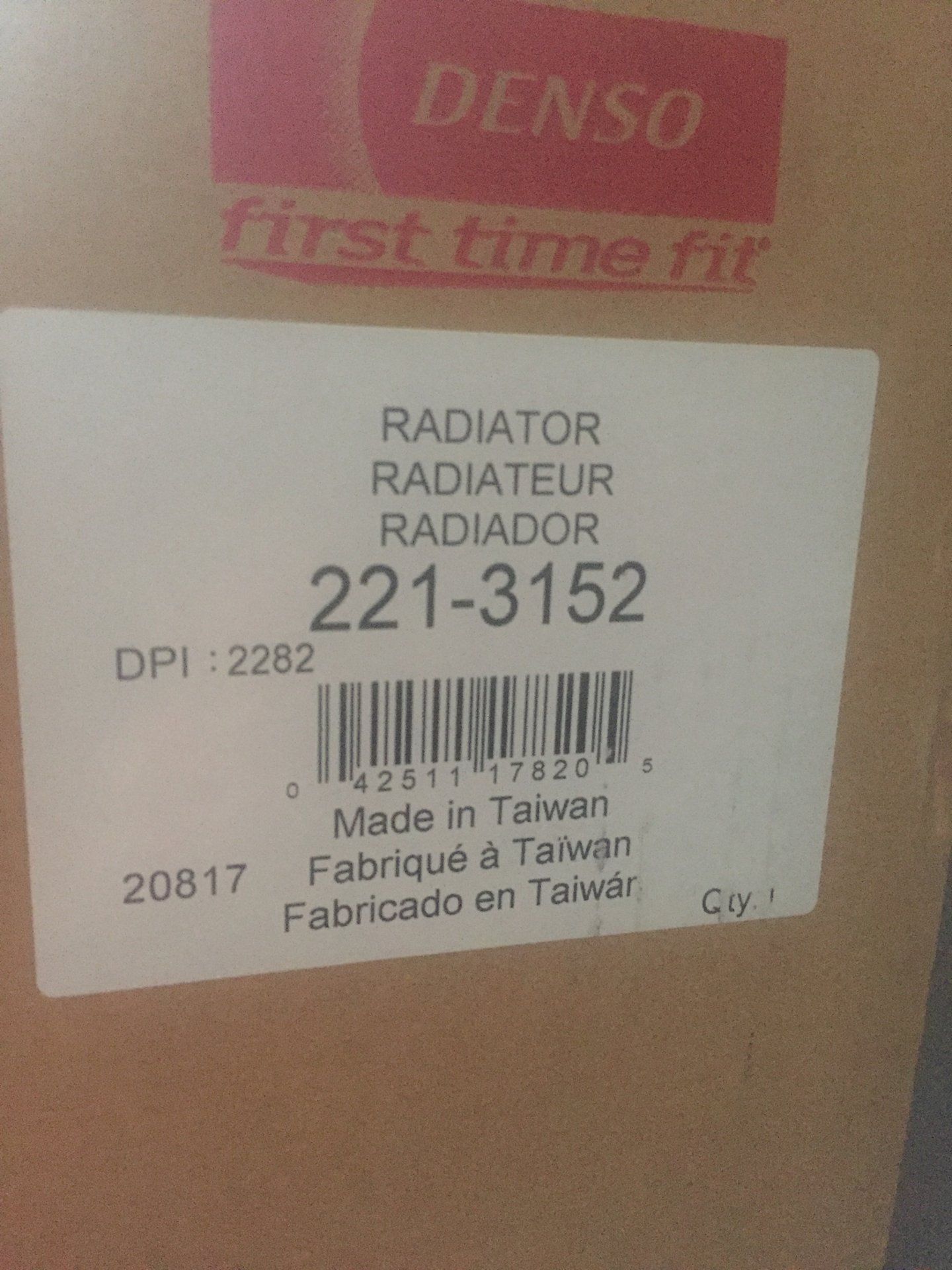

I tend to agree and the problem I see is after being out of stock for months, that probably zero’d inventory in the field. Then backfilling warehouses with new inventory with possibly affected product. 3 cases dont make trend, but I did read on a Lexus forum(not 470s) of some people experiencing Denso failure at the 14month range- leaking at the same place as your fail point. @savirc did you happen to snap a pic of the bar code and production date on the box you received?
Fwiw-Purchased through Rockauto
Date? 20817
