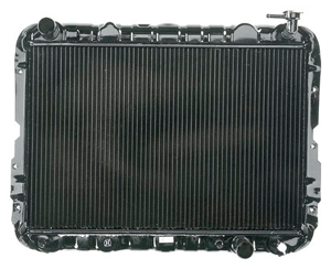

Radiator choices other than CSF
I'd certainly pony up for OEM, but I'm very leery of having radiators shipped, particularly from half-way around the world. I gave up on mail-order radiators because they almost always arrive damaged, particularly the large metal ones. Every one I've ordered has had the fill-neck bent or fin damage, even with double-boxing.
So I usually just try to order from local pickup so I can inspect at purchase. I end up paying more, but far less aggravation.
I bought the champion off amazon. Showed up in good condition. Not a direct bolt up.
One of the bracket studs broke off when i was tightening it, they sent me a replacement the same day. That was a couple weeks ago and i have not put it in yet.
Partsouq shows 2 radiator options for FJ60: 1640061050 for 2f FJ60 USA, and the 1640061051 2f FJ60
both are NLA. So where does the 16400-61090 come from? what vehicle is it supposed to go in? How does it differ from a stock FJ60 radiator? Is it plug and play? As in fan shoud lines up, mounting lines up? same volume? what cap? @mattressking
The Toyota radiators nowadays aren't any better than the CSF. Maybe worse. They're not built like they were 30 years ago. All the metal is thinner. I wouldn't be surprised if they were both made at the same factory (in Thailand). The CSF looks exactly the same visually in every detail to the Toyota radiator. That would be pretty impossible to accomplish by a third party manufacturer.
I had a friend who had to replace 2 new genuine Toyota FJ62 radiators because both of them had pinhole leaks oozing coolant immediately after installing. His third install worked- no leaks.

If you really want a HD old-school 4 core radiator, I'd look into having one made. Particularly if you've got one for them to use as a pattern.... It's done all the time for classic vehicles and there's prolly a shop in every large city that does it.
You might call Sonny at fjparts.com and ask him what brand Radiator this is... I'd like to know also.

I bought a Champion for my 60 three years ago. No problems so far. I just recently placed a ground strap on it to keep demons of corrosion at bay.
Do you recall what bolts needed to be modified or changed for mounting?
