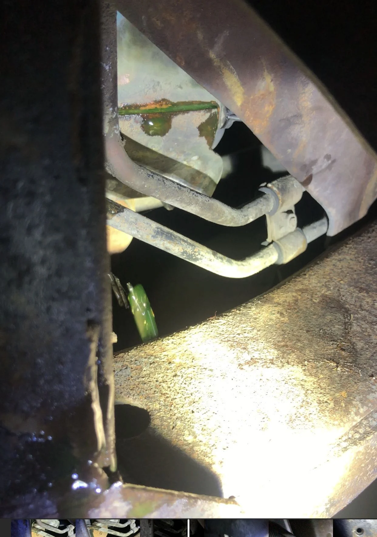

I purchased a CSF 2708 from amazon in 6/16. It didn’t age well. All the paint came off in the first year and it looks really rough. The other day it started leaking from the seam on the bottom. 40,000 miles later it’s done for.
I’m really disappointed in the product. I’ve decided not to get it repaired at this point. A $300 product shouldn’t be this terrible
