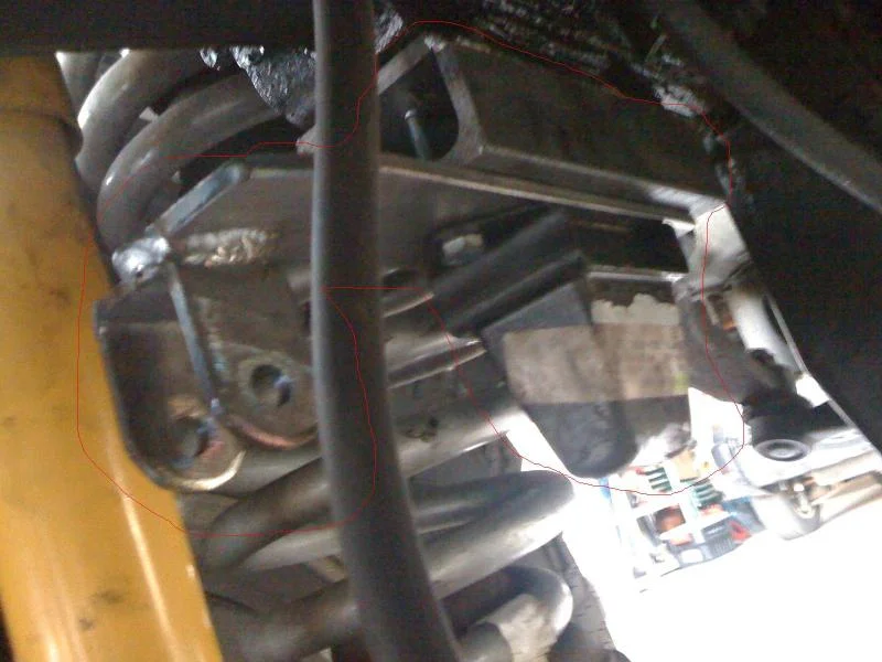

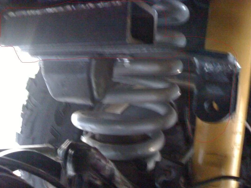

Prototype pictures
First, I would like to give credit to all the people that tackle this issue before me. They inspired me to get into this issue. It should have been in my first post.
My prototype worked last night. But it is still a bracket, not a product.
The bracket has to answer another issue which I neglected to mentioned before as a design goal, and that is the bump stop.
The 1993 80 came with a bump stops that were between the frame and the axle. Subsequent years eliminated these bump stops but the location and the capture nuts are still there.
My bracket is designed to do two things, first a place to hang the disconnected swaybar, second it will be a dropped base for the 1993 bump stop.
On a 4" lift, the bracket will give you a 3" drop base. I would like to include the bump stops as part of the package instead of individually calling cruiserdan. I don't know what it will do to the price but it will be a more complete solution, which is what I am after.
Please note that the bracket will NOT look like the prototype in the pictures. The first proto is made of two pieces and I had to use 70mm M8 bolts. The second prototype will be one piece and be like H on its side. It will use 20mm M8 on the frame side and 20mm M8 bolts on the bump stop side.

MaddBaggins has the cats meow set up... His set up is what i was refering to, but just couldn't remember. Nicely done Baggins... Looks like you are making progress Rhyary but it also looks pretty complicated... Are you worried about adding so much extra material the sway bar will be impeding flex while disconnected???? I want to see your finished result and what the tests results are.

tlc81,
"Are you worried about adding so much extra material the sway bar will be impeding flex while disconnected????"
No. I tested that extensively. I climbed over a 22" wall with one wheel. The swaybar was securely fixed to the bracket. There was NO tension on the swaybar at all. It was nice and secured not getting close to the lower control arm, drive shaft or any other items.
The sway bar must be secured to avoid falling down and digging the edges into incoming obstacles.
The pictures show a complicated prototype as I was using it as "modular" building blocks. My next proto will be one "easy" bracket.
I am taking the setup to Rauch Creek on April 3rd for the FJ Cruiser event to test the whole thing wheeling. However, as smarter people here already figured that a front disconnected swaybar is beneficial. The only reason not to do it when wheeling is because it was not easy to do.
About driving with out the sway bar on the roads at speeds. Don't do it. You can't test a swaybar going straight on the road. If you go 70mph and you have to switch lanes in emergency maneuver, say first left lane and immediately right, is how you test you swaybar. As IdahoDag said, you go swing back and forth a top heave, lifted 80 and you are going to flip it.

More design changes.
After playing with the original bracket and the second prototype concept it went into the metal shop with the following:
The inverted U is going forward 1"
The proto bracket will have 1" square in the middle holding the two plates together. This might end up being two squares or one 1" W x3" L" X 1.5" H
The two plated (think H on its side) will be 3/8 thick.
The bottom plate where the inverter U mounts will have two capture nuts on the inside. This will make mounting the bump stop really easy.
The 1.5" hight will be enough to put a 20mm M8 bolt when mounting to the frame.
I hope to get it today and give it a try. If it works, will give it some paint and will post pictures.
I am starting to think it is going to be a lot nicer than I imagined. I can't wait to pick it up.
