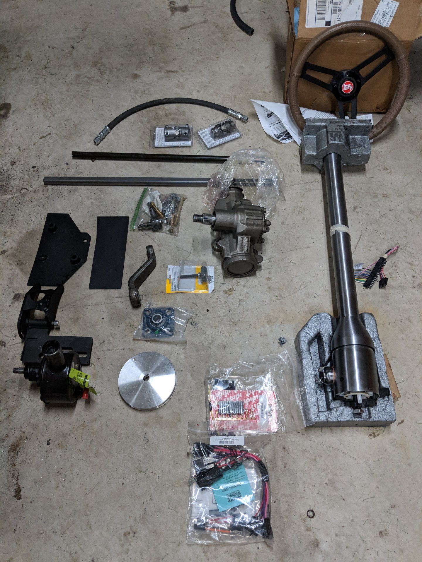

Would anyone be willing to lend their expertise and experience with a Saginaw based power steering conversion? I purchased a kit from Cruiser Solutions a few months back and am trying to figure out how the heck it is going to work on my 68 FJ40.
1. Does this look "complete"?
full
Keep looking at the parts and then at my 40 and keep thinking that something is missing between the column and the box. But they shipped me the Borgstein shaft, so???
full
2. How in the blazes does one remove the OE column?
I am totally new to steering components, so any assistance would be helpful. :)
Nope, Borgeson shaft and joints will connect the column and gear box.

Is the steering wheel adapter already mounted to the steering wheel? If not it may be missing. If you don't weld then you need additional help. I also find it strange that they didn't provide an installation manual which would tell you what you need to know during the install.
(1) I don't see a slip yoke feature built into the steering drive shaft and lower universal joint. When "wheeling" frame flex causes the length of steering drive shaft to move/change 3/8" in length (we've tested this). Normally your lower universal joint would set screw onto the gear box, then it's back side would be free to travel on the splined or DD steering drive shaft (greased with a boot).
(2) Not sure what the big aluminum block is on the engine compartment side of the steering column they supplied is?? Also, your 1968 would normally not use the blue 4 bolt bearing block they supplied. Read their instruction sheet to see how they want you to make the firewall attachment?? If they did not supply an installation instruction sheet (unimaginable), get mine.

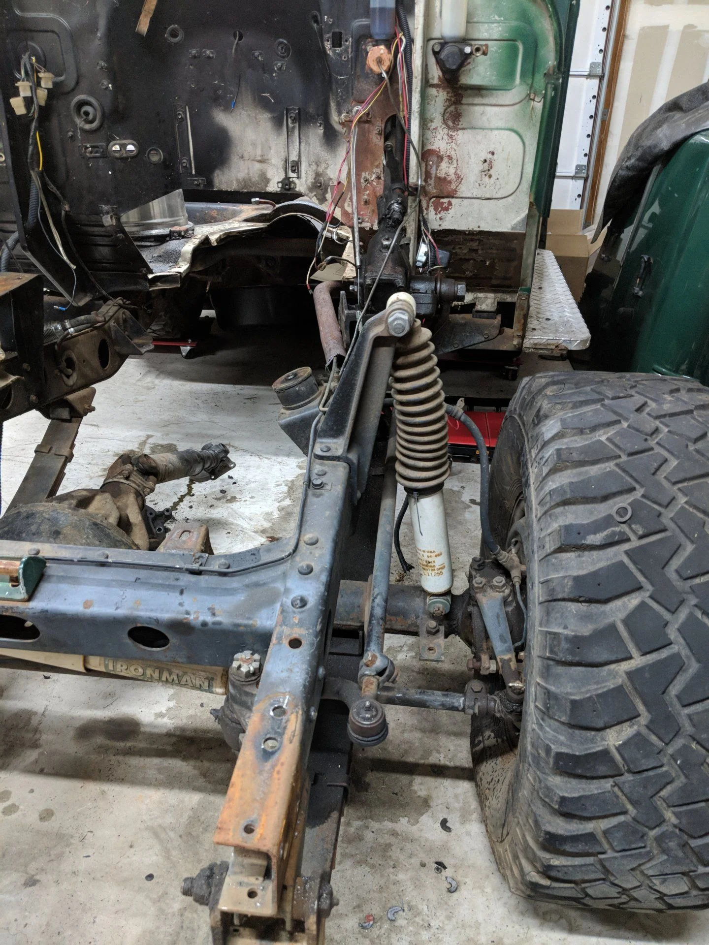

BTW Tony, get those boots off those shocks. Shock boots fill full of water (through top breather holes), then water can not escape, sooooo the water sits there rusting your shock shafts. Then rusty shafts moving through the shock oil seals wipes-out the seals, then you have a leaker.
Will do! They are OLD Ironman shocks from a PO. They will go in the scrap pile as I continue the teardown process.
