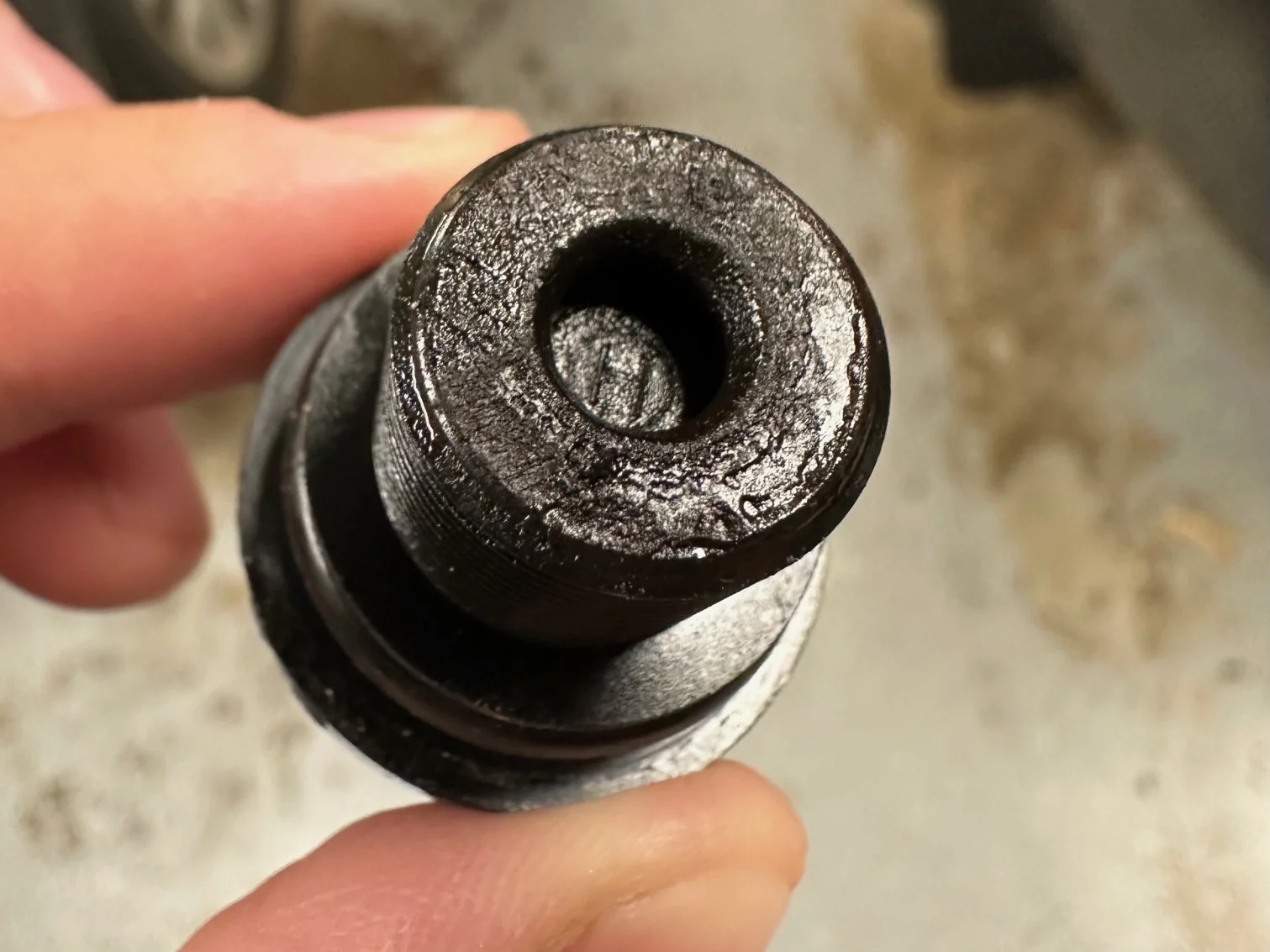

I replaced mine at 80k. It was still working but it's so cheap and easy to replace so why not? Someone in another thread said it takes 10 minutes to replace. I think they must have had one hand tied behind their back because 3 minutes is plenty of time! Mine had some gunky buildup on it but still had a nice click when I shook it.
